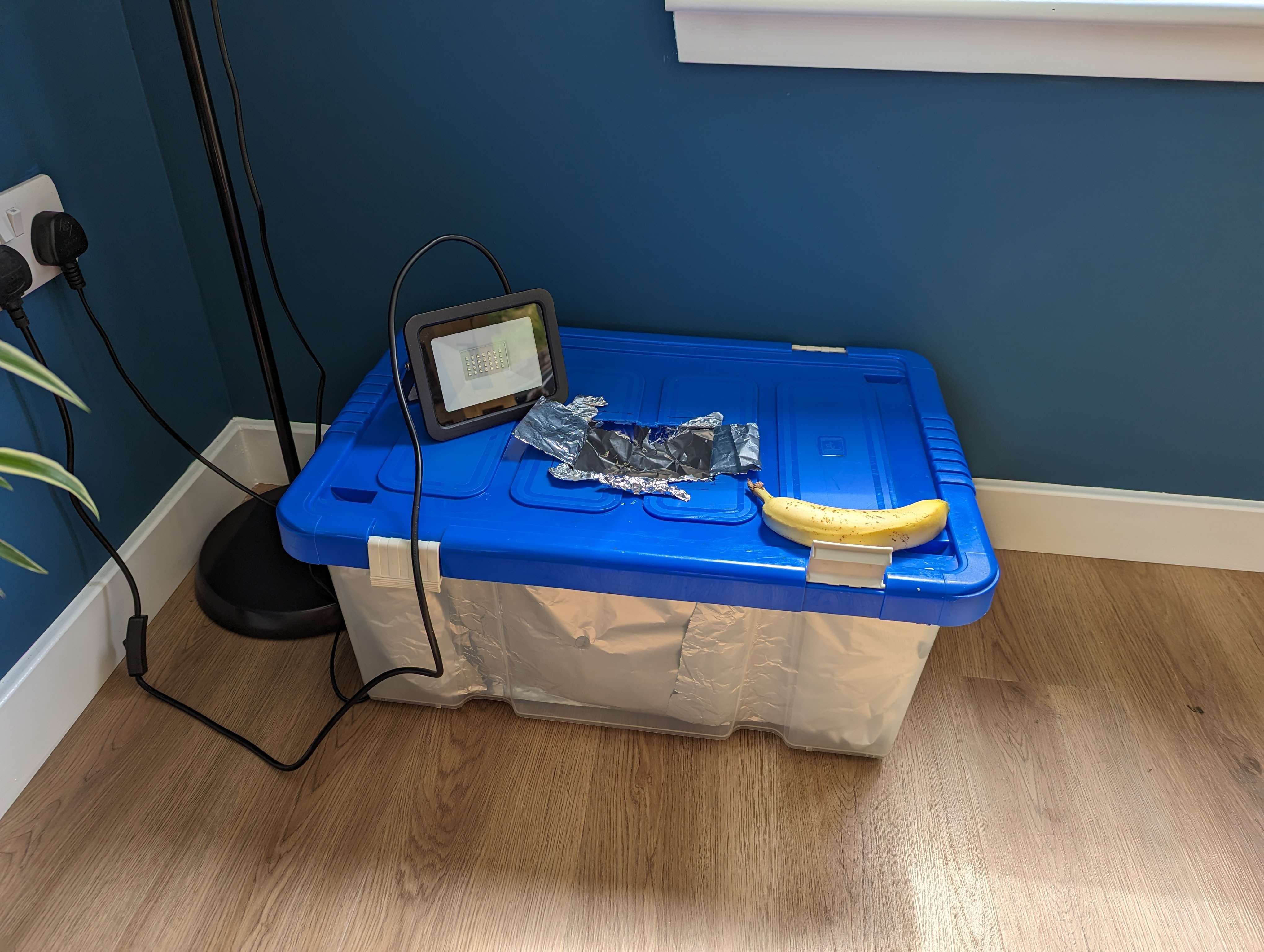

Numaticjoe_1 wrote: 10 Jul 2023, 00:50 I'm in the uk so with hight uv and 20 degrees c it took around 4 ish hours I'd say.
haha, i could never as a scotland resident :lol: . I've got an underbed box which I've lined with tinfoil, and i cut a hole in the lid big enough to shine a UV lamp into. funnily enough, the heat the UV lamp generates also heats the box, so it's really a two in one!
majestic contraption pictured below:

podgen wrote: 11 Jul 2023, 14:34
I thought about building one myself as it tends to get it done a lot quicker.
How much did yours cost?

Numaticjoe_1 wrote: 14 Jul 2023, 20:23
I can't really remember sorry, but i think it was around £25 for the uv lamp, and the box i used had been lying around for like a decade - the price label on it says £12.99 though. tinfoil expense considered, I'd say maybe budget £40-50
