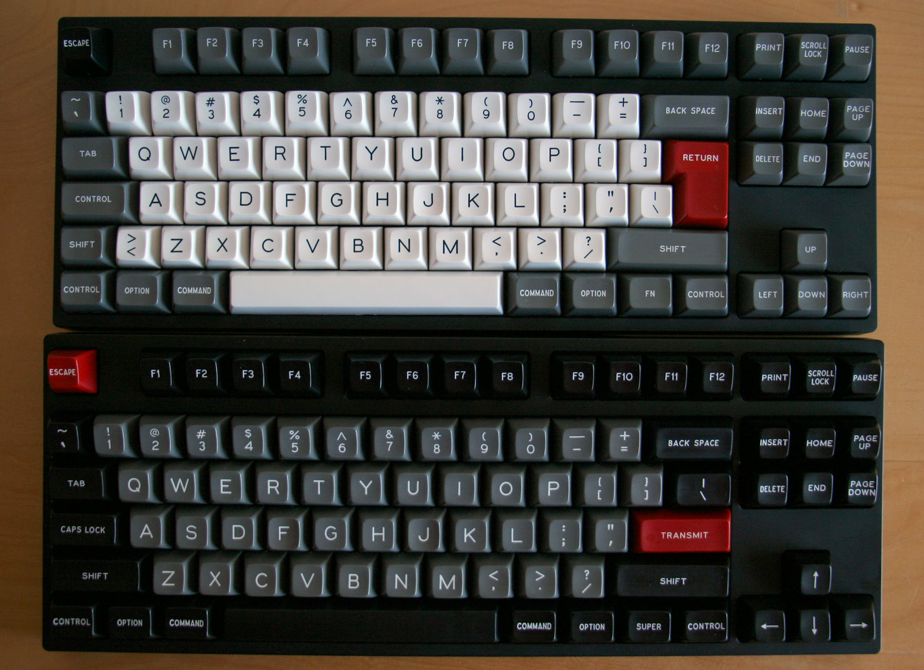

I do still have mine, having sold phinix the ISO one of these two long ago:
Damping rings are the key. Once you’ve sorted that, they’re a decent enough, low-key showcase for MX mount caps. Much prefer mine to MX keyboards for that purpose.

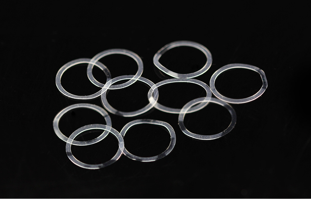

Muirium wrote: 10 Aug 2023, 09:55 Damping rings are the key. Once you’ve sorted that, they’re a decent enough, low-key showcase for MX mount caps. Much prefer mine to MX keyboards for that purpose.
Those dampening rings look so thick though, despite being foam, doesnt it massively mess up the keyfeel?
10 Aug 2023, 11:23
Nope. They don’t spoil anything at all. Quite the opposite for the clunky Novatouch! I put Hypershere’s rings into my Realforce and second HHKB, I like them so much. Compared to my stock HHKB Type-S, they’re just as good as Topre’s own factory damping, to which I’m so deeply used to in my main keyboard since 2014.
If you’re thinking O-ring thick, think again.
Aruberon
10 Aug 2023, 12:08
Fair, my only point of reference is these:
Which are ultra thin rubber ones, keyfeel is more or less identical to stock, but with the desired dampened sound, I enjoyed them, they went into both the Novatouch and Realforce sa0100, overall both boards feel more or less identical before and after this mod though.
Cant comment on HHKB, I am yet to join the cult :roll:
10 Aug 2023, 12:35
Yeah, going by the pic, Hypersphere's are a bit thicker, but a matte black material instead. I still have a few spare, I should take some macro pics of them. Hypersphere tested a few different thicknesses with his supplier, and settled on 0.5 mm, going by my DT-search-fu. That sounds a bit thick, but doesn't feel it. I’m typing on my black HHKB just now, with them installed, and frequently swap to my white Type-S. The boards are strikingly differently weighted thanks to use, but the damping seems identical to me in person. Certainly a lot nicer than the ` key which I left undamped as a reminder. ;)
It's quite possible his rings—which are quite soft—get flattened with initial use. I remember them seeming a bit flatter than my spares when I pulled some from the Novatouch I sold Phinix, which I'd used lightly for a year or two. There may well be a an initial breaking in period.

For novatouch silencing opt for 0.3 mm rings, and you wont find a better deal than: https://unrealkeyboards.com/products/un ... cing-rings
$10 for 120 rings with $2.71 international shipping.
10 Aug 2023, 23:45
Yup, very good price if they work.
wobbled
11 Aug 2023, 00:17
Muirium wrote: 10 Aug 2023, 23:45 Yup, very good price if they work.
I exclusively use them now, made out of the same material as deskeys

wobbled wrote: 10 Aug 2023, 20:49 For novatouch silencing opt for 0.3 mm rings, and you wont find a better deal than: https://unrealkeyboards.com/products/un ... cing-rings
I ordered a set of these, just installed them and the difference is actually pretty insane. The board sounds and feels 100x better. If only there was a way to improve the spacebar rattle :lol:
