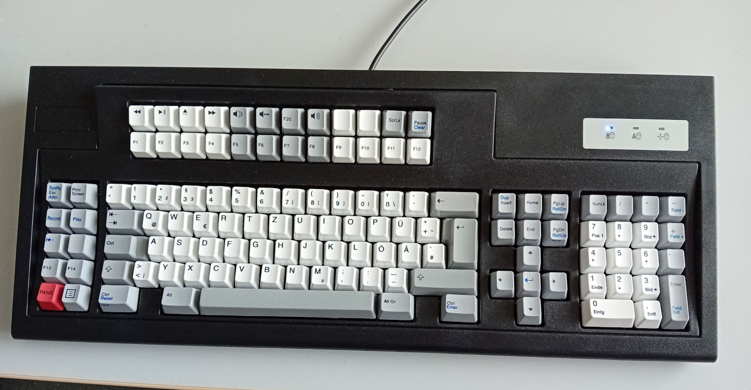

The keyboard looks much, much better than the tiny photos on the website suggest. Not sure my crappy phone camera can do it more justice (note that this is after switching out many of the keys and the LED overlay, the default is all gray keys and a black LED overlay):

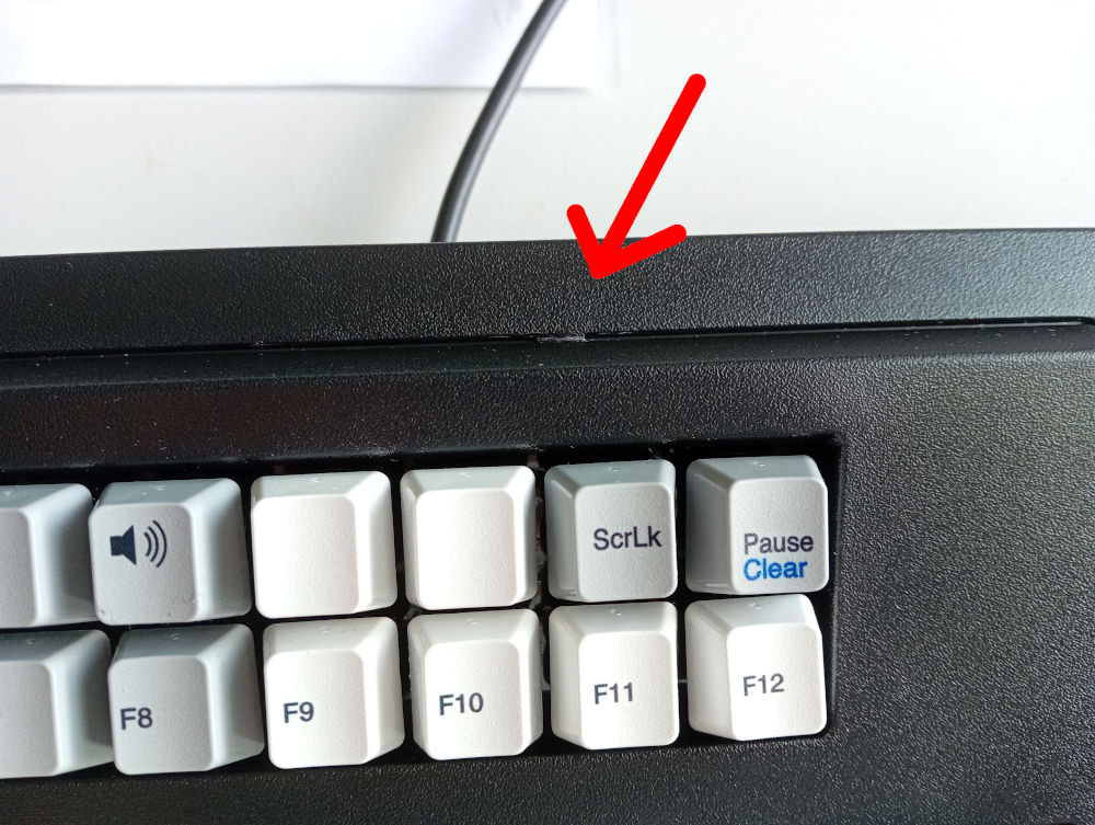

The weight is lower than the original IBM and the plastic feels cheaper. There is some creaking, especially when pressing on the sides. The texture is partially uneven. You can see on my photos that dust is easier to notice on the black chassis. There is one spot in the recess behind the function keys that is filled with a plastic blob, seems to be a clear manufacturing problem.
The New Model M (which I also ordered out of curiosity, but will probably sell again: not enough keys 🙂) is much better in that regard: It seems that the tooling for the 122 key models is still the old, worn one. That being said, I still think the keyboard looks good and will serve me well. The aesthetic blemishes don’t bother me, but they should be mentioned in a review and are noticeable.

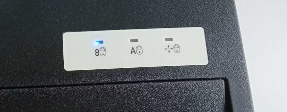

The indicator LEDs are blue, which is not super popular around here. I tend to agree. Yellow LEDs might have been quite nice and novel, perhaps. On my specific RP2040 controller, the blue lights are not blindingly bright and they happen to be offset a tiny bit from the intended positions. These things together make them the optimal brightness for me when they shine through the label, although I’m not sure this was intended or a happy accident.
If your LEDs are too bright, I would propose the quick fix of sticking a small piece of toilet paper or some similarly thin paper between the LEDs and the case to reduce brightness → easy fix IMHO, I did it for the New Model M.

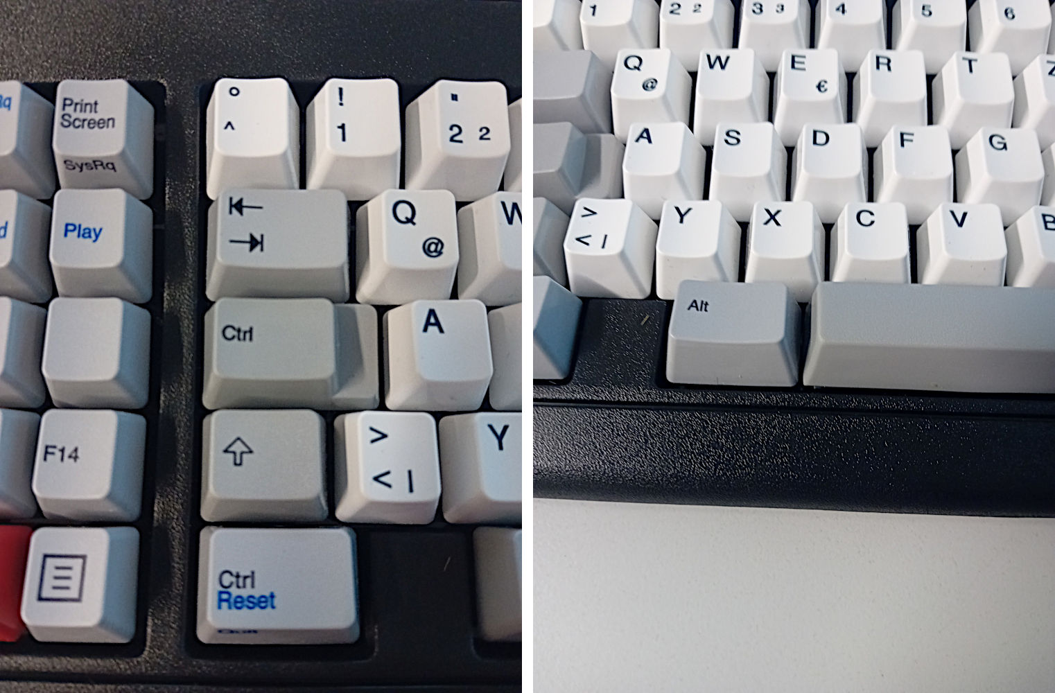

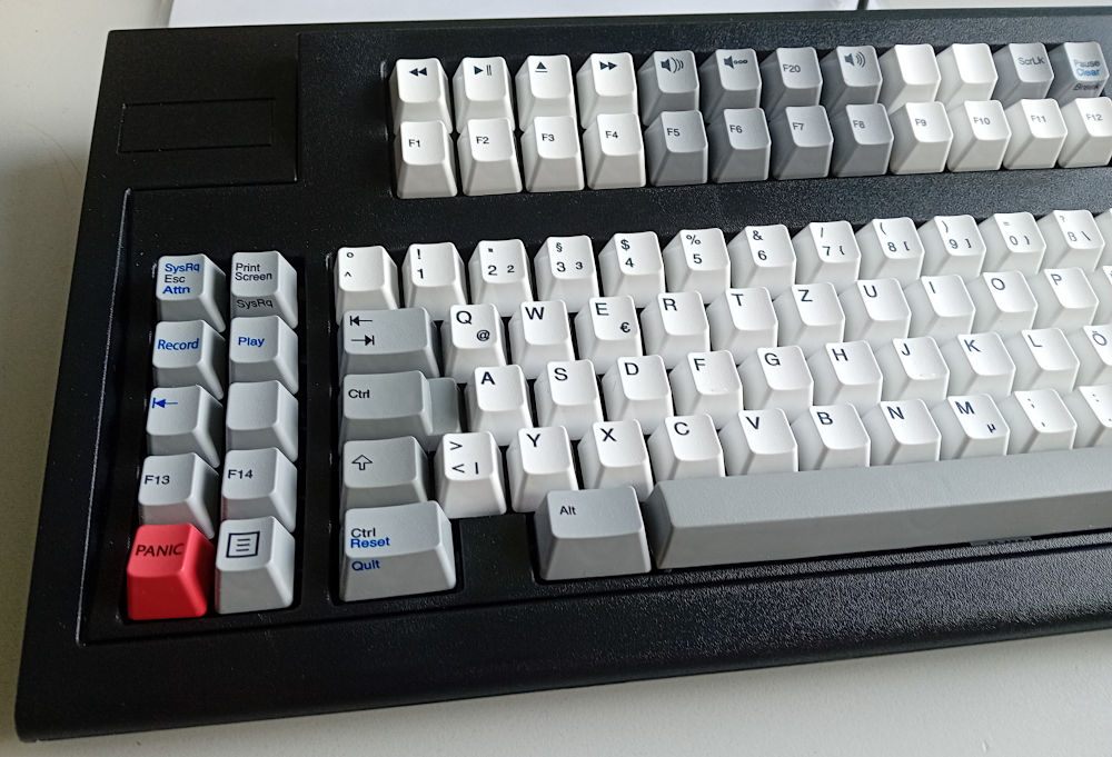

The keys look good. They nowadays use gray instead of pebble. This bothered me in the images, but is actually pretty good looking in reality. Tastes may vary and those nostalgic for IBM colors will be disappointed. There are some really minor alignment issues with the print for “special” keys, such as the “Menu” key. Some of the gray modifier keys have slightly different shades of gray. This is most notable for the “Ctrl” replacement for CapsLock, which—to be fair—is sold separately and might thus be from a different batch. There is some slight difference between Alt and the spacebar.
Again, I am a picky person and it doesn’t even bother me at all. The true perfectionist might be annoyed.
Note that the keys are single pieces without the detachable cap. As far as I know this is regarded as the better version. I tend to agree, but the comparison between my old two-piece IBM keys and my new single-piece Unicomp ones is not entirely fair due to possible wear.

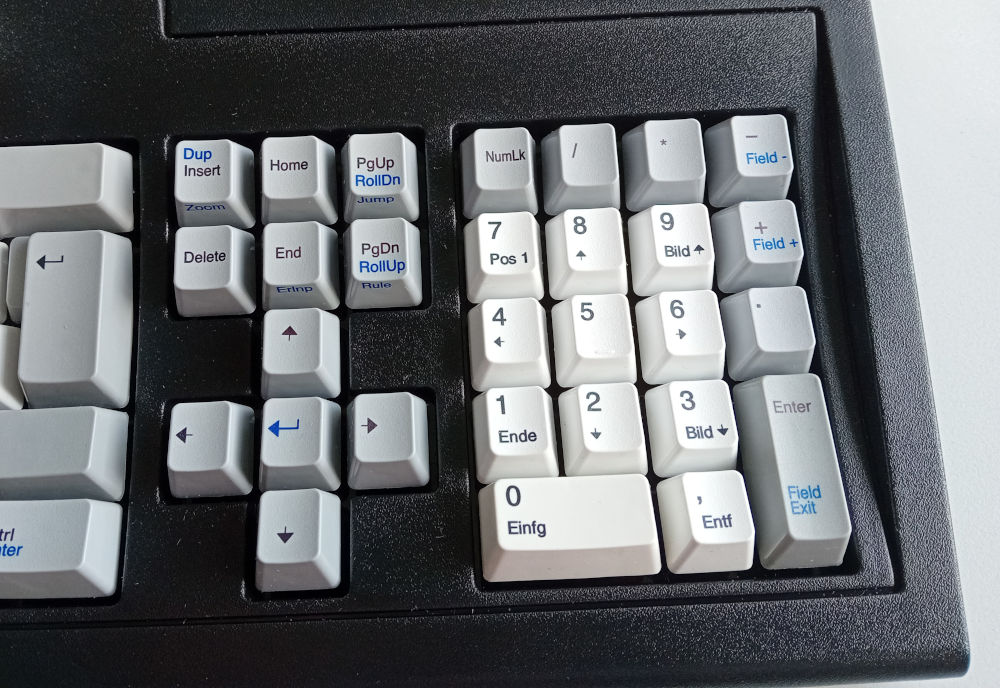

I got used extremely quickly to putting Esc to the left of the number row instead of above it. I am now convinced that it belongs there, much more comfortable to reach somehow. I understand the people who miss the block on the left. Linux GUIs nowadays use the Windows key (or “Super” key) a lot, but having it further to the left does not really bother me as much as I thought (it’s the red Panic key; the Windows logo looks ugly and I don’t like unrelated corporate branding on my keyboard, thanks). Willing to accept this for the Esc placement. The Record/play keys actually record keystrokes and play them back (dynamic macro in QMK). The menu key doubles as Fn when held instead of tapped. QMK rocks. The other left block keys were mapped in my OS’s keymap to several symbols I use regularly that are not easily accessible otherwise. I love the media keys at the top being actual buckling spring keys and not some cheap thing added as an afterthought.
I also enjoy having one more key on the numpad: I converted everything to standard layout and put a “.” key on the additional lower half of where the plus key would normally go. This is super useful on a German keyboard, where the default decimal separator is “,” because I can now type numbers both in US and German style based on current needs and what type of input is expected by the application/website. Makes me use the numpad more often, actually. The arrow cluster is of course less ergonomic than the inverted T, so I just made the middle key an additional "down" key. I had zero issues adjusting to that. The “Enter” symbol is there because it looks better than two down arrows, i.e., pure aesthetics.
