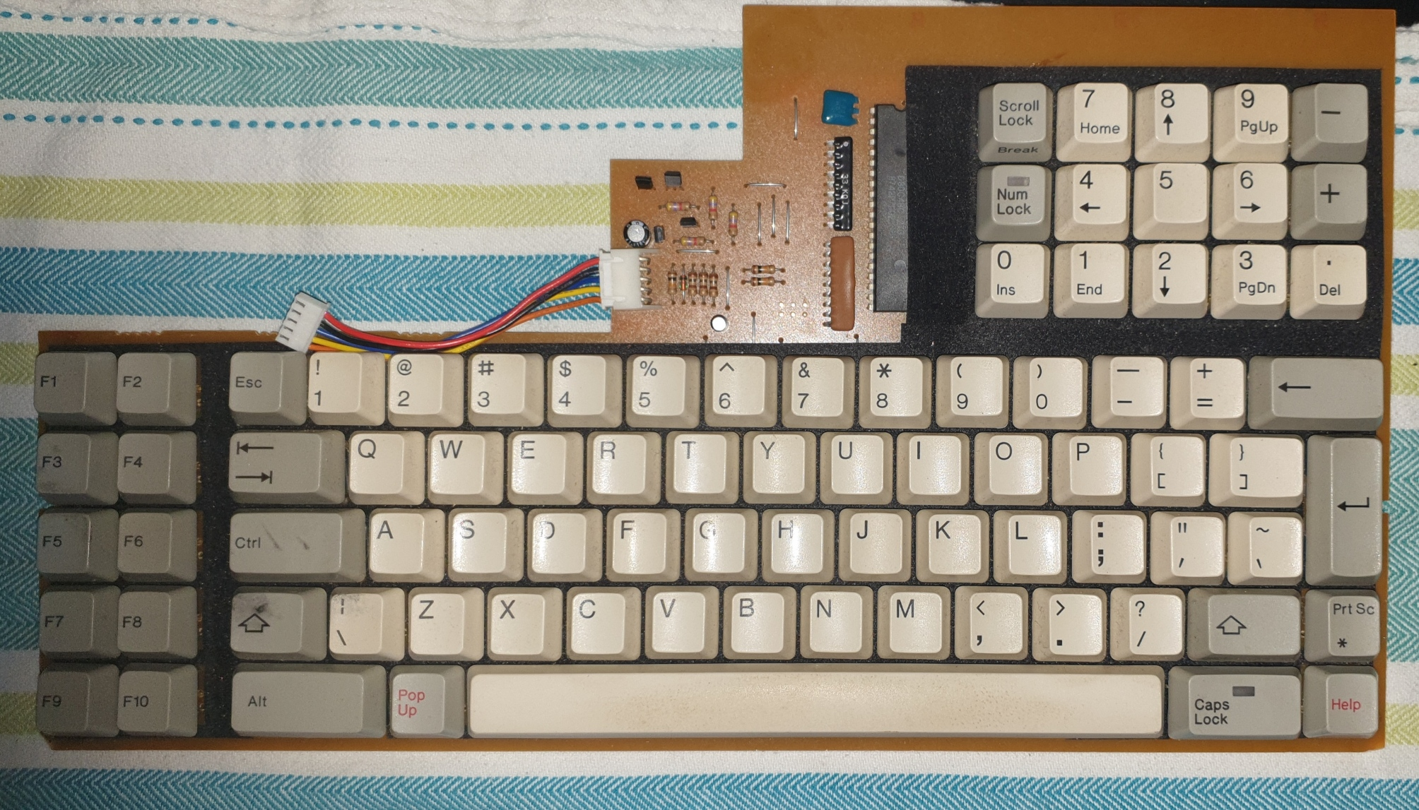

Total keyboard newb here who has searched the forums up and down. I scored an old NEC Multispeed Laptop with this Alps keyboard. It has a five pin connector that I'd suspect *may* work with a PS2 to USB adapter, but I have no idea how to proceed. Does anyone know how I can ultimately make this a modern usb connection for use with raspberry pi or other computers?

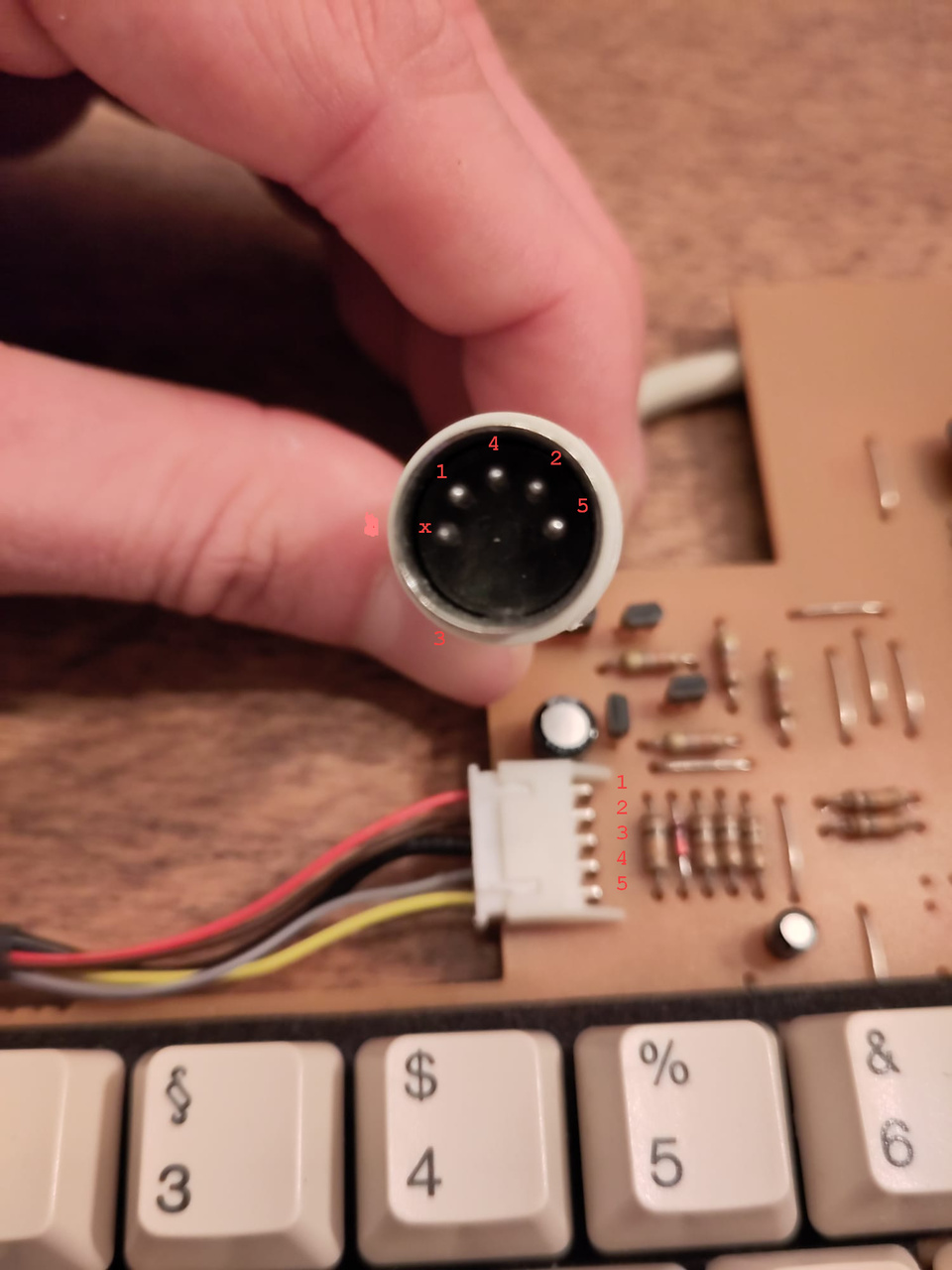

Yes, I can confirm it is XT. Here's a picture of the pinout:

I just realized the way I positioned the three could lead to misunderstandings. The leftmost pin is unused

Dude, @TNT! You just saved me a lot of time and tinkering! Thank you! Do you have an XT to USB converter you'd recommend? Something like this maybe?

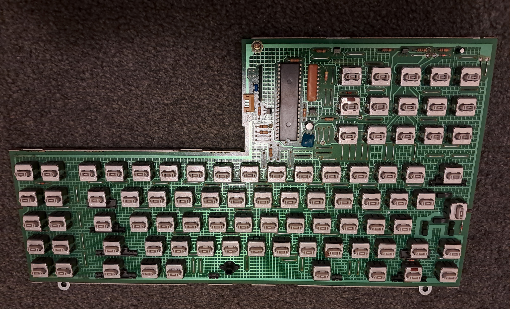

I've got the same keyboard, except for some reason the motherboard on mine is green and the shape of the board is a little different :

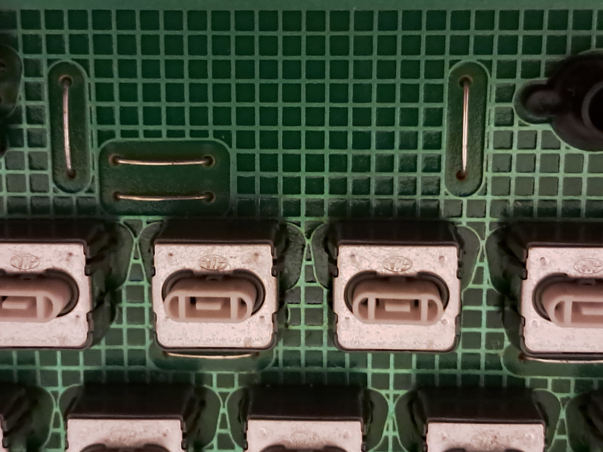

The key switches are Alps SKFL :

I managed to dig up the manufacturer's manual for it and can confirm that TNT's wiring is correct. In my case, I also wired up pin 3 (Reset). I don't know for sure if it is needed but I ended up doing that while troubleshooting issues I had getting it to work (which were actually my own fault) during a prototyping phase and left it in when I actually soldered up the converter anyway.
There are 2 non-standard keys on it and these are the mappings for them :
Pop up - maps as Japanese Yen key (JIS Yen)
Help key - maps as numpad comma (P,)
I had to use the XT/AT Terminal Full key version of the firmware, because that was the only one that supported these two extra keys.
