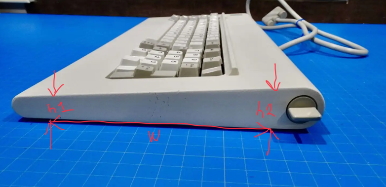

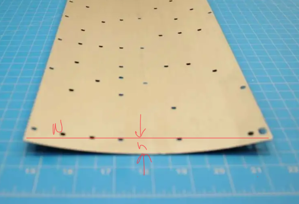

I guess the easiest way to measure the curvature is to measure the width w and the distance between the straight line and the middle of the curve h
side view of a Model F terminal keyboard
New Note 2.png (507.53 KiB) Viewed 14911 times
For the angle, it should be enough to measure the height at a couple of places h1 and h2 and the distance between them w.
I am toying with some case ideas, that don’t look like a rectangular billet of aluminium. I wonder how well it might work to have a curved top that echoes the keycap profile. If that doesn’t work out, I really like the gentle wedge shape with round front and back that many Models F have. Seems like a good starting point would be to copy the original.

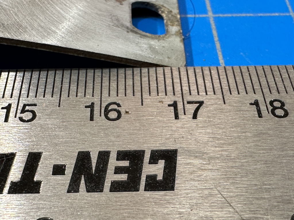

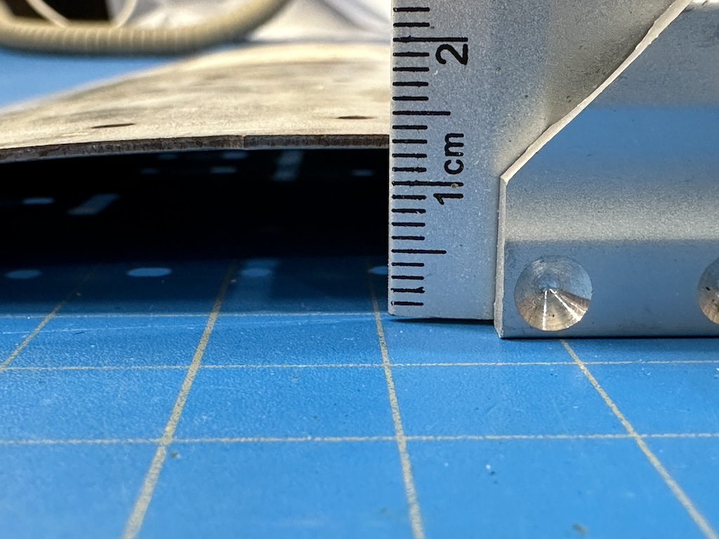

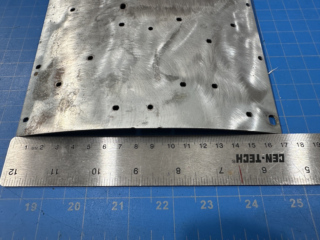

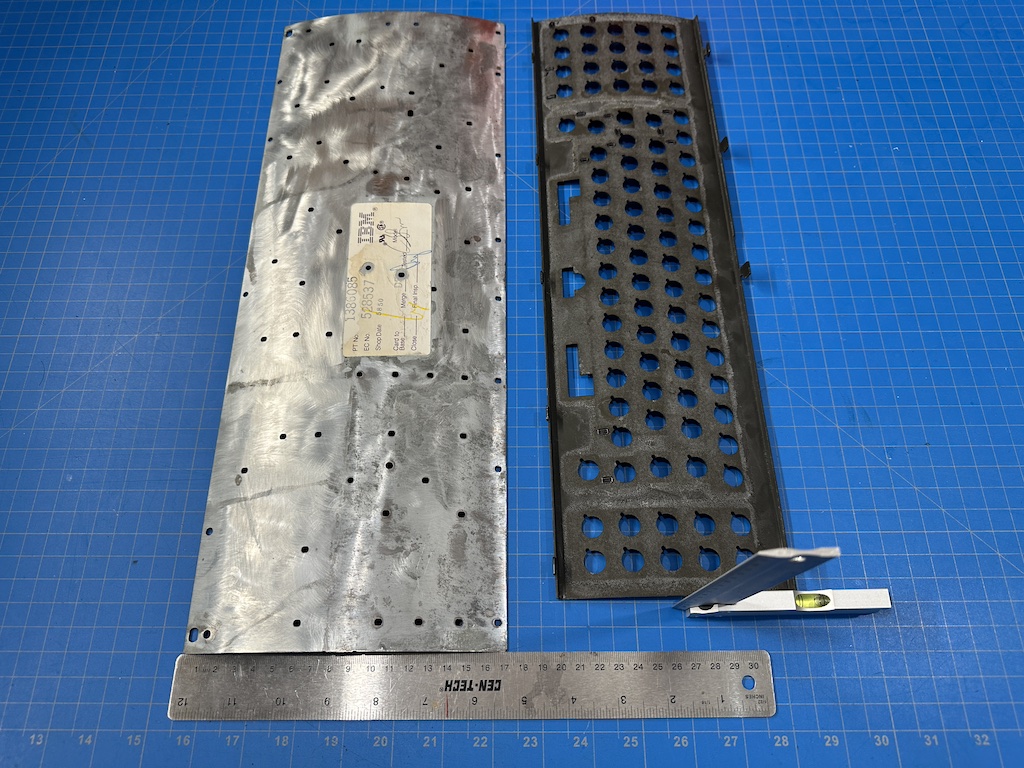

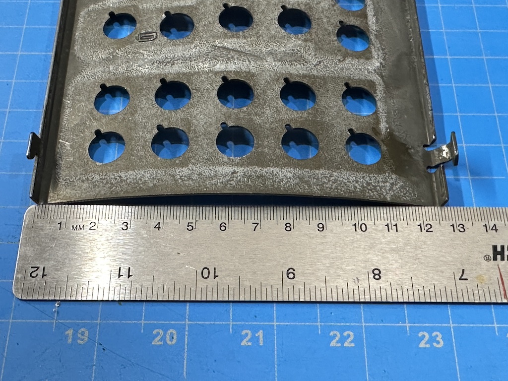

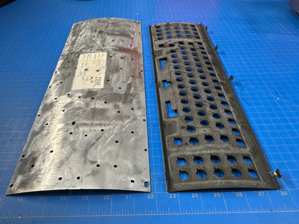

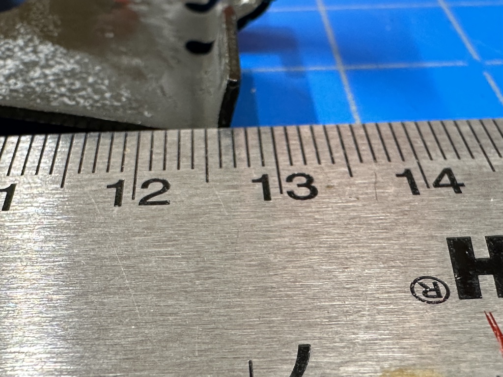

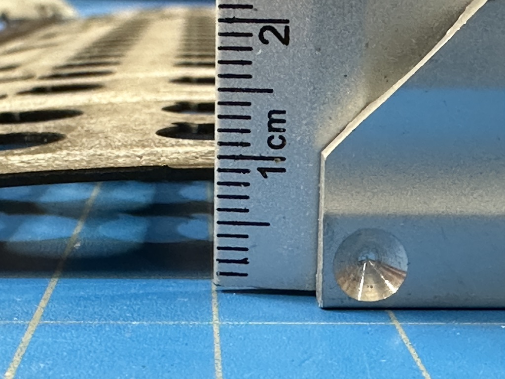

Some model M and model F backplate reference photos with ruler.
Not sure what the project is or what the measurements are for, but @fanf contact us at [email protected] if you want to buy/borrow these spare parts for more exact measurements
IMAGES 1, 2: left side (silvery metal plate from 1988 model M, right side (black metal plate from 1983 model F)

IMAGES 3, 4, 5 show model M plate (1988)

IMAGES 6, 7 8 show model F plate (1983)

Magnificent, thank you!
So for the Model M it’s 171mm wide and 12.5mm high, so it subtends an angle of 33° and has a radius of curvature of 300mm, or 11.8 inches (35 barleycorns or shoe size 12 for Chyros’s leftpondian fans). The bigger angle is not too surprising because it has to cover the F key row and other extras that I left out of my guesstimate.
For the Model F I’m going to say 124mm wide (taking off a couple of mm for the flanges) and 8mm high, so it subtends an angle of 29.4° and has a radius of curvature of 244mm (9.6in). Part of the reason for the shorter radius is the difference between base plate and switch mounting plate, but I doubt that is much more than 10mm, so the numbers say the Model F is more scooped than the Model M. Hard to tell from the pictures, tho!
