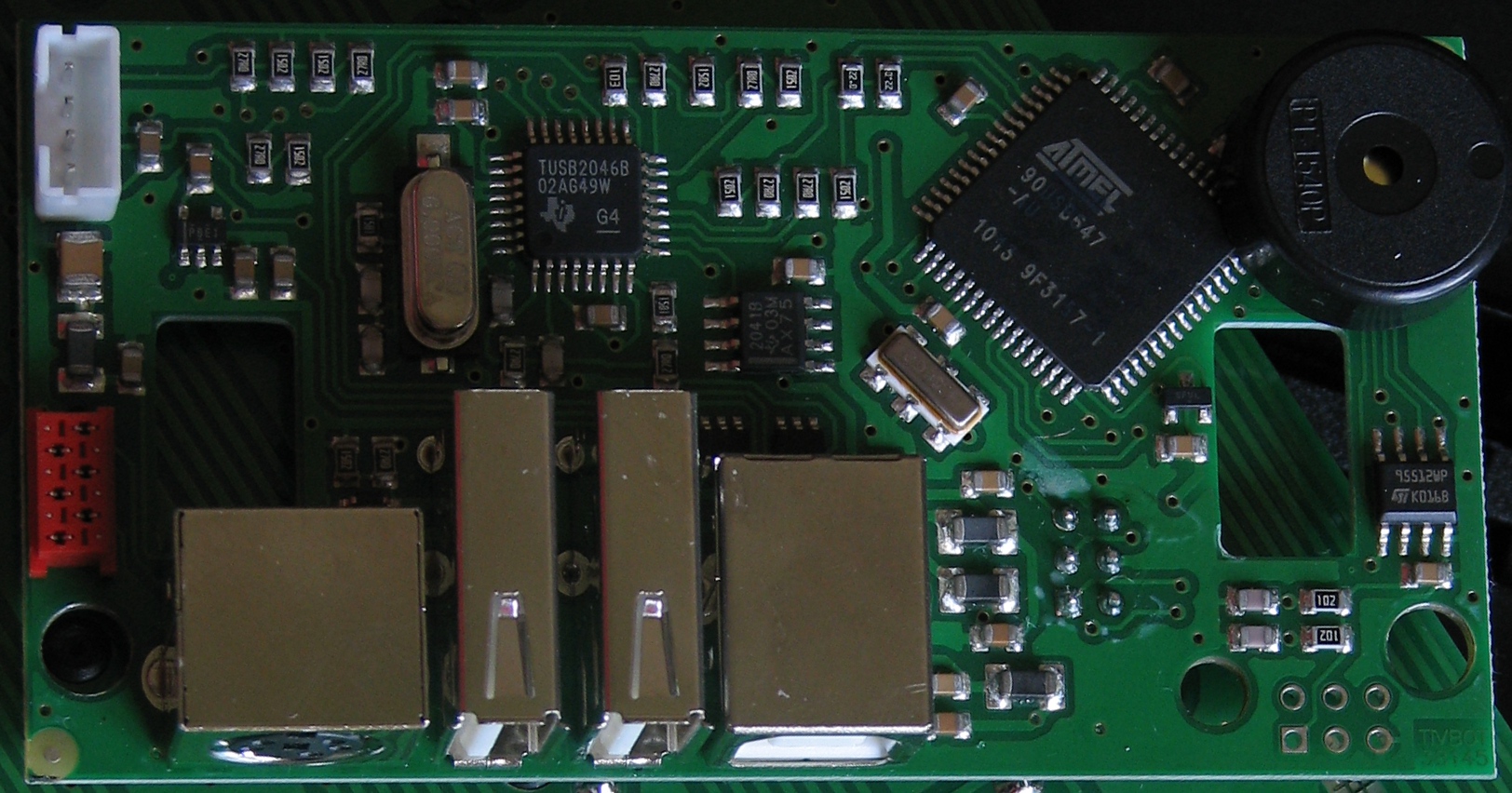

Soarer
14 Jun 2012, 20:16
Where's that from? Looks pretty good already!
RC-1140
14 Jun 2012, 20:19
That's apparently an USB Tipro Controller board. I wish I had an USB one too. I only have two PS/2 ones.
Soarer
14 Jun 2012, 20:26
Ah, right. Yeah, that would need some rework :ugeek:

Well yeah, would need quite a bit of work actually but at least it has something very close to your beloved AT90USB128x ;)

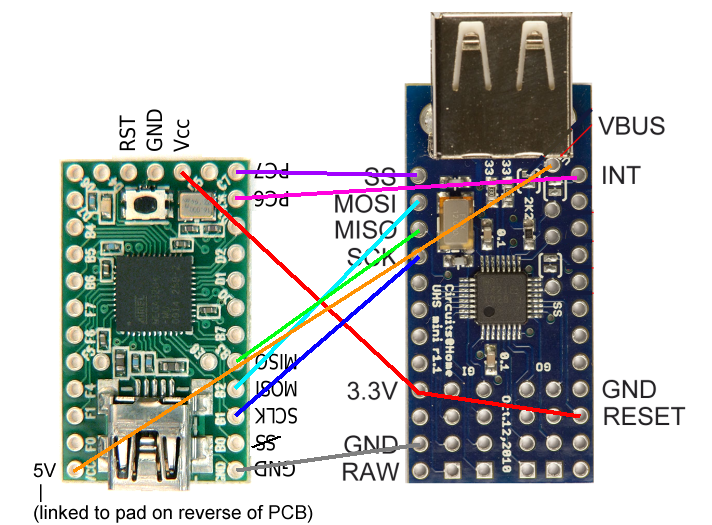

Soarer
17 Jun 2012, 23:13
Soarer wrote:The shield would need to get both 3.3V and 5V. I think that would mean running the Teensy at 3.3V, and patching a wire onto the 5V pad - schematic.
Heh, I hadn't seen this (since it's in the teensyduino section): teensy + usb host shield.

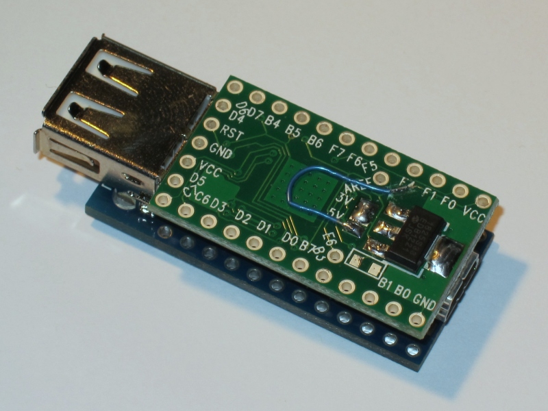

Soarer
23 Jun 2012, 17:48
These two fit together really nicely...
Note: to put that link on the back (so that one of the Vcc pins is still +5v) requires cutting the PCB track to that pin first.

Soarer
24 Jun 2012, 14:22
No more info than before really! But yeah, it should work, if I can find time to program it. This setup is pretty much equivalent to the Leonardo + Shield setup, except that the Teensy is running at 3.3V instead of 5V. And obviously, this one is smaller, and requires some fiddly soldering!
