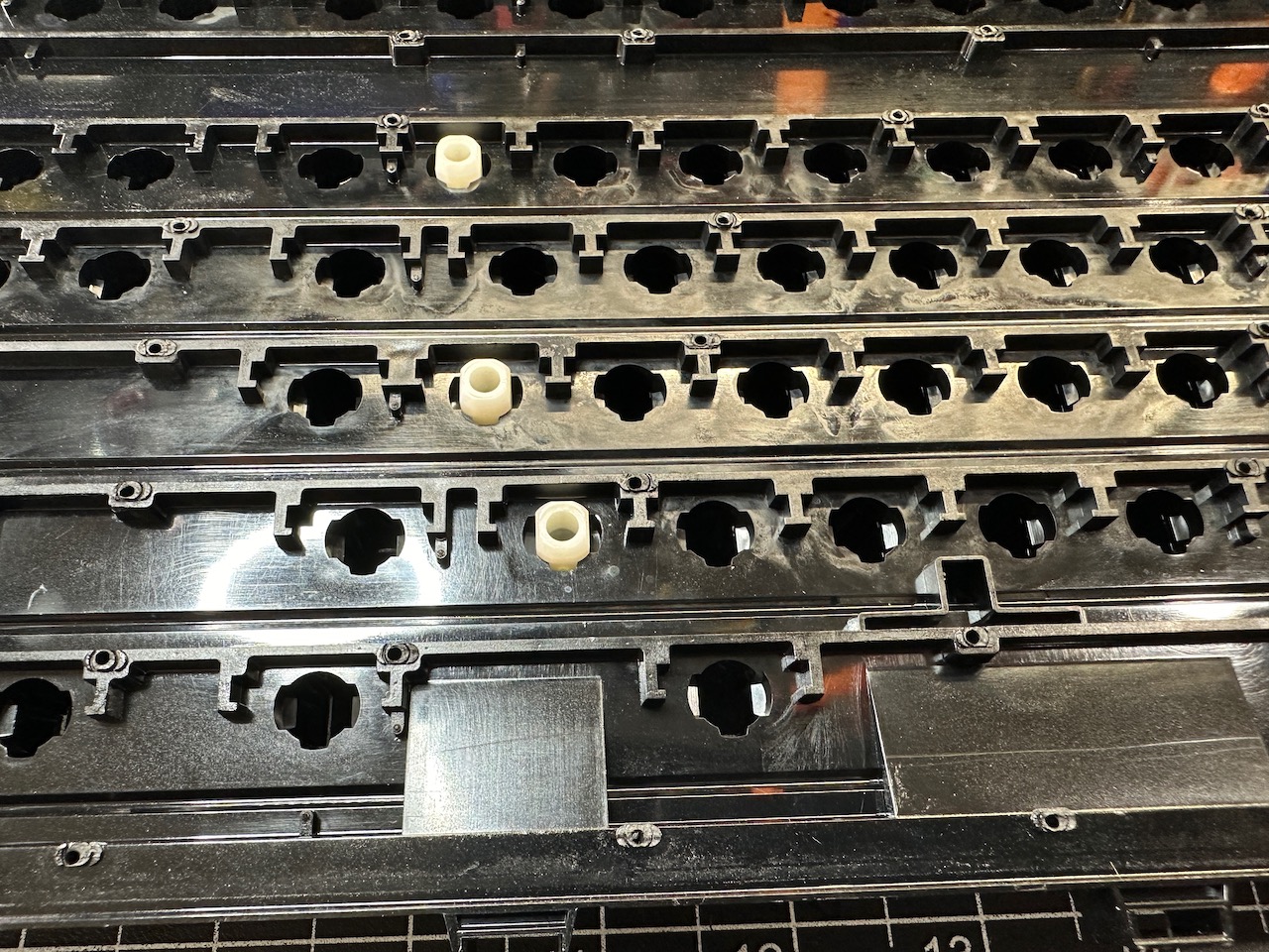

I have a Model M that needs bolt modding (will go with screws instead of nut/bolt combo) and I saw someone in other post mention the idea of using heat inserts in the barrel plate so it can be in theory safer to open up the keyboard assembly more frequently.
Is that a bad idea? Has anyone tried it?
I remember measuring the thickness of the plate where the screws would go (excluding the bottom row) to be of thickness around 6.5mm and the diameter of spacing between the two "crescent moon" shapes where the screws (or heat inserts) would go to be around 3.5mm so I've ordered heat inserts for M2 screws with an outer diameter of 3.2mm, and length of 5mm, as well as M2 (supposedly) stainless steel screws with 6mm length.
If I try pressing the heat inserts and end up fucking my plate, is there currently where I can get a replacement original one?

Give it a go! If you're using 3.2mm outer diameter inserts then the worst that can happen is you'll have to remove them, and then you can almost certainly use 3mm nuts and bolts to complete the mod, as normal.
I personally think it won't work well, but if no ones done it, worth a shot.

That's the spirit. Do the inserts look something like this?
It's a nice idea at least and will be keen to know how well it works. Screwing into brass is surely less worrying than wearing out aged plastic.

ifohancroft wrote: 27 Nov 2023, 09:58 ,,,diameter of spacing between the two "crescent moon" shapes where the screws (or heat inserts) would go to be around 3.5mm so I've ordered heat inserts for M2 screws with an outer diameter of 3.2mm, and length of 5mm,
I normally use a drill bit of 1.5mm between the plastic crescents when I replace the melted plastic rivets with metal M2 screws. Exactly drilling 3.2mm holes x 56 times into the plastic barrel plate, seems a bit more risky relative to the slight technical advantage gained with "frequent assembly/disassembly".
One would certainly need to be careful and more precise to not to do more damage than what you are trying to prevent. If you were repeatedly opening the model M barrel plate layers several times a month across several years and if there were alot of excess supporting plastic around the holes, the heat inserts would be warranted.. but I think most would only disassemble a model M keyboard once every year at most?

As said above you have to be very careful not to damage the parts that hold the flippers in place. Seems risky.
The heat could also deform the plastic and the flippers would not fit anymore or not move. I would only try on a spare keyboard…

This has been done before! I have yet to try it but would like to try it as I have spare parts and some cracked barrel plates I can use to experiment with.
See:
viewtopic.php?f=7&t=22822
