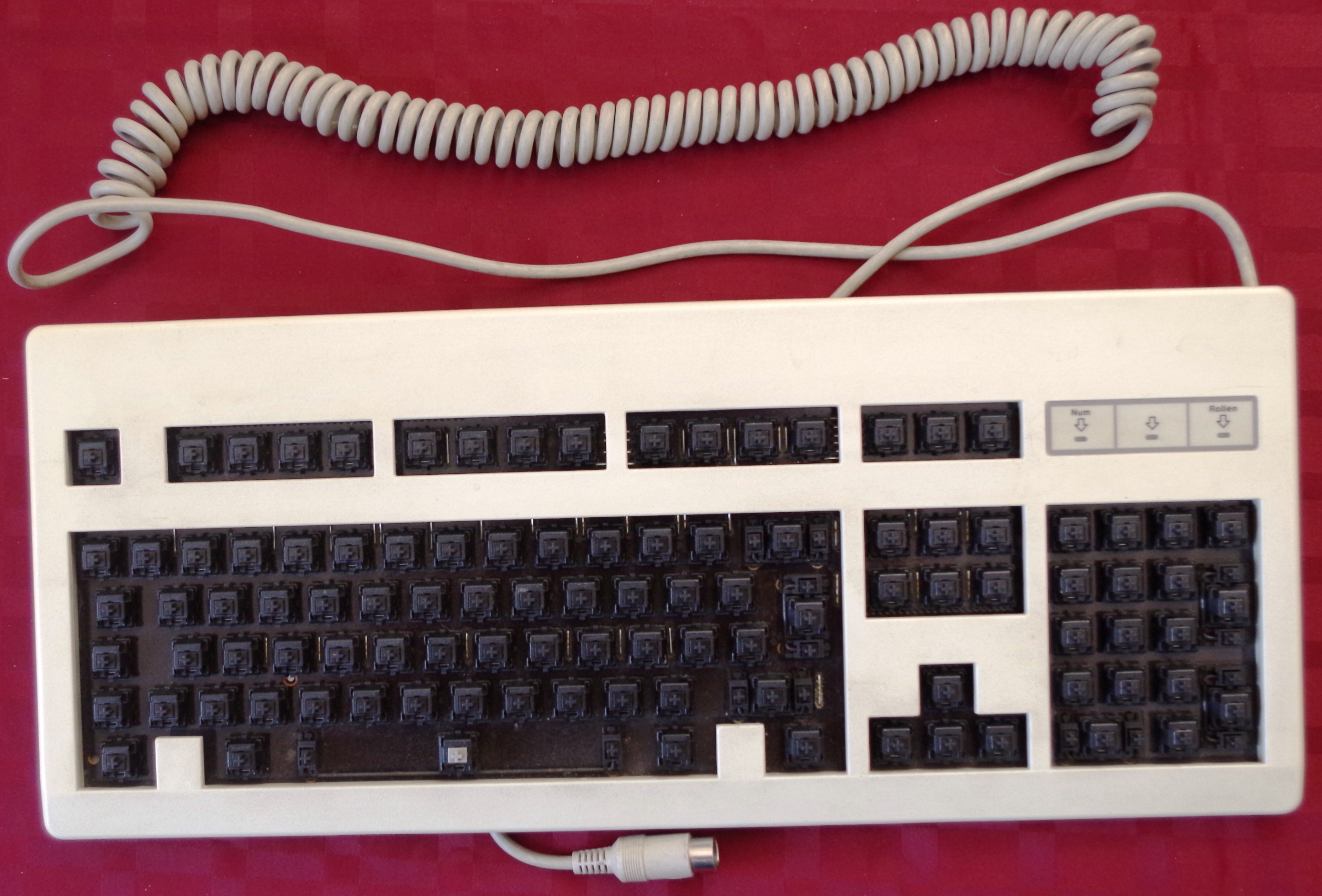

27 Dec 2023, 17:33
I happen to have a G80-3000 HAD without keycaps:
Please PM me if you are interested.
