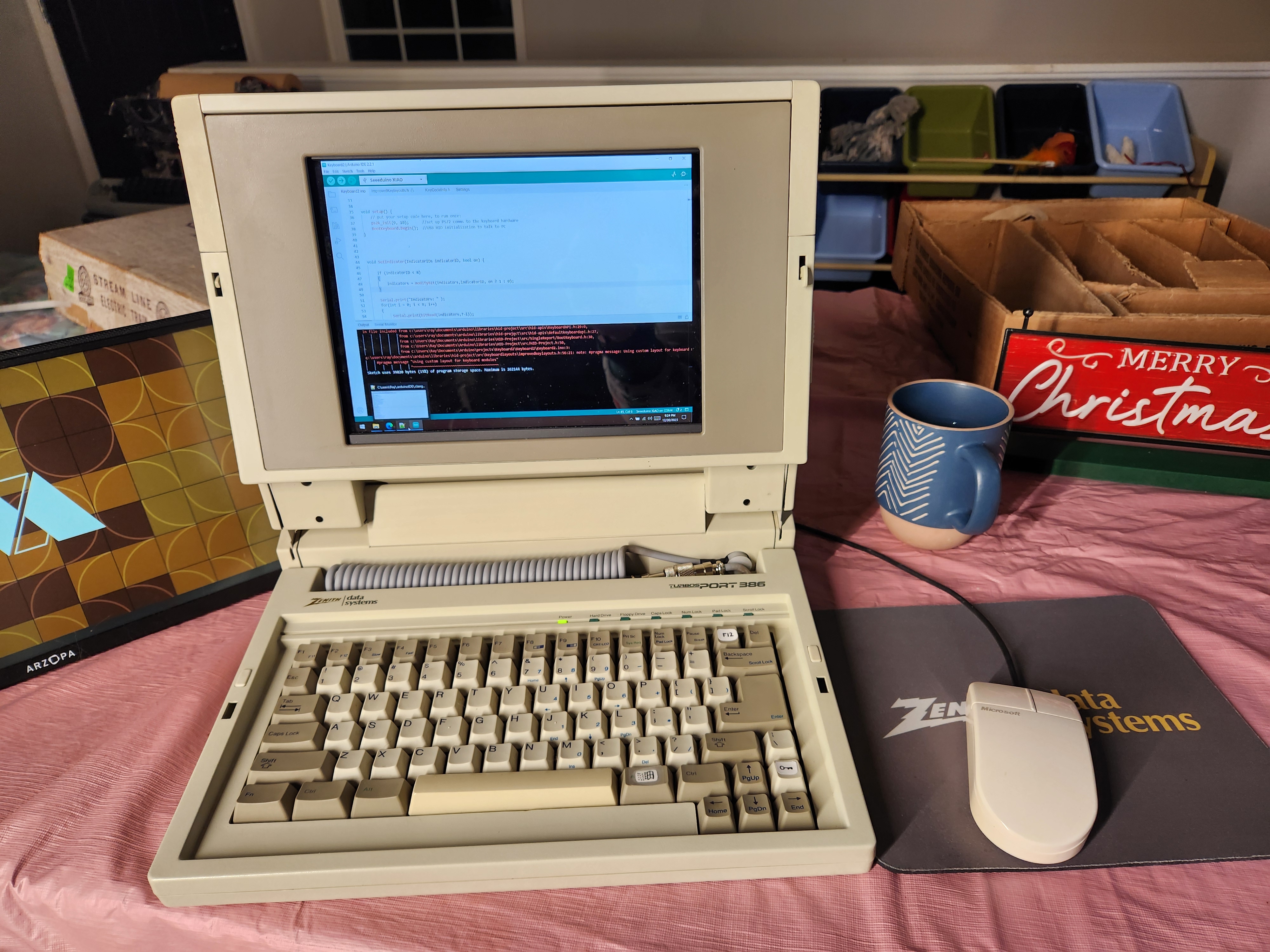

Yep! That's what I'm working on! Here's mine in it's half-finished-but-probably-never-truly-finished form:
Ooooh the vintage purists are gonna hate me!  But I've gone through great pains to make sure everything I do is 100% reversible.

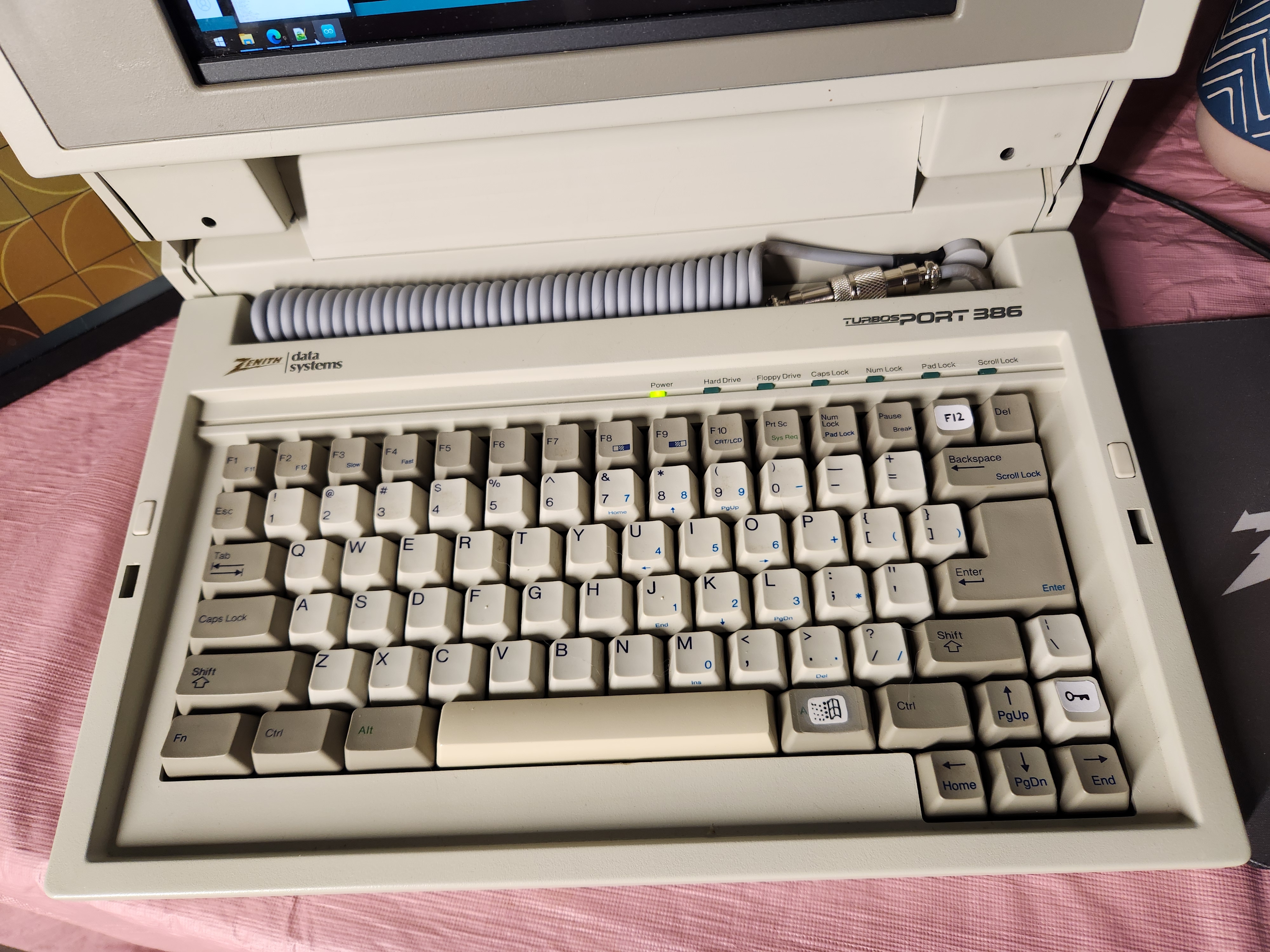

I had to replace the original cable.  The rubber was cracking and falling off.  Lucky for me, you keyboard guys like your cables coiled, so a suitable replacement was readily available!  So thanks! :D

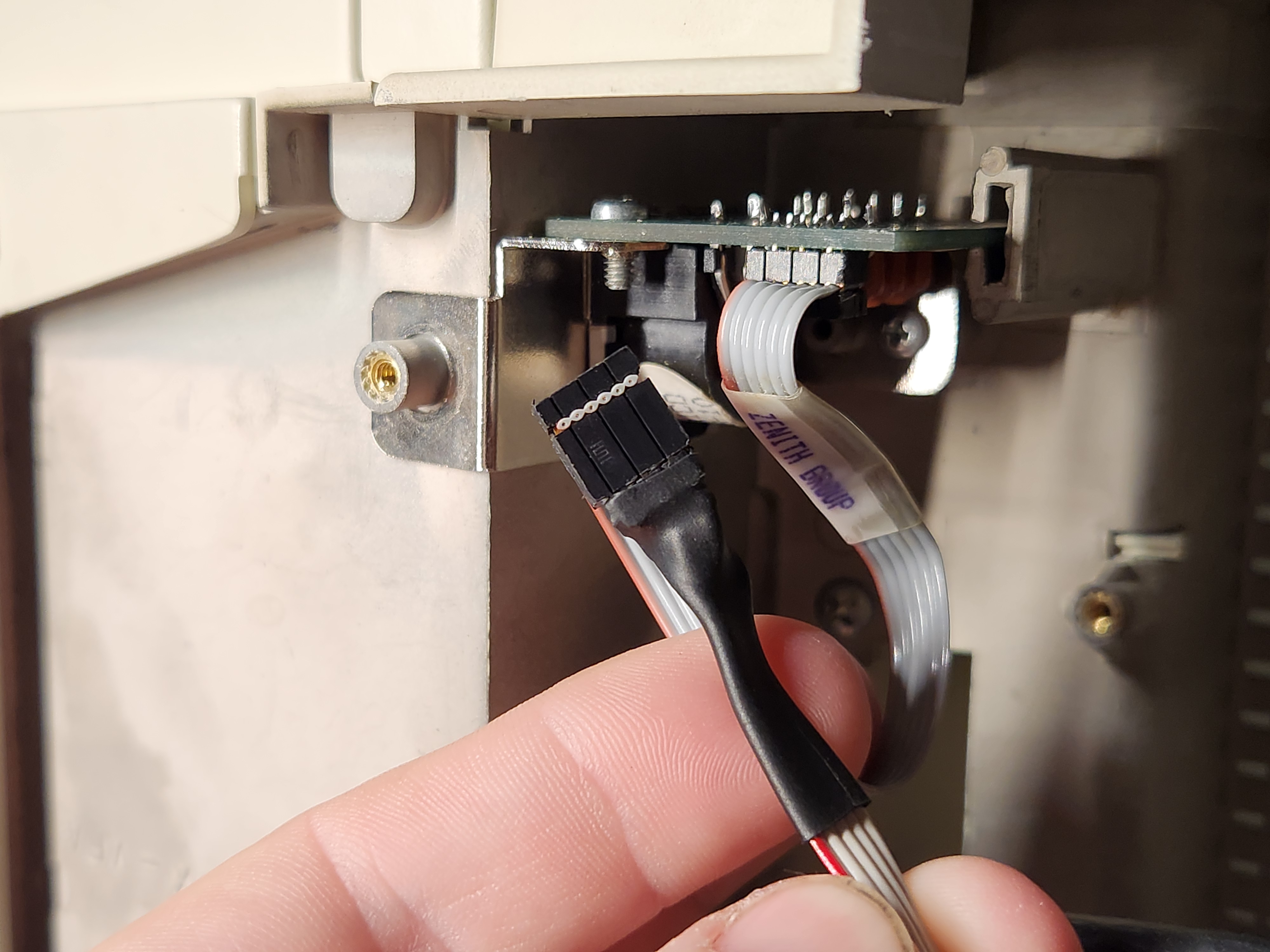

This is the back of the original keyboard port with it's original short connector and my custom adapter cable plugged into that.  My cable was made from IDE ribbon wiring and two rows of pin header superglued together to form a 2x3 array.  Then one pin was cut to make 5 pins total.

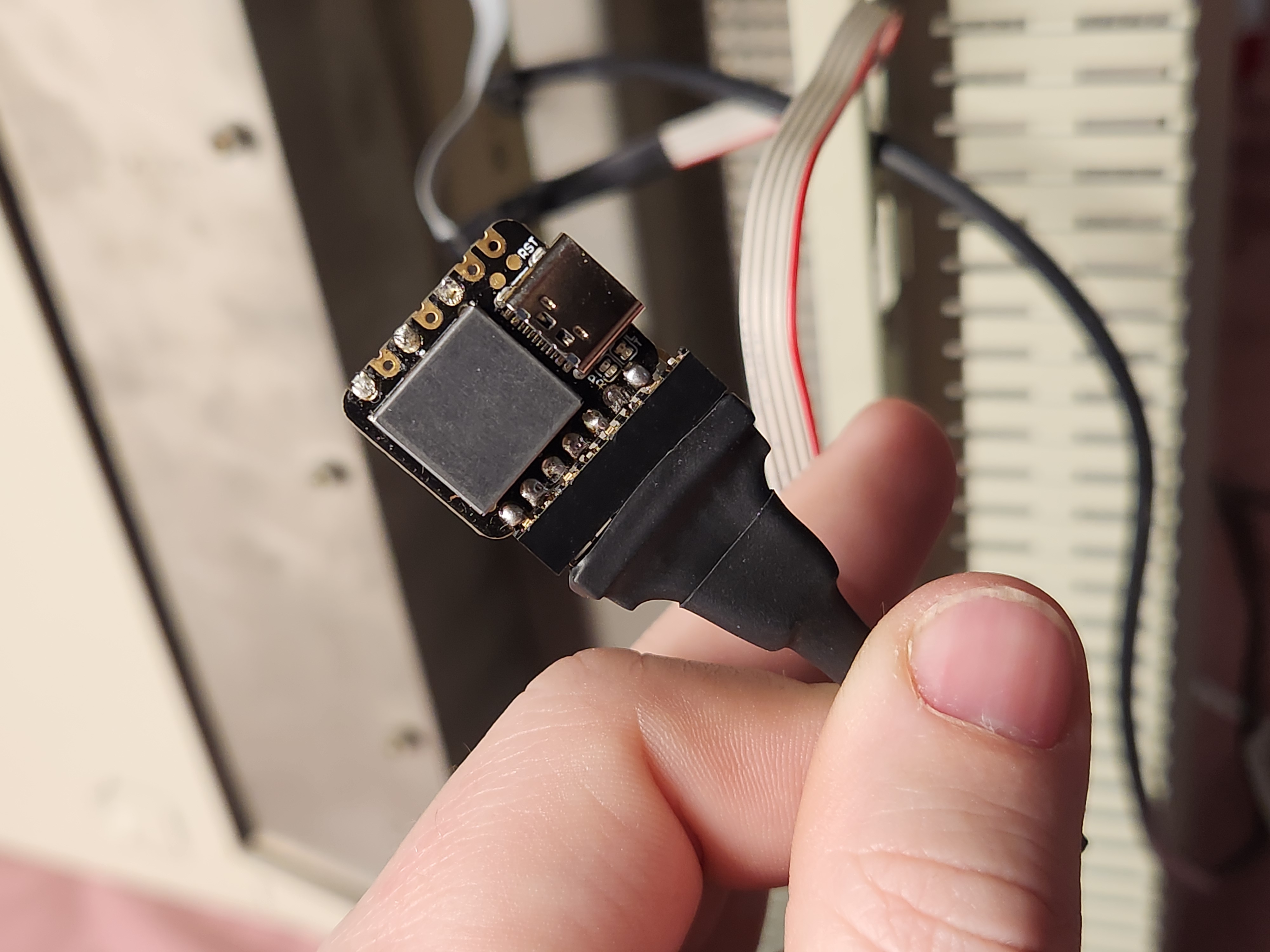

The other end of my custom cable, another pin header, this time in one long 5 pin row.  The brains are supplied by a Seeed Studio Xiao microcontroller running custom firmware I cobbled together from some Arduino libraries that I modified to suit my needs.

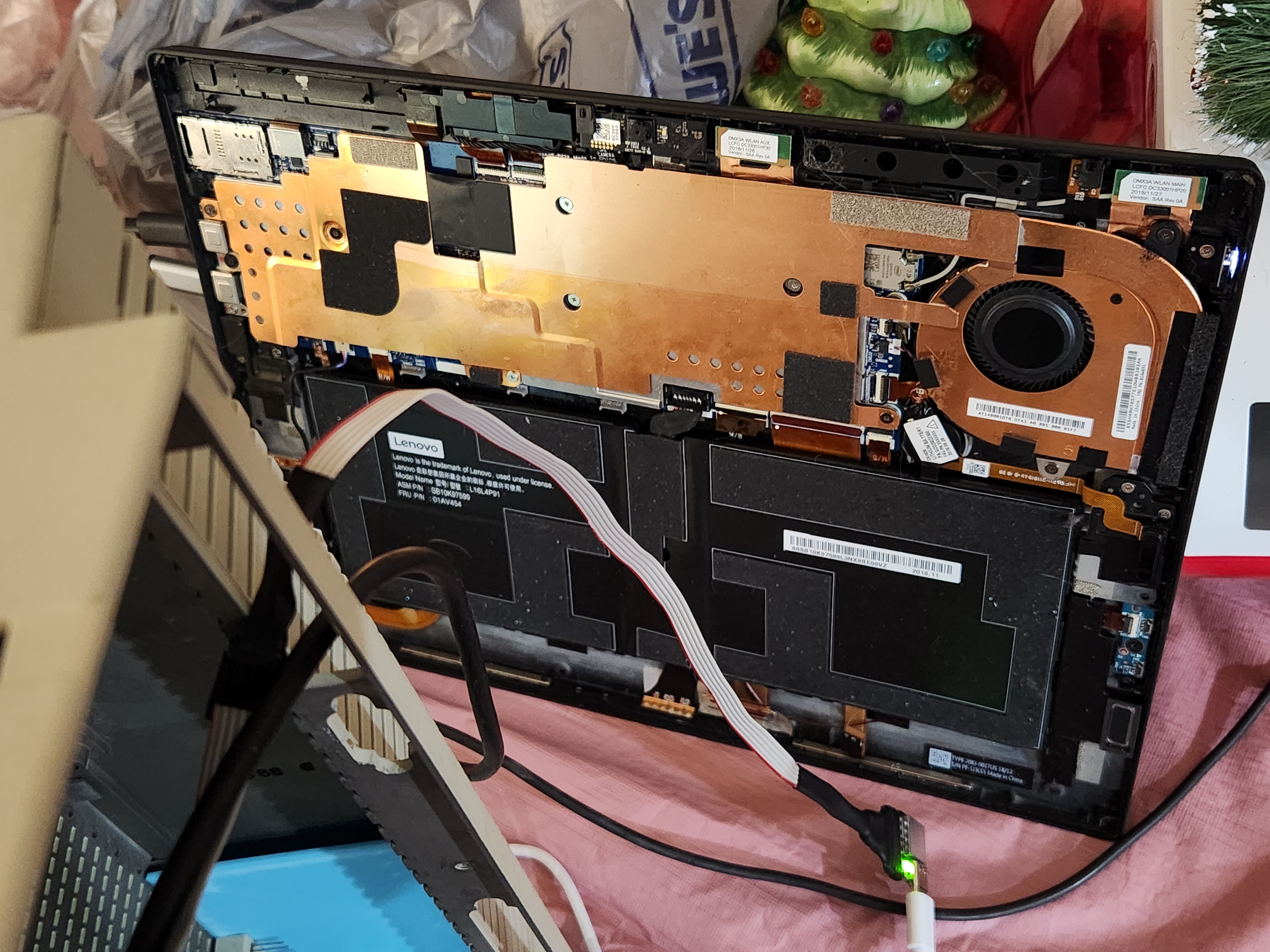

And in case anyone cares to know, the wizard behind the curtain is the guts of a Lenovo X1 Tablet Gen 3 with a Core i7 running Windows 10.  Still working out the specifics of where and how it's going inside the case.  There's also a port replicator to supply additional I/O.  But my promise to make it 100% reversible makes exposing that I/O... "interesting".
I've been using the computer as my work computer (I'm a software developer, it's been fun) as I developed the keyboard's firmware. It's actually quite usable now. I've remapped some keys to give myself easier access to keys I use a lot. I also hard coded a couple macros. I plan to add two way serial support so I can change key mapping, macros, layers, etc. to the keyboard without getting the Arduino compiler involved. But for now, I'm really happy with it.

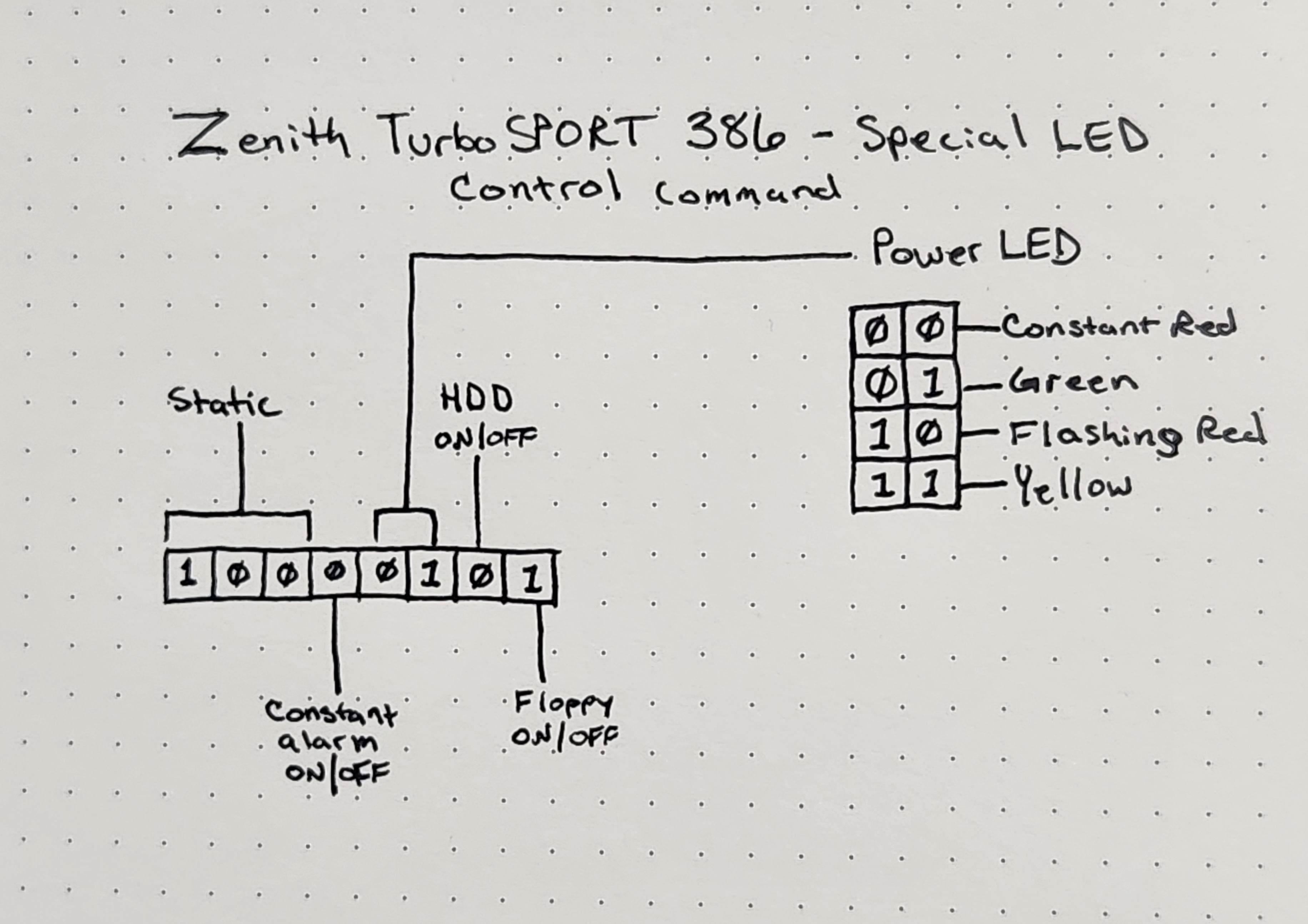

I don't know if anyone cares, but I did figure out how the actual command works. It's not a two byte command like the regular LEDs. It's a single byte. The diagram below shows how it works:
The first 3 bits are 100 and are static. Following those are 1 bit that indicates if the constant alarm should sound. 1 for yes, 0 for no. After that are two bits that indicate the color that the power LED should be. In my example, it's set to 01, which would make the LED green. The diagram shows the values for the other colors. Following that is a single bit indicating if the HDD LED should be lit, and then finally, a bit that determines if the Floppy Drive LED should be lit.
I was able to control the LEDs and alarm as I pleased using this single byte command. I'll also note that the keyboard does not respond with 0xFA (ACK) when this command is sent. So there you go. It's working! You can see it in my earlier post :) The power light is set to come on once the keyboard is initialized now.
