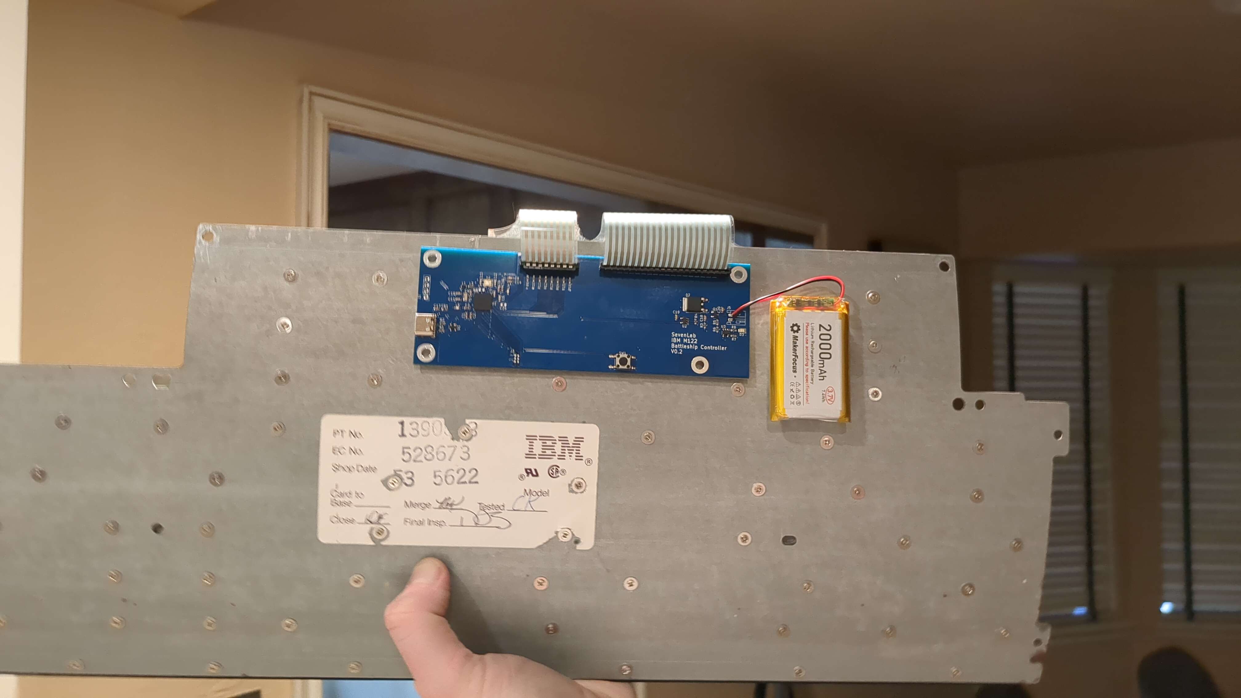

Taking the operational development kit version as a starting point I developed a PCB for my M122 using KiCAD as design tool. My idea was to create a drop in replacement for the existing controller. This solves all the PCB-mounting and flat flex cable routing issues at the cost of a rather large and expensive PCB. But, in the end the whole project is not about saving money. For the Bluetooth antenna I decided to go with a PCB antenna, I do not need high efficiency antenna operation to bridge the usual distances on my desktop. For USB I use a type C connector, of course. The nRF controller cames with a challenge on its own. The controller comes in an aQFN package that calls for advanced PCB manufacturing technologies. I was not sure that my board layout would actually work, and not sure about the reliablility of the production process. So, I procastrinated the order at JLCPCB for some weeks until I finally collected enough strength and self-confidence to place it. I decided that blue is the colour of choice for this project, because you know, Big Blue. When I received the first iteration of the PCB I found out that I miscalculated one mounting hole position and messed up the footprint of the high speed quarz.
After a final touch to the pcb layout I placed an order for the next iteration with JLC. This time it worked like a charm.
The new board replaces perfectly the original board. For Bluetooth operation the keyboard is powered from a recharheable power pack. For my personal taste it is fine to glue this pack with a strip of gaffer type. I tell myself that I avoid unnecessary mechanical stress on the delicate cells.
The board has a reset button which can be really useful as the board can run from battery power a fact that makes power down resets practically impossible. I admit that I drilled a small hole into the outer shell of the keyboard to allow actuation of the button by the a mangled paperclip. Still left on my to-do list is a nice feedthrough for the USB cable. For now I just have the cable dangling out of the original outlet. This is connected to the USB connector on the controller PCB.
