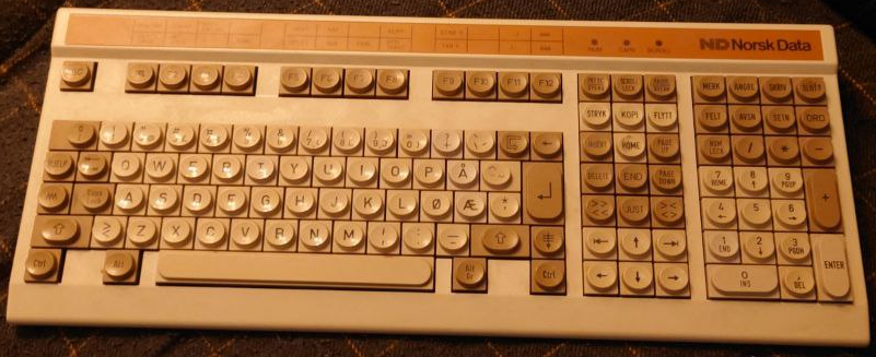

I have now disassembled the firmware of a total of 4 versions of the TDV-5010 keyboard from Tandberg Data, and to make it easier to see all of the changes in the code I have put the codebase up as a git repository. I have verified that each commit re-assembles to the exact binaries of the respective versions of the firmware, and I am now posting it here just in case anyone was curious.
Check it out here: https://github.com/Frodevan/TDV-5010_Firmware
