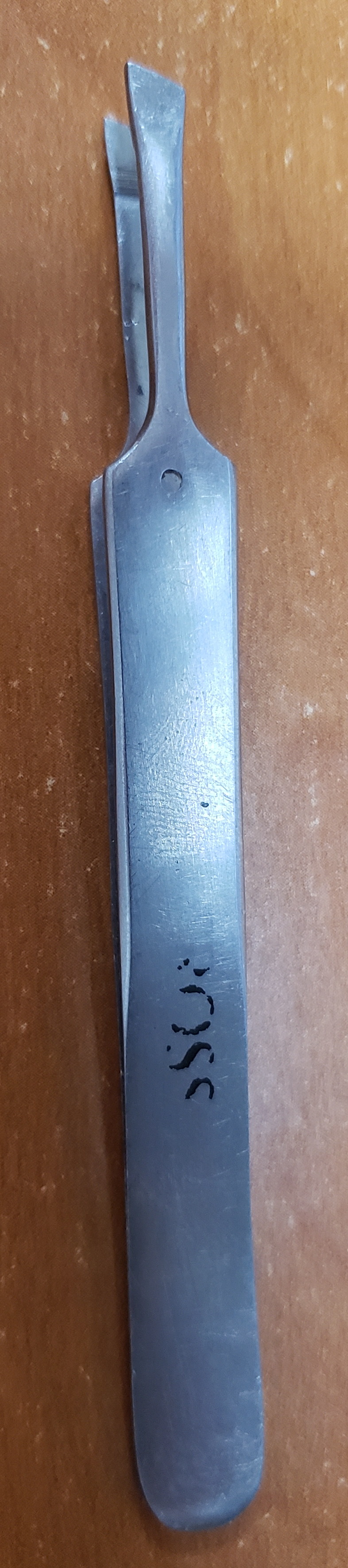

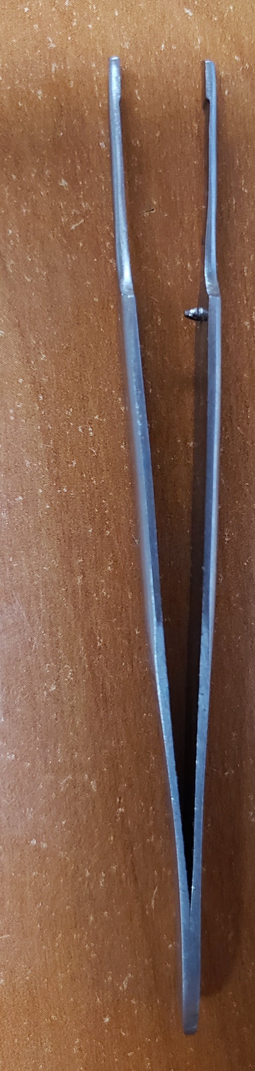

The best tweezers are those that have a beveled/angled edge but a few centimeters at the end being flat, and possibly serrated. My pair of tweezers is old and I can't find it for sale but if anyone has links to recommendations please share them.

My own tweezers used for reinstalling springs:
- my tweezers (2).jpg (746.18 KiB) Viewed 13284 times
- my tweezers (1).jpg (624.42 KiB) Viewed 13284 times
