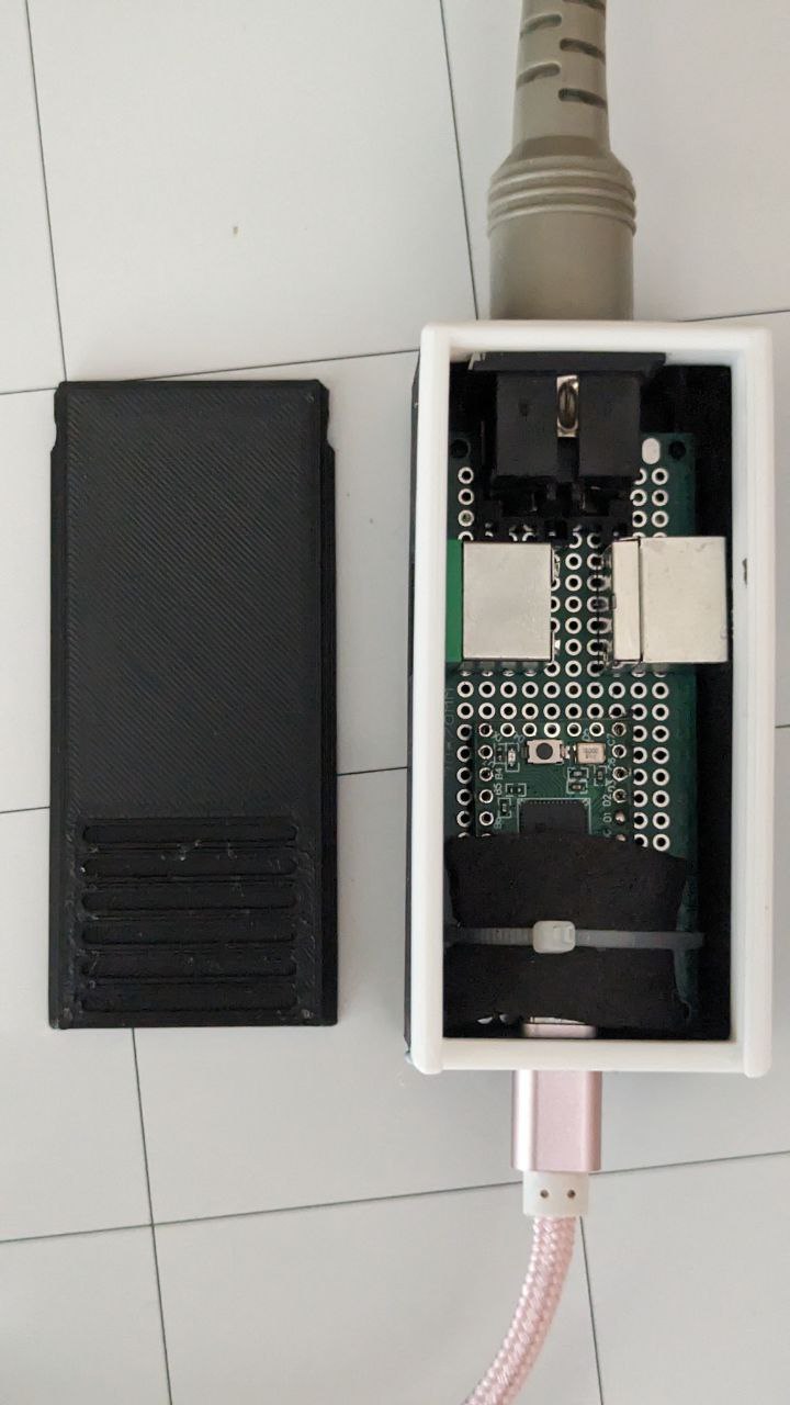

Hello!
I recently came into owning a Zenith Z150, which types a dream aside for one problem : some pretty gnarly key chatter. This chatter manifests both as missed keypresses as well as repeated ones that do not stop until another keypress.
The board came pre-equipped with an custom adapter internally, but I determined it was knockoff pro micro with an ATMEGA32U4. As far as I can tell, the solder joints are solid both on the board itself and on the microcontroller. Another puzzling thing is that the onboard solenoid seem to behave as expected/actuates with every keypress (although, even on repeated presses). So when a keypress is missed, I still hear the actuation. This leads me to believe the source of the issue could be:
- lack of N key rollover
- grounding issues/pin issues with the microcontroller
Below are some pictures of the microcontroller and keyboard itself:
https://imgur.com/a/seP93Nf
I have tried applying some additional solder to the contacts on the microcontroller, no dice unfortunately.The QMK toolbox sees the keyboard and seemingly the missed keypresses, which is quite odd. Below is an example:

Would anyone have any advice on this issue? I considered reflashing, as I would like to customize the layout some, but I am unsure if this would solve the issue. Any and all advice is very much appreciated!

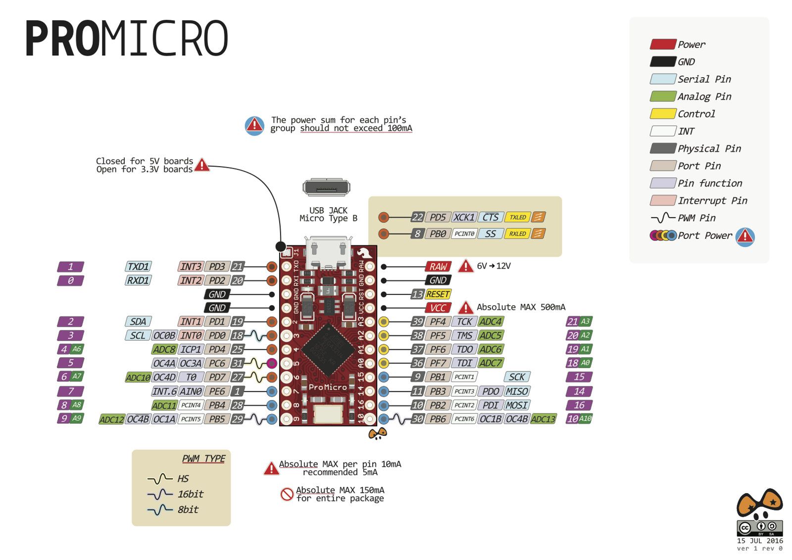

I am using the QMK Toolbox to flash, could that be the issue? Can't seem to find this particular issue anywhere. I assume it has to do with the fact this pro micro uses the rst pin rather than p7 for resetting, but I otherwise have no idea.

I'd suspect a reset pin issue. By default TMK uses PB7 which apparently isn't exposed on the Pro Micro. You should be able to edit the port and bit in config.h to match how yours is wired now. It probably needs to be on something other than port D.

Figured out that I will need pin 6 for the reset pin here, but both virtual box and mingw64 are giving me trouble when attempting to compile on my machine. Looks like I will need to come back to this later.
