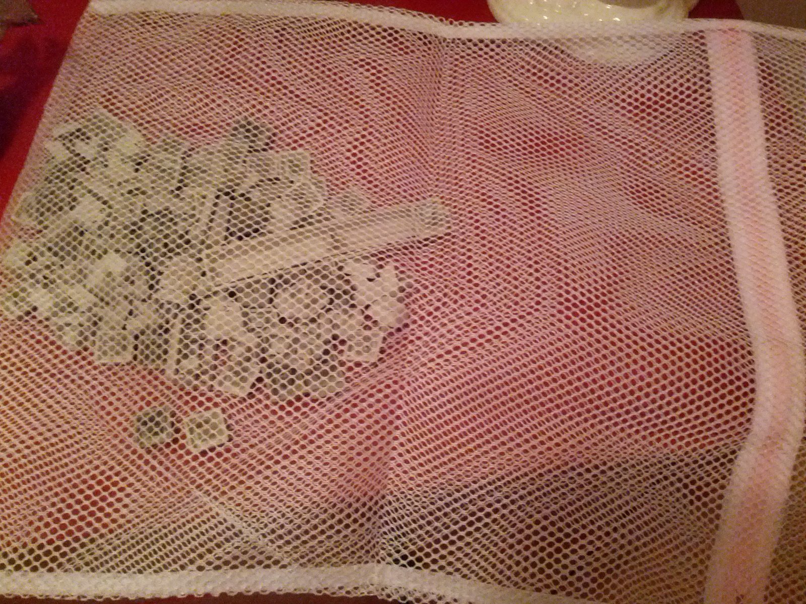

maxrunner
09 Aug 2012, 00:22
Gonna try this today, found a bag to put the keys in.
Bag for keycaps
Bag for keycaps
maxrunner
11 Aug 2012, 21:26
Seems this has worked nicely. Just washed the ibm keycaps, and now there's a new session going on with both alps and acer caps :P
