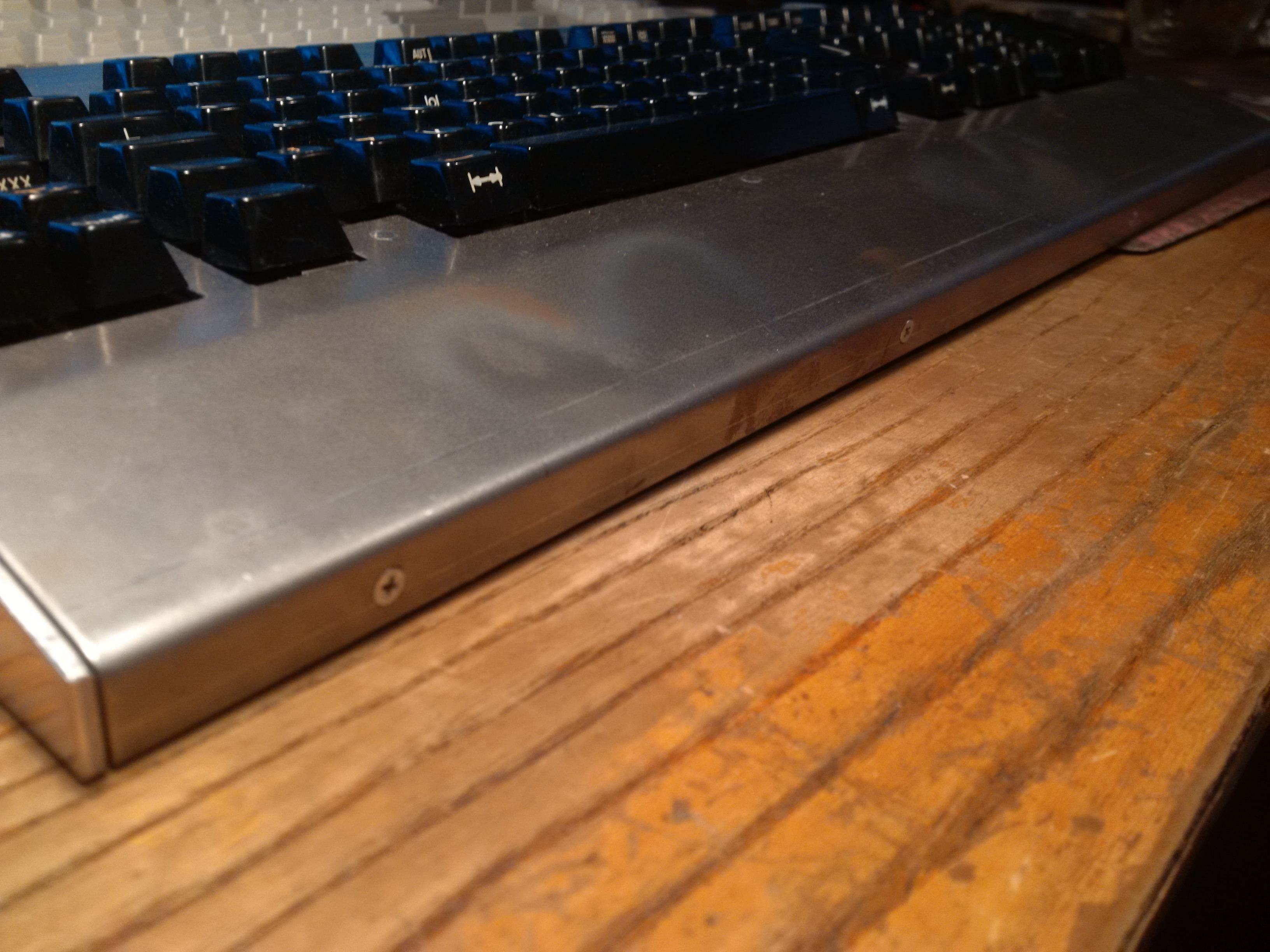

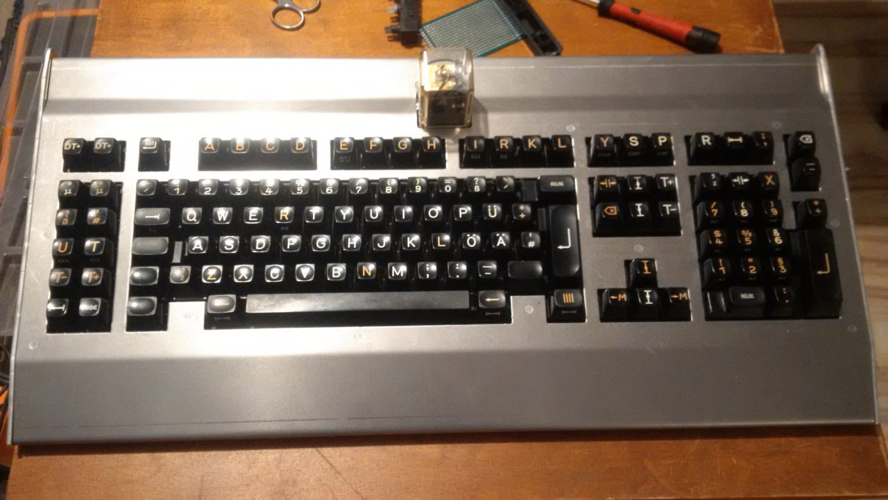

So i guess i'll start this thread with a picture of the thing i built in it's current state - then i can go backwards and explain, if anybody has any interest in how it was built and why.

How did you build the case and what's that thing in the middle - relay? Also, is it wired or wireless, and if wireless - how did you implement the antenna?
browncow
21 Feb 2025, 08:08
DMA wrote: 21 Feb 2025, 03:39 How did you build the case and what's that thing in the middle - relay? Also, is it wired or wireless, and if wireless - how did you implement the antenna?
The case is of my own design, i drew it in cad, cut on a turret punch, bent, and the bottom also has two bits welded in it. The top and bottom are 1,5mm mild steel, the side covers are 3mm aluminium, the flip out feet mechanism is made from 2mm aluminium. The thing on the top is a relay, you are correct here. ;) It's a wired keyboard, on the photo it just has the cable unplugged.

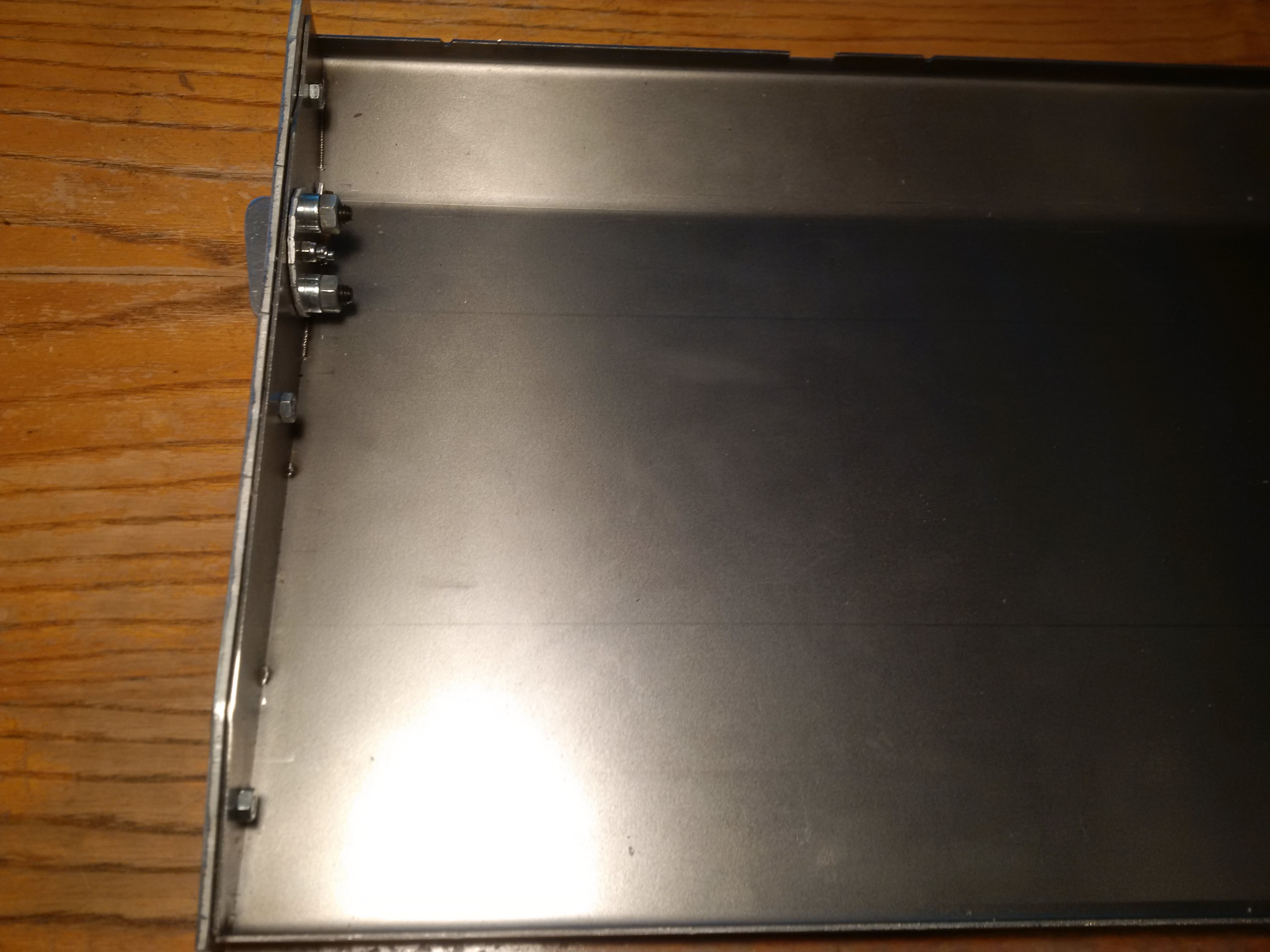

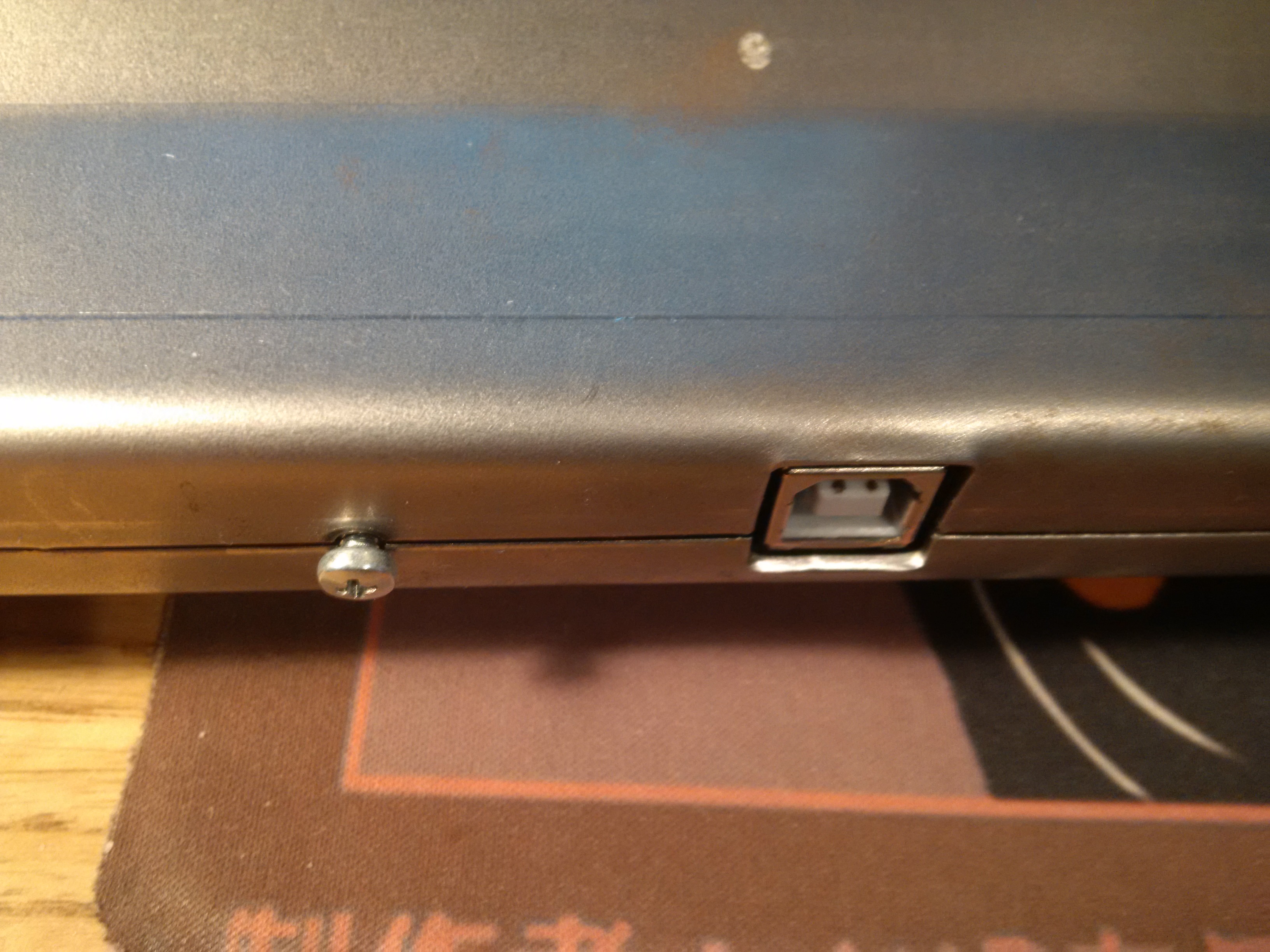

Taking it apart requires unscrewing those four M3 screws on the front:
And loosening those four on the back:
It is enough to just loosen them, no need to take them out completely. this is because these screws hold both bottom and top of the case to the switch mounting plate.

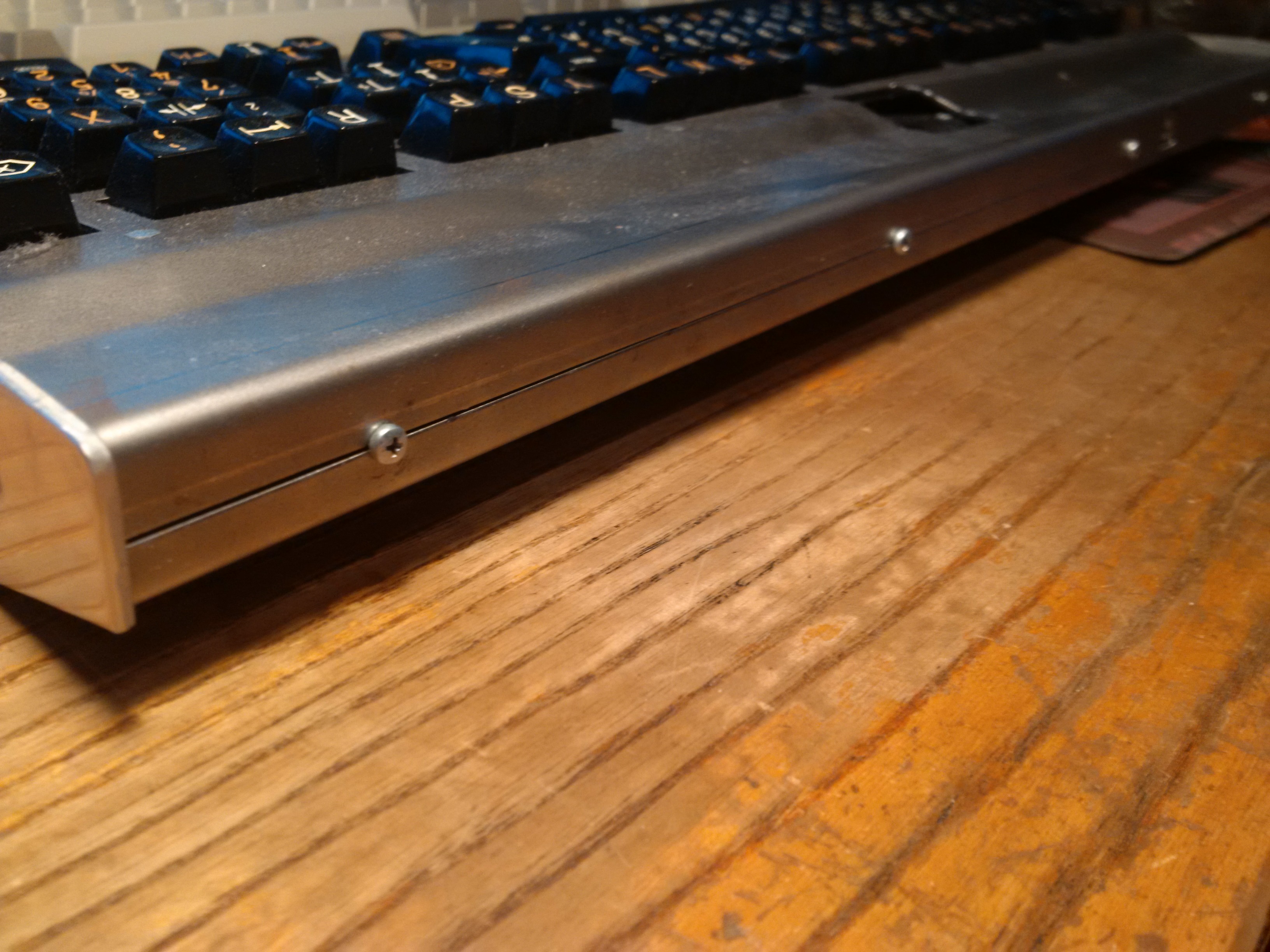

The bottom part of the case is very simple, it's welded to the sides, which also have those aluminium covers to make it fit flush with the top, and hide the foot mechanism.

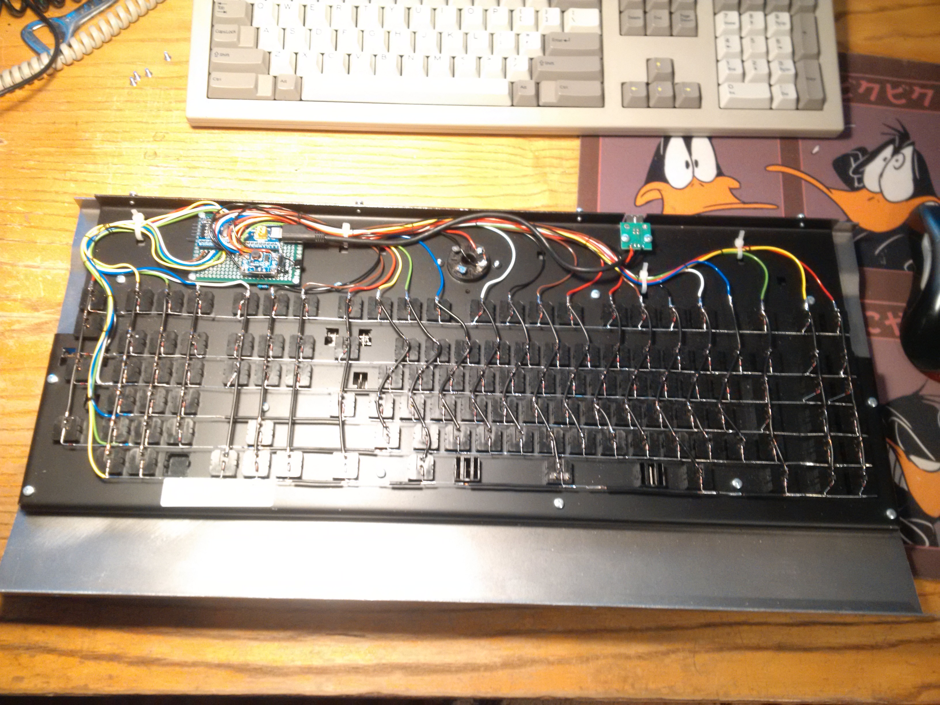

Everything attaches to the top of the case. This is mostly to make the wiring easier for myself, I can just wire everything up with the board upside down, there's no cables that i need to plug when putting the case back together. Plus it makes it really stiff. There is a lot of those BSO self clinching studs, plus, the switch plate has three bends that mate with the top of the case when screwed together. This basically creates a closed beam section when the whole top assembly is put together, so i really have no idea how else you could make it stiffer. There's absolutely no flex or, what mostly concerned me having before made a steel board - case ping, any nasty resonance caused by the case being able to vibrate when you type, there's none of that :) a rather nice, hollow sound instead.

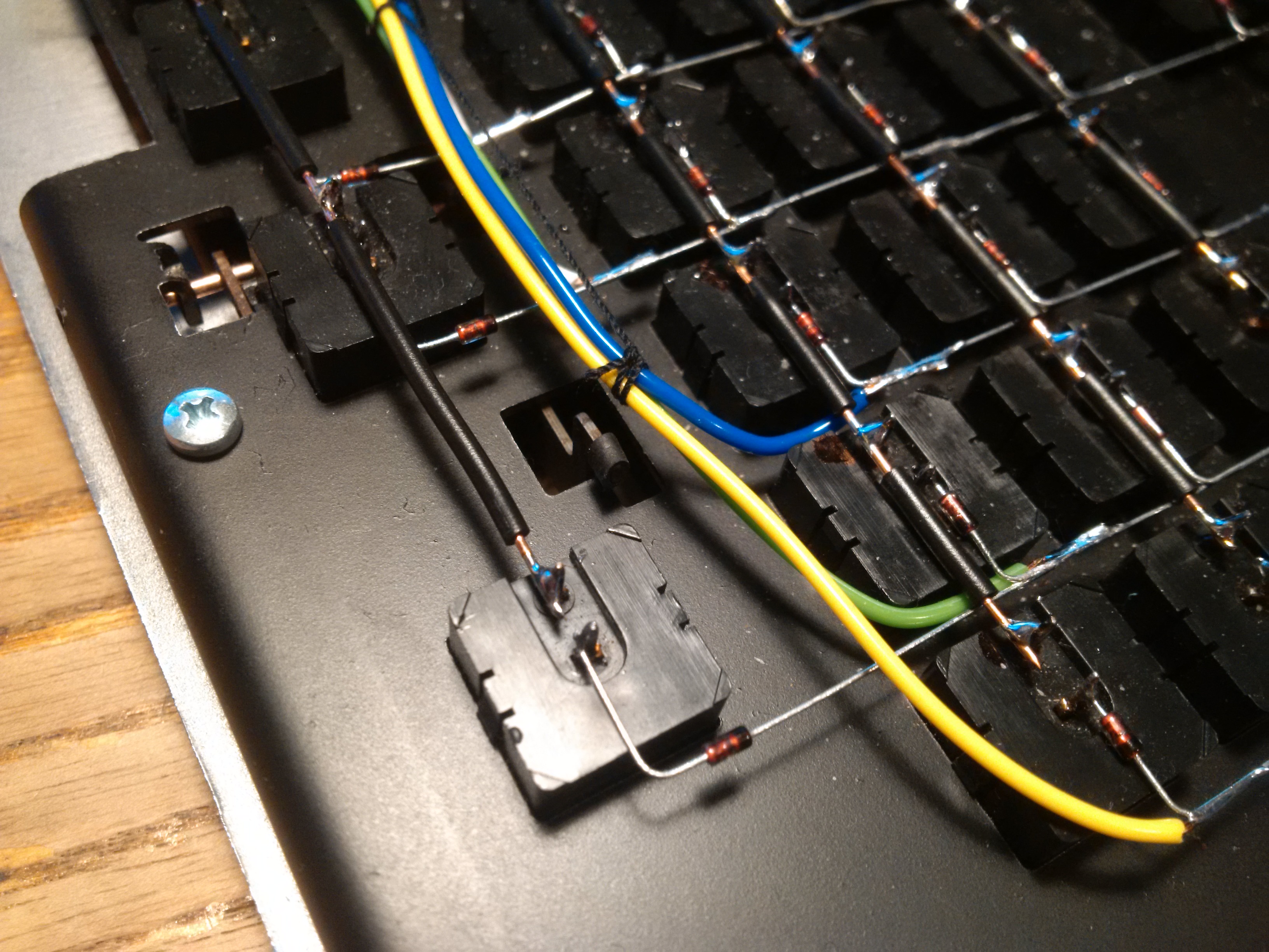

Closeup of one of the mounting points of the plate to the top of the case, enter key hinge mechanism i had to replicate and some of my wiring
(this is first time i did hand wiring of a keyboard, it took me a while to find a proper wire for the columns, that was easy enough to strip the insulation of like this - not just at the ends. other than that, it was a relaxing experience, nice thing to do in few evenings! Would definitely try it again. Also i wanted to make it look more "period correct" with the cable lacing technique that was common when a board like this could have been made.)

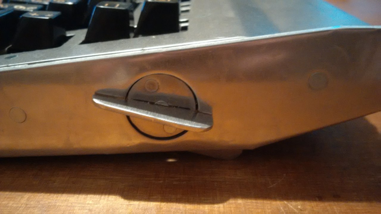

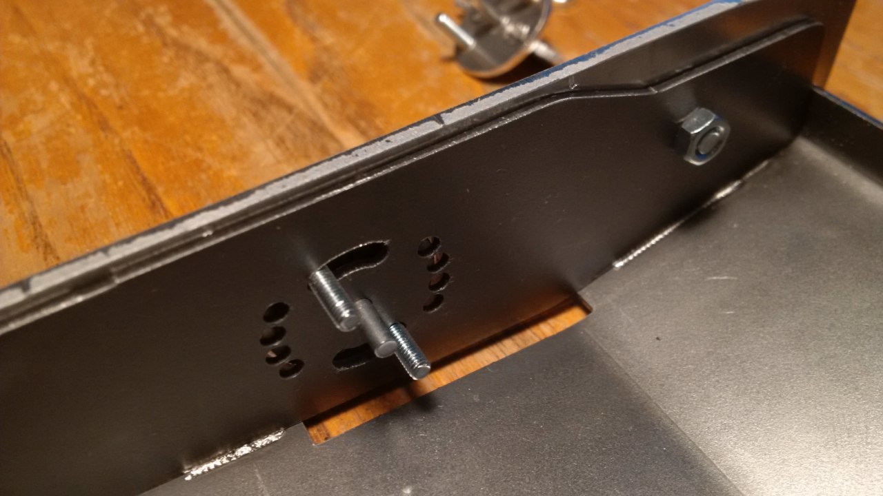

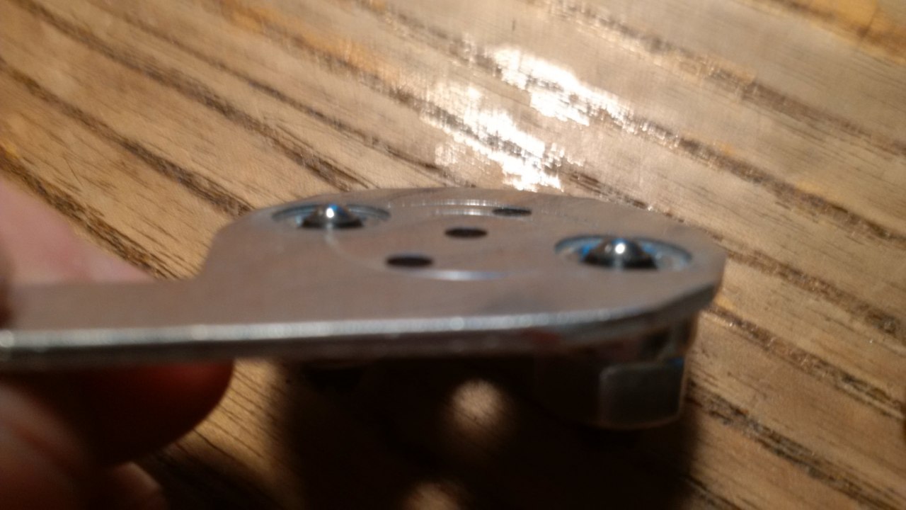

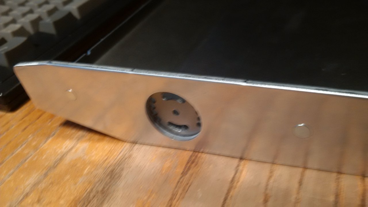

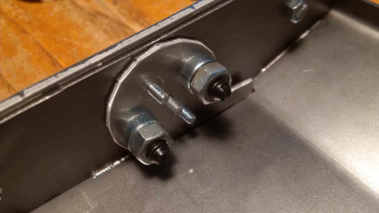

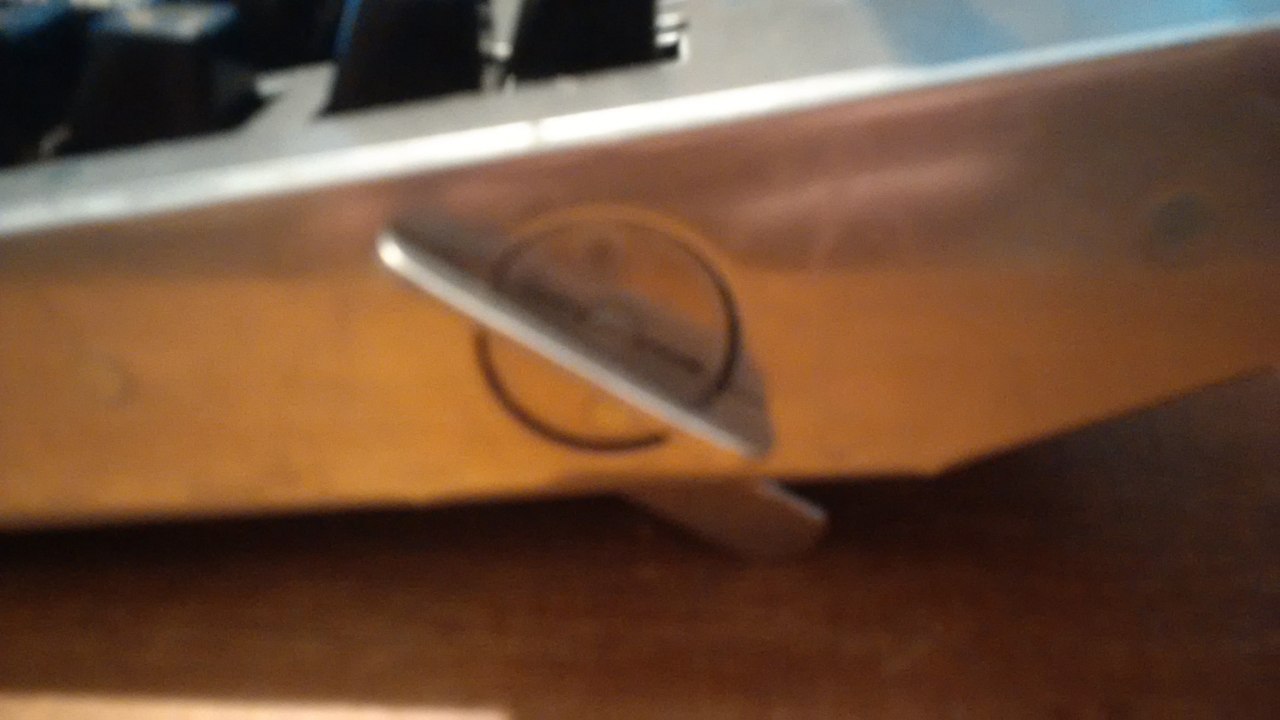

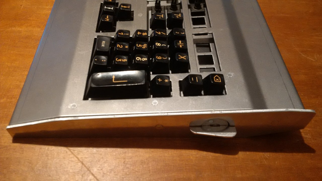

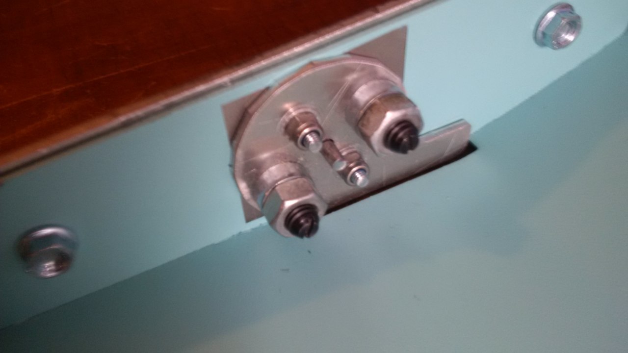

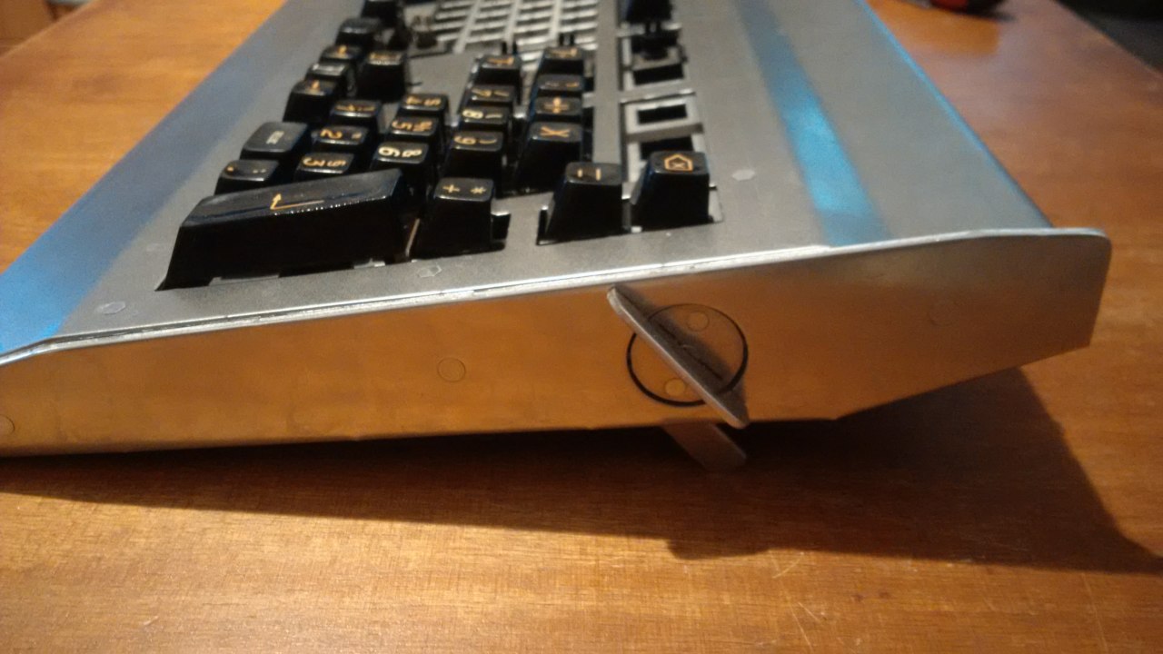

simple foot mechanism i came up with, using those spring-loaded ball studs.
photo_2025-01-11_18-40-46 (2).jpg (124.38 KiB) Viewed 24906 times
two nuts holding it together are not on this photo, but you can see where they would go, just holding the outer "knob" to the leg part of the mechanism. The ball studs click into each set of the holes in the case as you rotate the knob. those two threaded studs are for locking the outer and inner part together, and the non-threaded stud in the middle just acts as an axis. Because there are two of these ball studs, nothing rocks to one side as the forces balance each other out.
photo_2025-01-11_18-40-46 (3).jpg (123.76 KiB) Viewed 24906 times
Allows for four differnt typing angles:

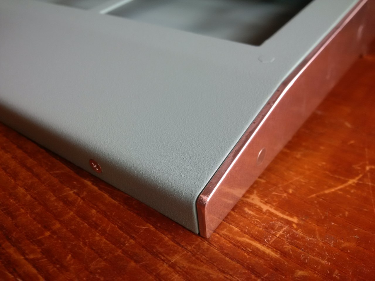

Well, i got it painted, powdercoat RAL 6027. It makes the keyboard also way less cold to touch. I went for a fine structure finish, because i'm sure a gloss one would be covered in fingerprints in few nanoseconds. The colour i'm not that sure about, but if anything - i think it would be fitting for a 60s-70s typewriter, which is what this board is about.

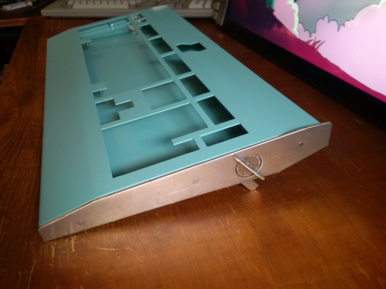

filed the radius on the side cover to match the bend as well.
this part under the foot mechanism had to be masked for painting, because i'm afraid the mechanism wouldn't work well when clogged up with paint. don't worry about rust though, it's all filled with lithium grease for smooth operation.

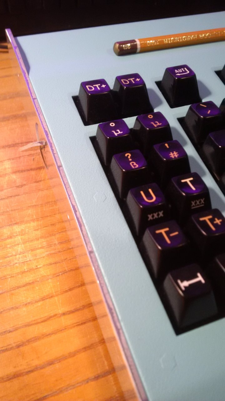

two DT+ keys. :)

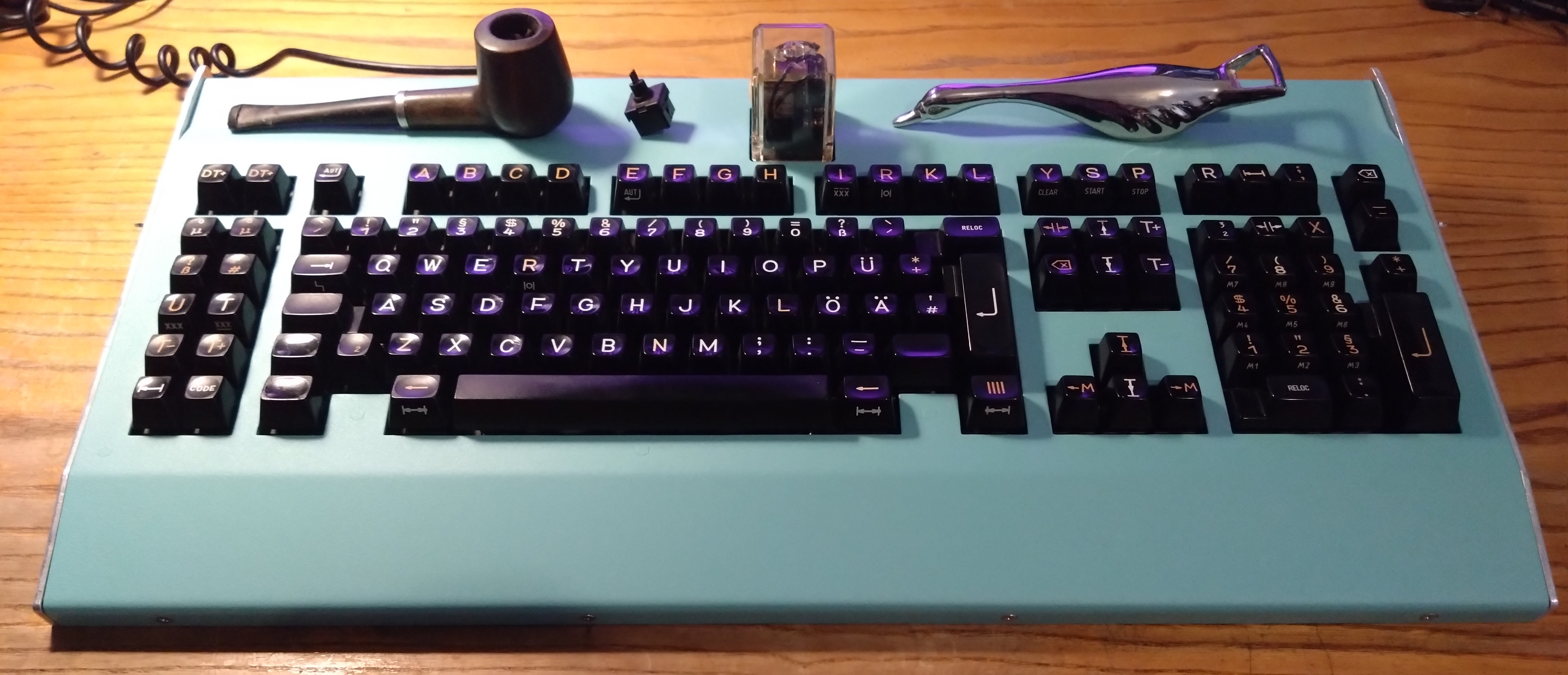

The whole thing. This is why a decent pencil tray is important in my opinion! :lol:
Now what's left to do is to try and make the re-legendable caps i had in mind for the extra function keys, and a nice badge of some sort.
