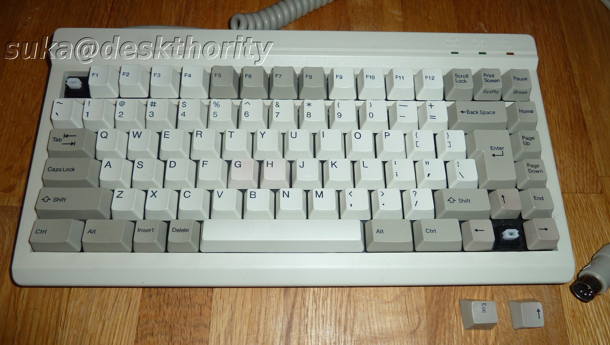

So i've been searching for more info on this keyboard and there seems to be two or three versions??
There's the one with window keys ANSI, model MCK-84:
There's one with no windows keys,ISO/ANSI?, model MCK-84FX:
Is there any difference between them, besides the number of keys, i'read about an mck-86 but i havent seen pics of it.

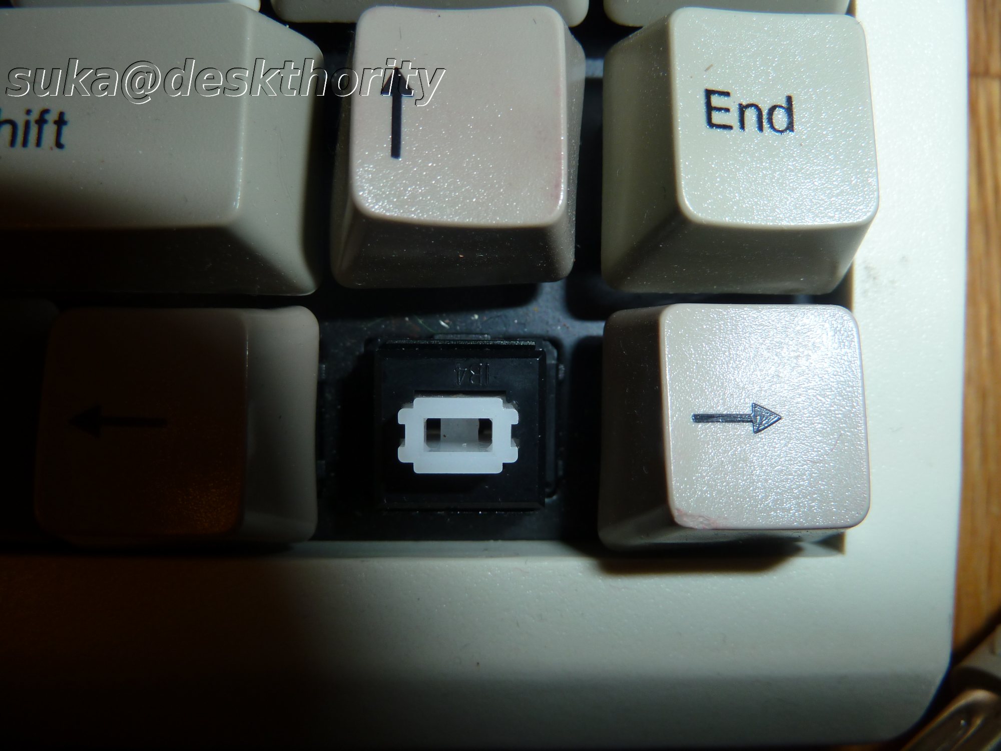

Yes i have two, but one of them had the type II/IV switches that are stiff and harder to press, so i swap them with complicated blues. The other i'm not sure but i do like them better then the one i swaped, i wonder if it can be identified ?
20 May 2013, 00:04
If you remove a keycap, it's trivial. Ortek's compact models are a bit confusing — it might be possible to figure out something from MouseFan's and Sandy's photos of them.

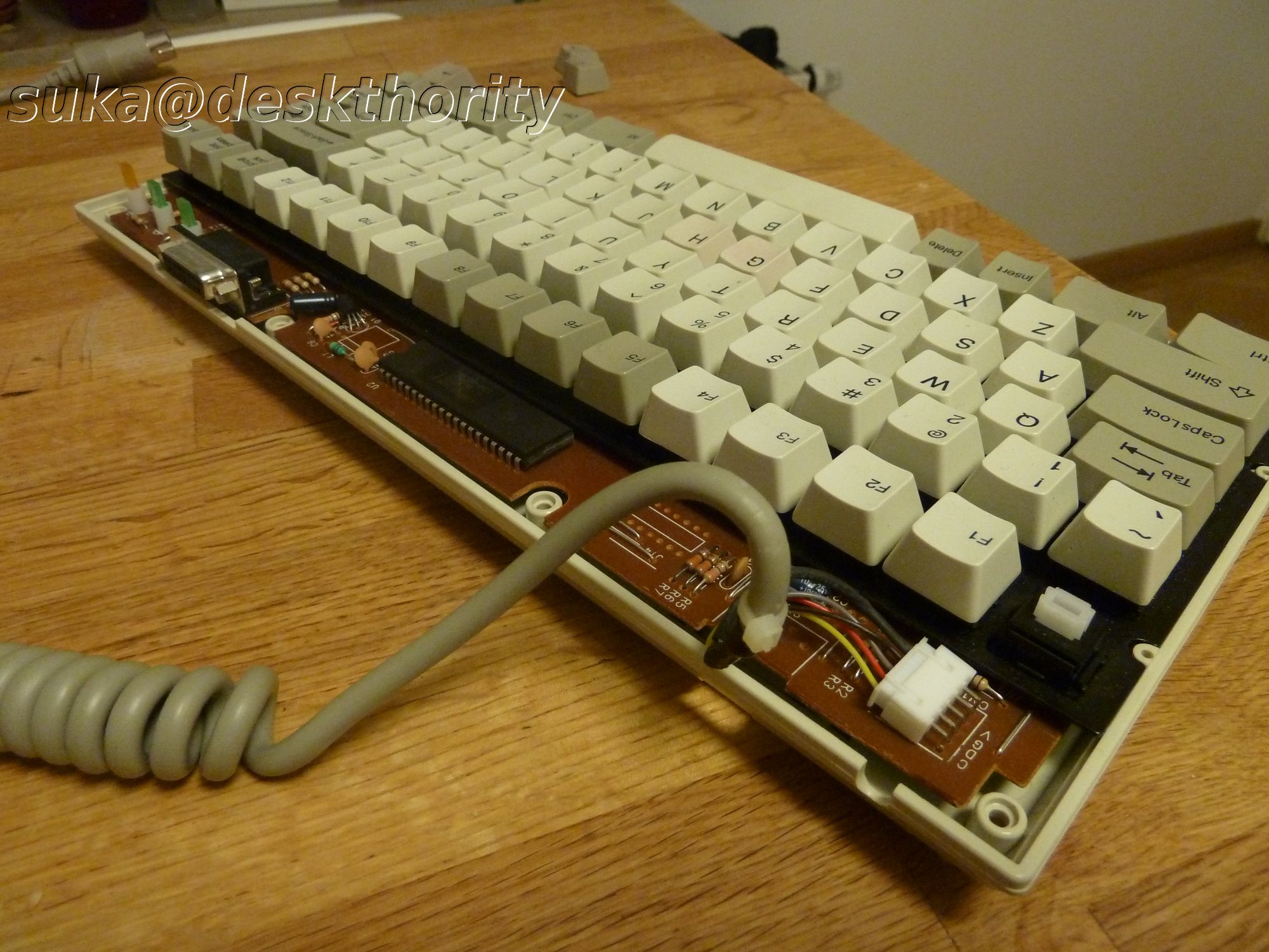

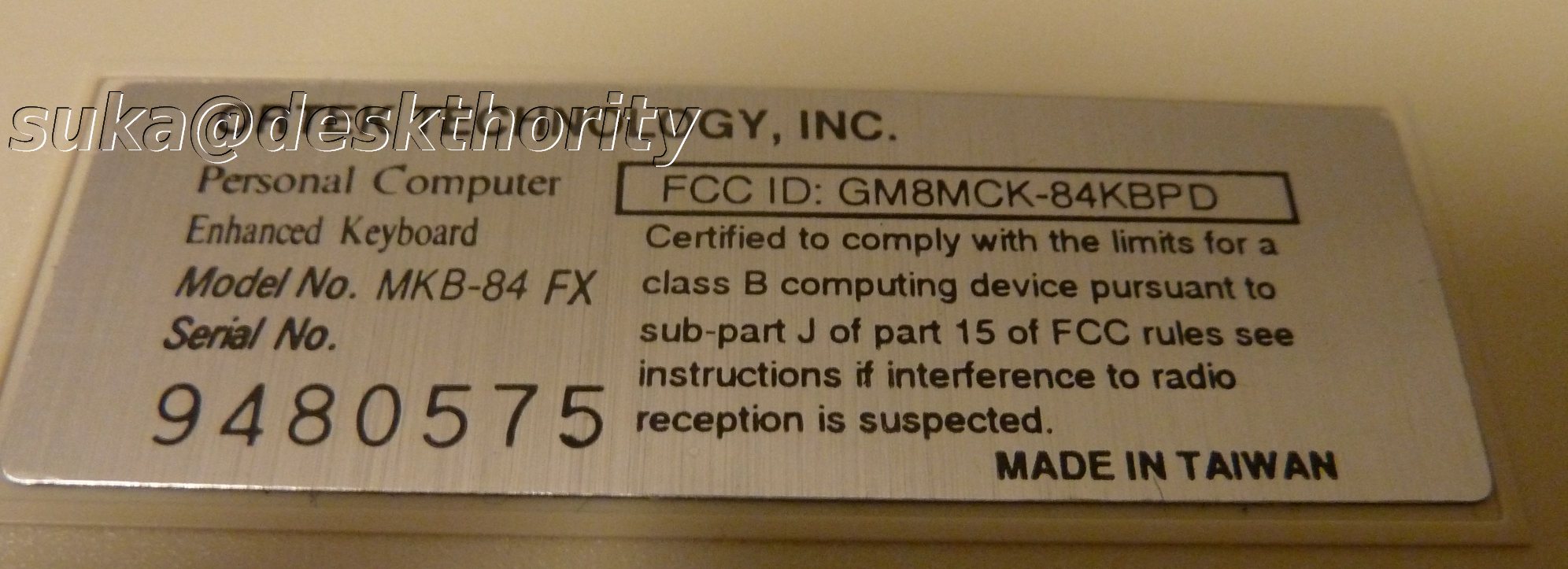

29 Jan 2014, 12:07

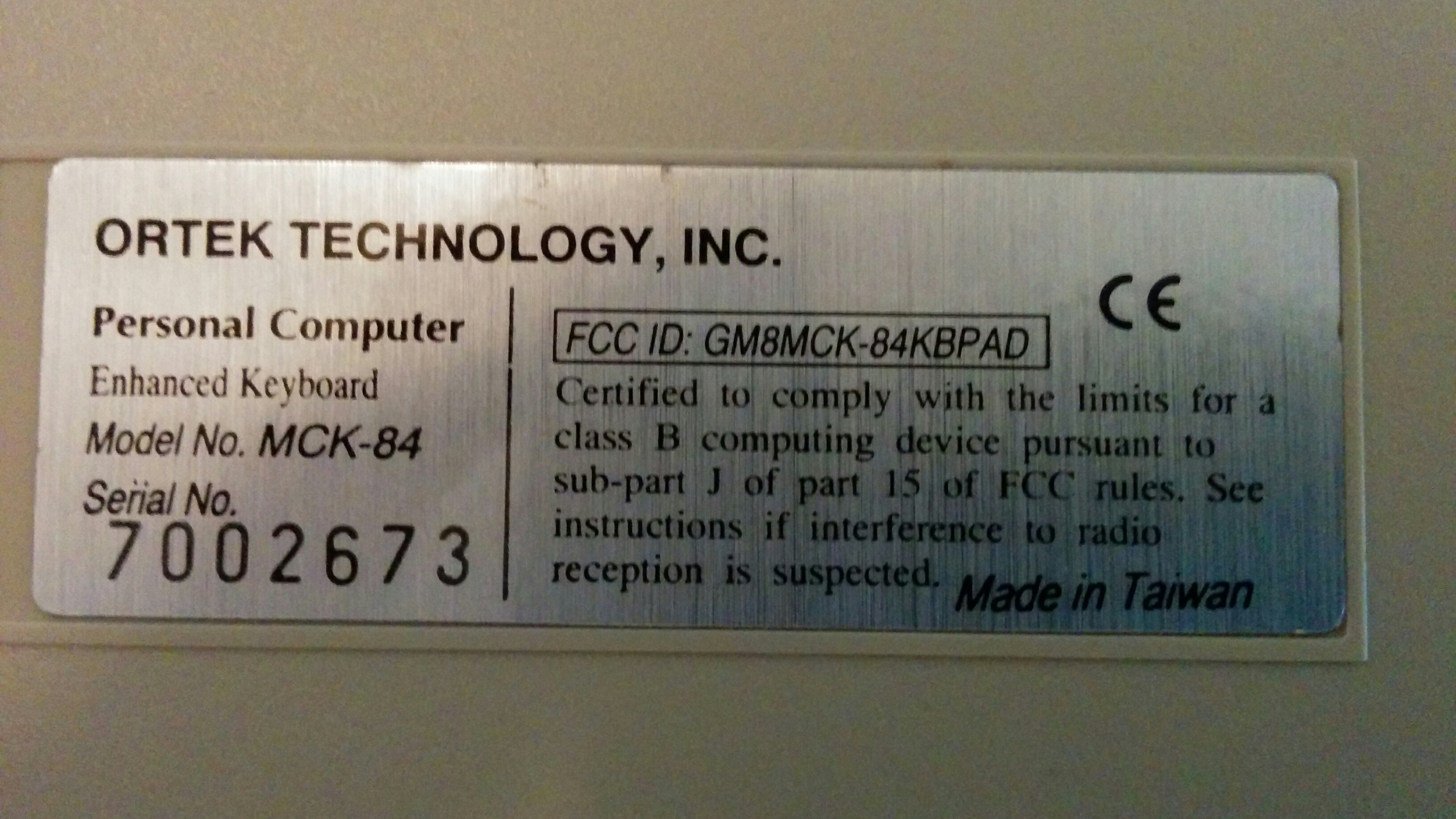

Here's another one with an extra port on the back and white clicky tactile switches I cannot identify:
Model No. MKB-84 FX / FCC ID: GM8MCK-84KBPD
MKB-84 FX
MKB-84 FX
serial & type
serial & type
Switch
Switch
Rear with extra connector
Large images here, but don't kill me for the keycap abuse - it was my first mechanical board and I joyfully threw some of them into boiling dye, which resulted in a quite individual geometric design and a piggy tint :D
29 Jan 2014, 22:26
Keycaps are probably Tai-Hao.
Interestingly, I just started a table last night detailing the switches I am assuming to be Himake/Hua-Jie AK series:
http://deskthority.net/wiki/Hua-Jie_AK_ ... Variants_2
Obviously I've got more to add to it, as well as the second table for the reduced metal variants.
The bad news is that the only way to be sure what switch it is, is to open one up, but they're a nightmare to reassemble unless you desolder the switch and reassemble it in your hand, so don't take this decision lightly.
Odds are it's a Himake AK-CN2 or AK-C2.
Never seen "MKB" instead of "MCK" before … typo, or special variant? I've had no luck getting any information out of Ortek, sadly.
28 Jun 2014, 22:41
Aha!
That rear port is for an external numeric keypad. The MCK-84 was rebadged as a SIIG Suntouch Jr. and there was an external numeric keypad for it that connected into the keyboard:
http://www.ebay.com/itm/181241268214
There are no photos left on the eBay auction but it does mention the 15-pin connector that a cached image on Google suggests is D-sub. From this topic, I am taking the Suntouch Jr. on eBay (that went with the keypad) to be the MCK-84 version:
http://geekhack.org/index.php?topic=49839.0
Edit: pinout here: http://geekhack.org/index.php?topic=13826.0
That may also explain why the MiniTouch and the Monterey-made Suntouch Jr. have modular jacks on the rear.

02 Jul 2014, 20:22
My theory:
SX = Alps SKCM White
FX = Himake AK-CN2
This appears to be the case with both the MKB-84 FX and SX, and the MCK-84 FX and SX based on what I encountered when researching them. (My suspicion is that "MKB-84" was the older name and "MCK-84" the newer name, as both have the same FCC ID and look identical.)
It looks like the two were run in parallel.

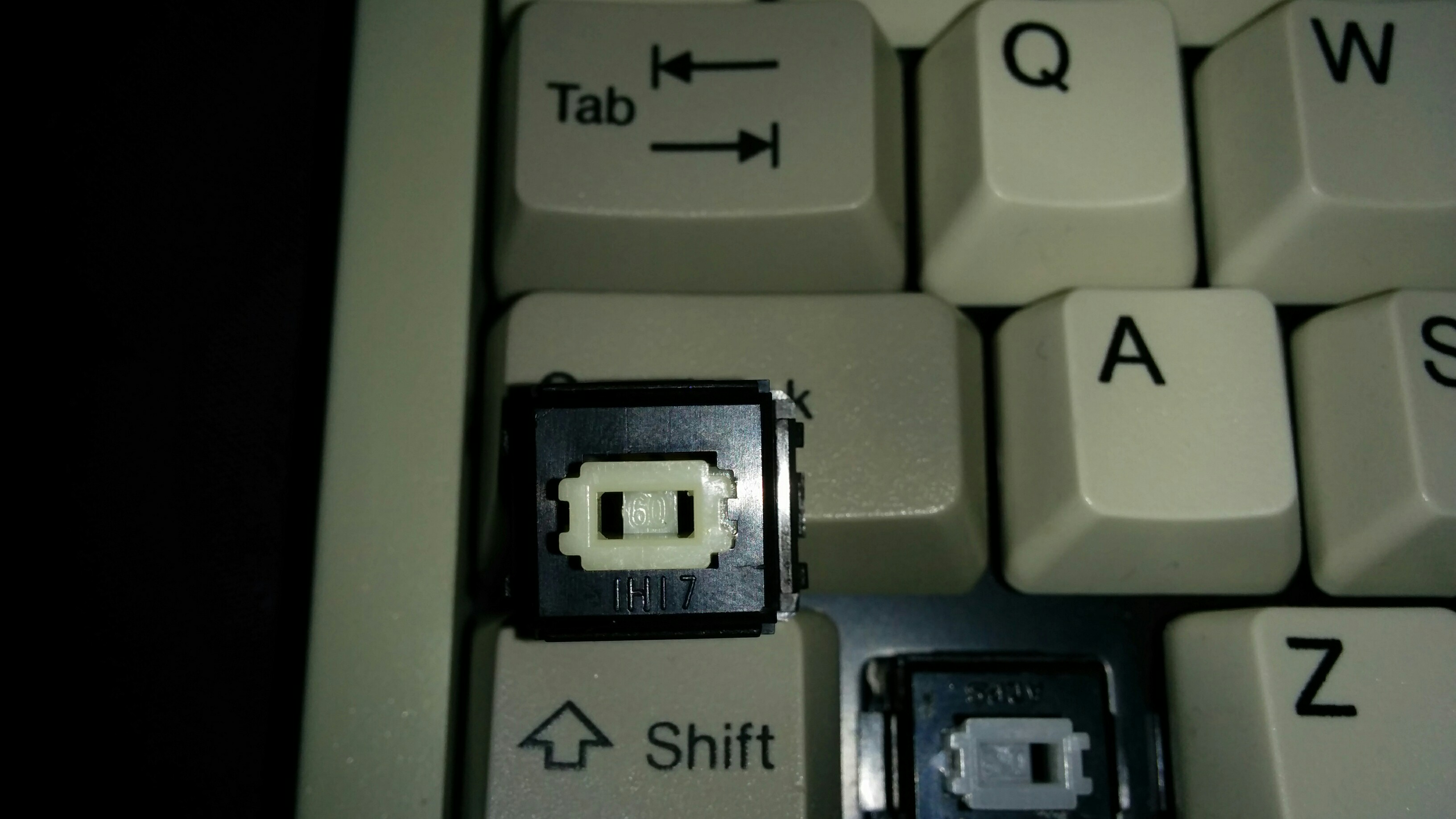

Thanks. Got a photo of a switch in your SX?
maxrunner
03 Jul 2014, 23:17
Ill dot it now. Just give me a minute.
maxrunner
03 Jul 2014, 23:21
Daniel Beardsmore wrote: Thanks. Got a photo of a switch in your SX?
switch alps
switch alps
03 Jul 2014, 23:25
Interesting, another MCK-84SX with simplified Alps. (Notice how the writing on simplified Alps was always upside down …)

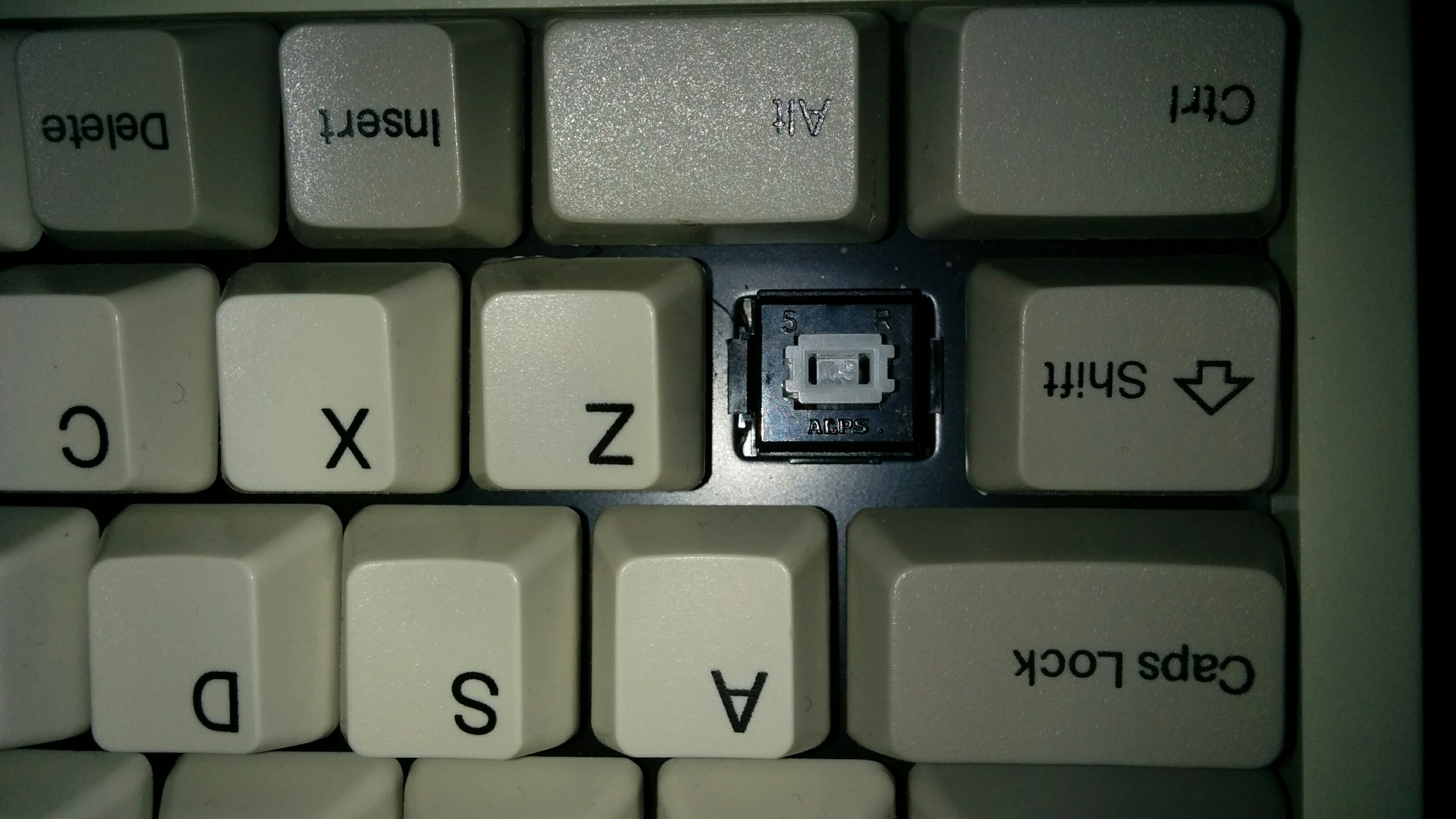

Here's the photo of the switch i had in the FX model, i didn't like it and swapped for complicated blues:
FX switch
FX switch
03 Jul 2014, 23:39
What's inside of it? There's a slim chance it might not be a type T1 switch after all.

Based on what I've seen so far, FX models are Alps clones, and SX models are real Alps. Yours was what I was expecting to see — I'm just nervous about making a proclamation based on limited evidence (that FX was the cheaper version with Alps clones), which is why every additional data point is important.
As regards the FX, my belief is that the [wiki]mould numbering[/wiki] on the top indicates a Himake (now part of Hua-Jie) switch, but the same numbering was used by a several switch types, and within each type the numbering changed with time, with what appears to be three forms used with alps.tw Type T1. The internal parts have been shared between switch makers, too, so I'm always cautious. (The evidence for Monterey switches being SMK though is now very strong.)
My dream is to be able to find out who Strong Man, Focus, ELSA Communication, Ortek, Datacomp, and MacAlly bought their switches from, as each one would be another data point for or against T1 being Himake (they all used T1 and other similar types). I discovered Himake through asking Monterey whose switches they used; the other companies have either gone bust, maintain radio silence, or are just awkward and won't co-operate.
