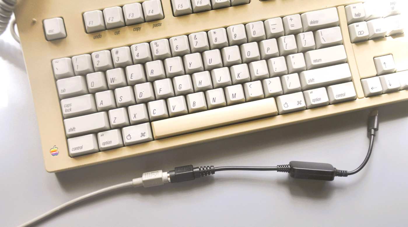

The most common Alps keyboards IMHO are Apple Extended II keyboards (M3501). These are easily available. In general, they
are fairly inexpensive. The most common ones use cream alps switches which are silenced tactile switches. Some people might find these mushy but if you look hard enough, you can find some with tactile orange alps switches.
The downside to this is these vintage Apple boards will require a ADB -> USB converter (TMK ADB converter, etc). Those are a little harder to find compared to the AT/PS/2 -> USB active converters (unless you build your own).

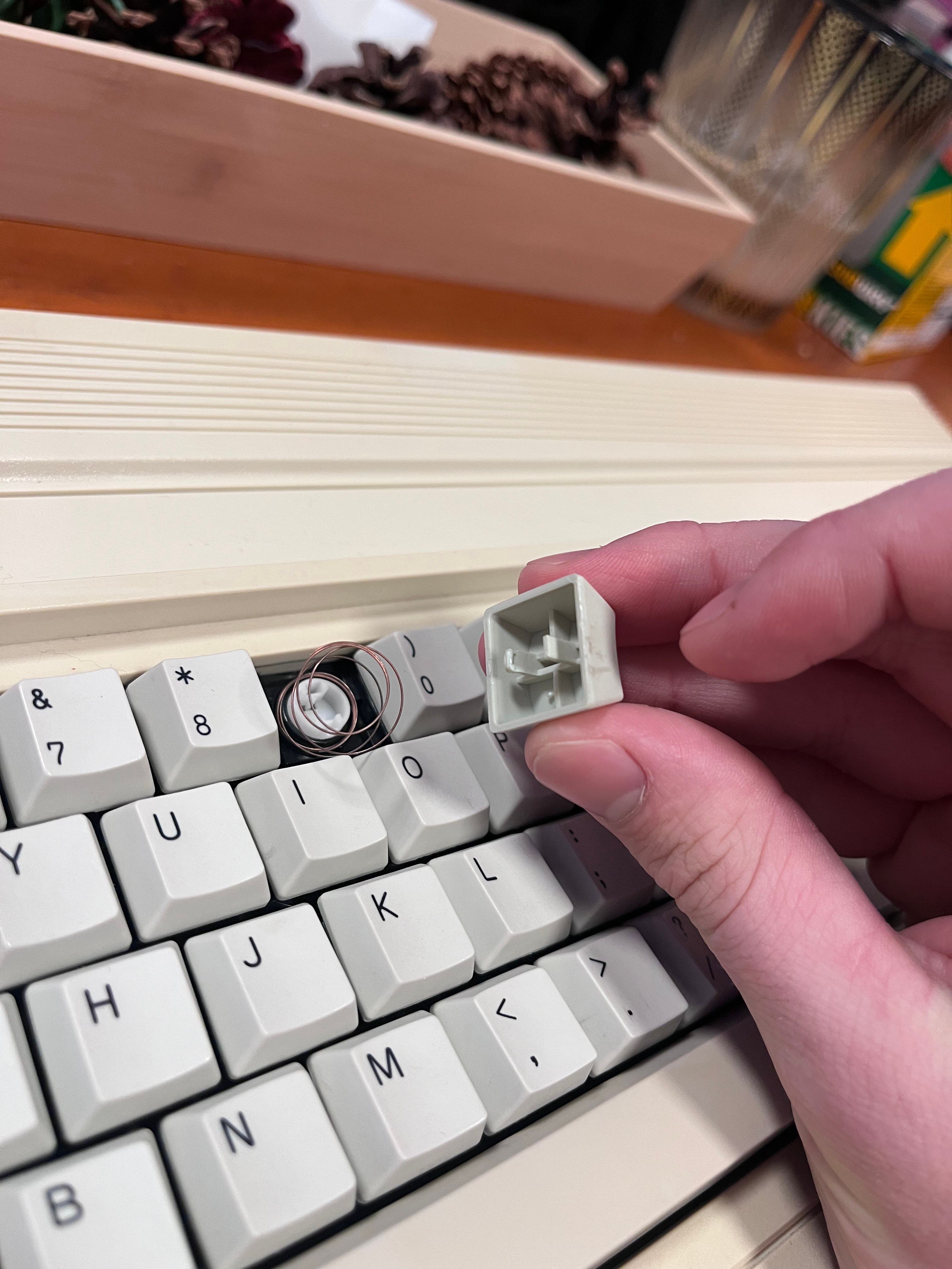

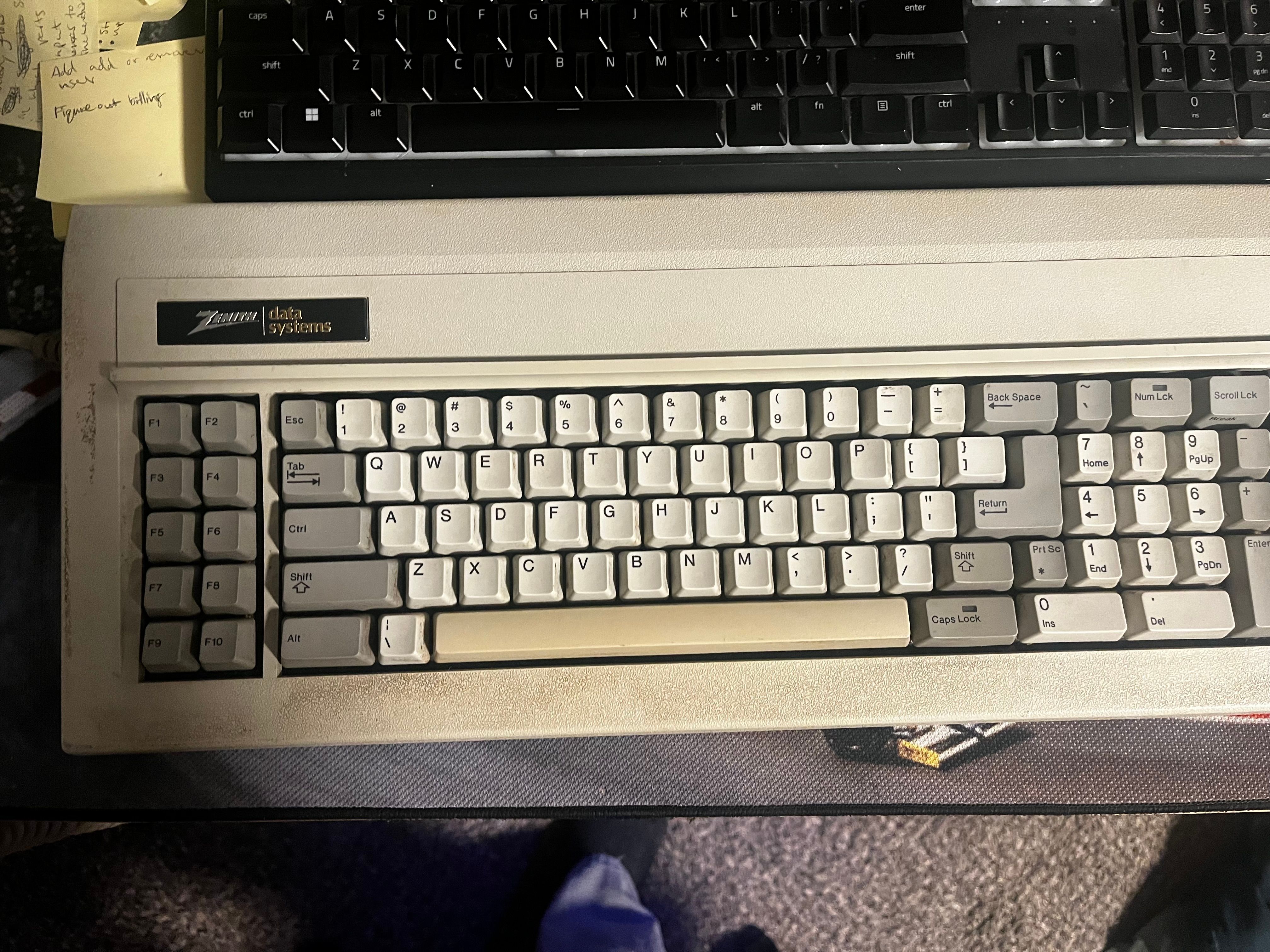

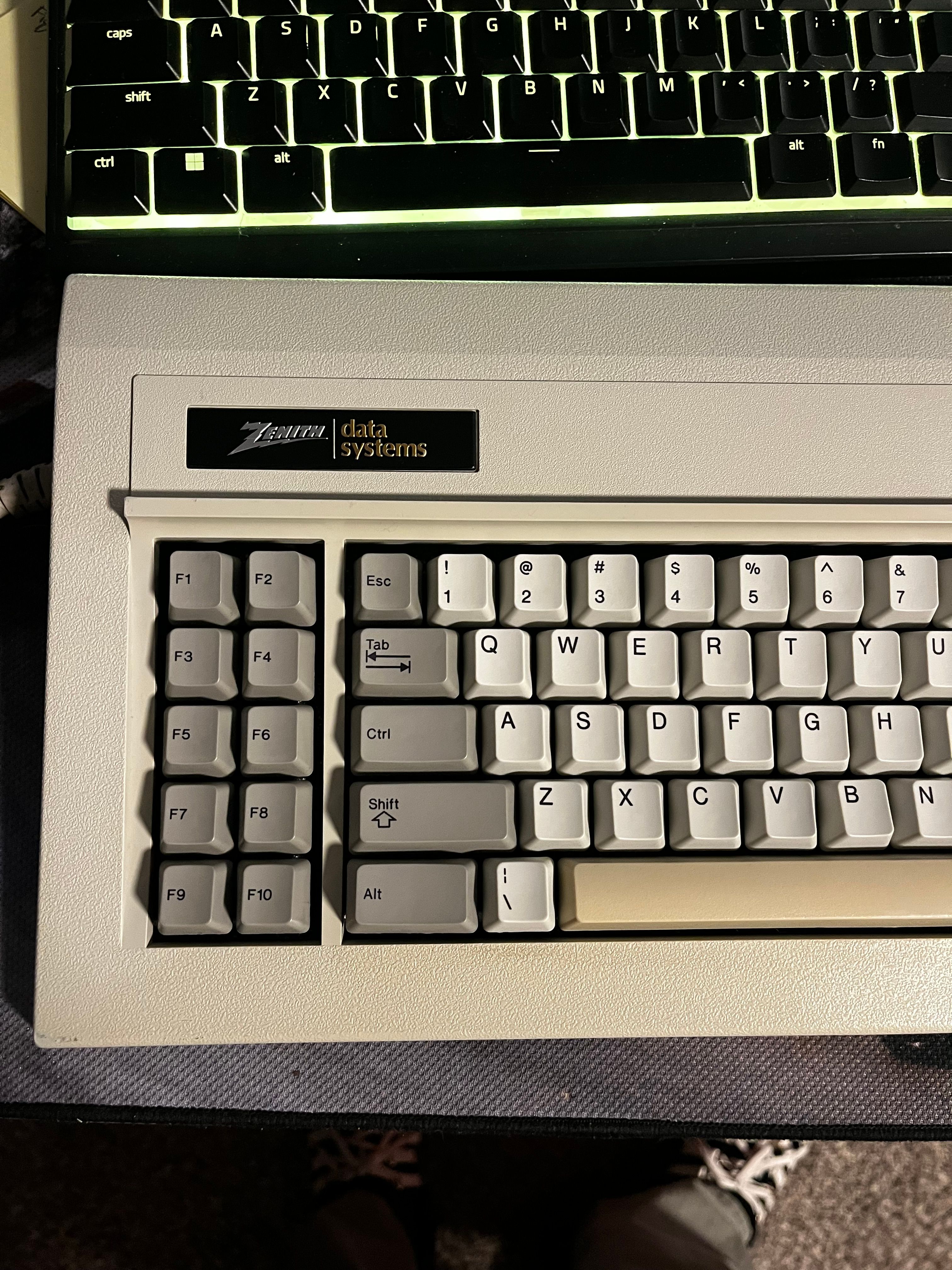

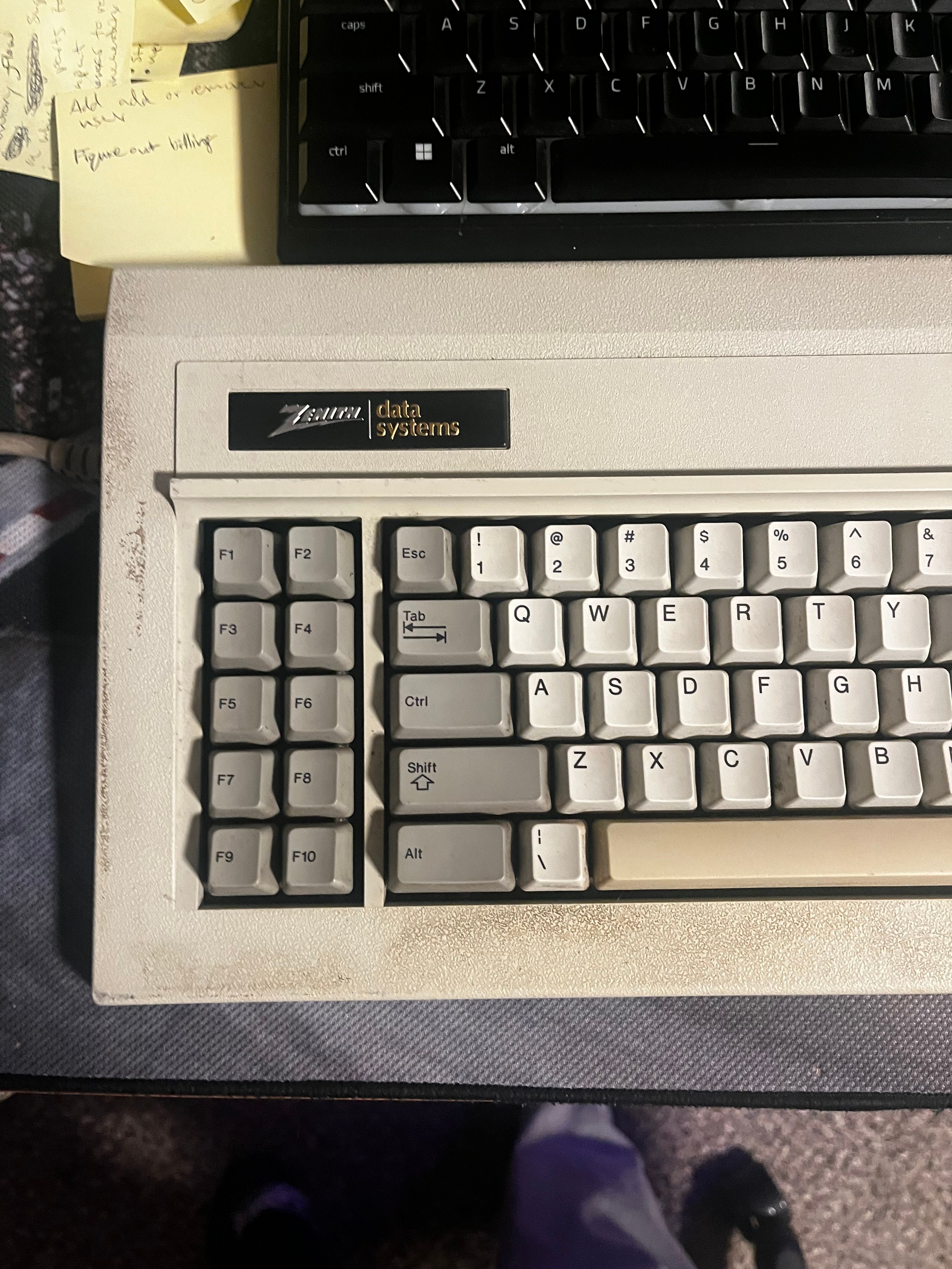

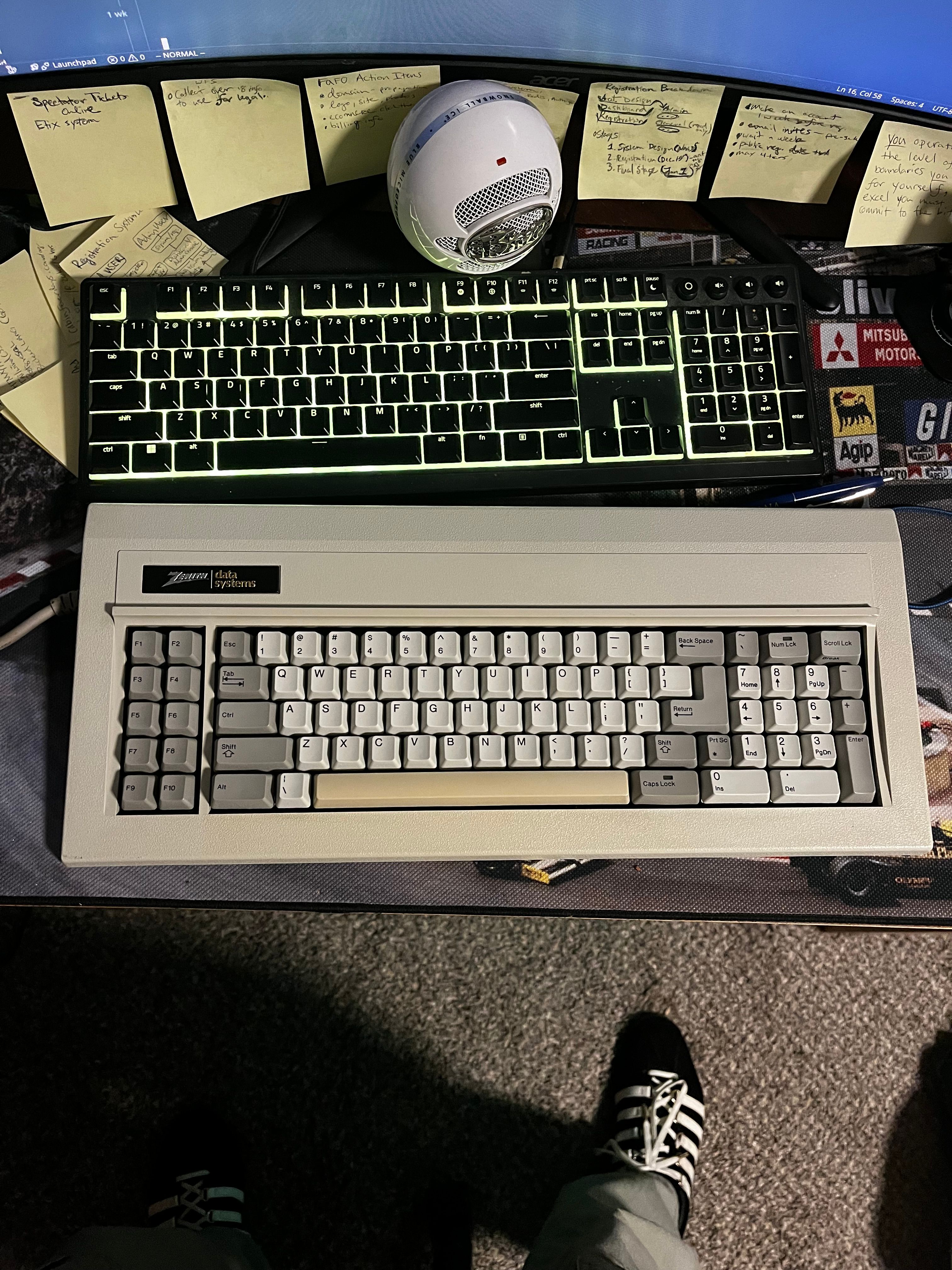

This was after deep cleaning the bogo keyboard.Based off the feedback in this thread I am also going to buy an oem Model M if I get a good deal on one (resto job probably), or an ok Model F XT and do some light remapping to make the layout fit modern needs and get my hands dirty on that side of this world modding and maintaining it! No switch is safe anymore
As for conversions I am currently following a thread on doing the XT->USB conversion at home. I bought a teensy 4.0 (amazing microcontroller btw) with some stranded wires, a couple of 1k Ohm resistors, and a 5 pin din connector. I am currently whipping up a nice 3D printed case for the whole package that will mount to my desk like an audio DAC would. I will probably crack open the soarers converter firmware that's in C and rewrite it myself so I can learn better how its handling I/O and signal conversions which would be interesting. Even if the code is literally the same I can step through each function and see how it works. Flash it to the microcontroller and see what keys don't work lol. I need to do some remapping for Linux and maybe even do some layering to get more f-keys since there's only 10 instead of 12. Would be fun to experiment with making the mapping software on-top of the firmware as the 4.0 has the beans to handle it, as long as its under 2mb. Cheers and Happy New Year!

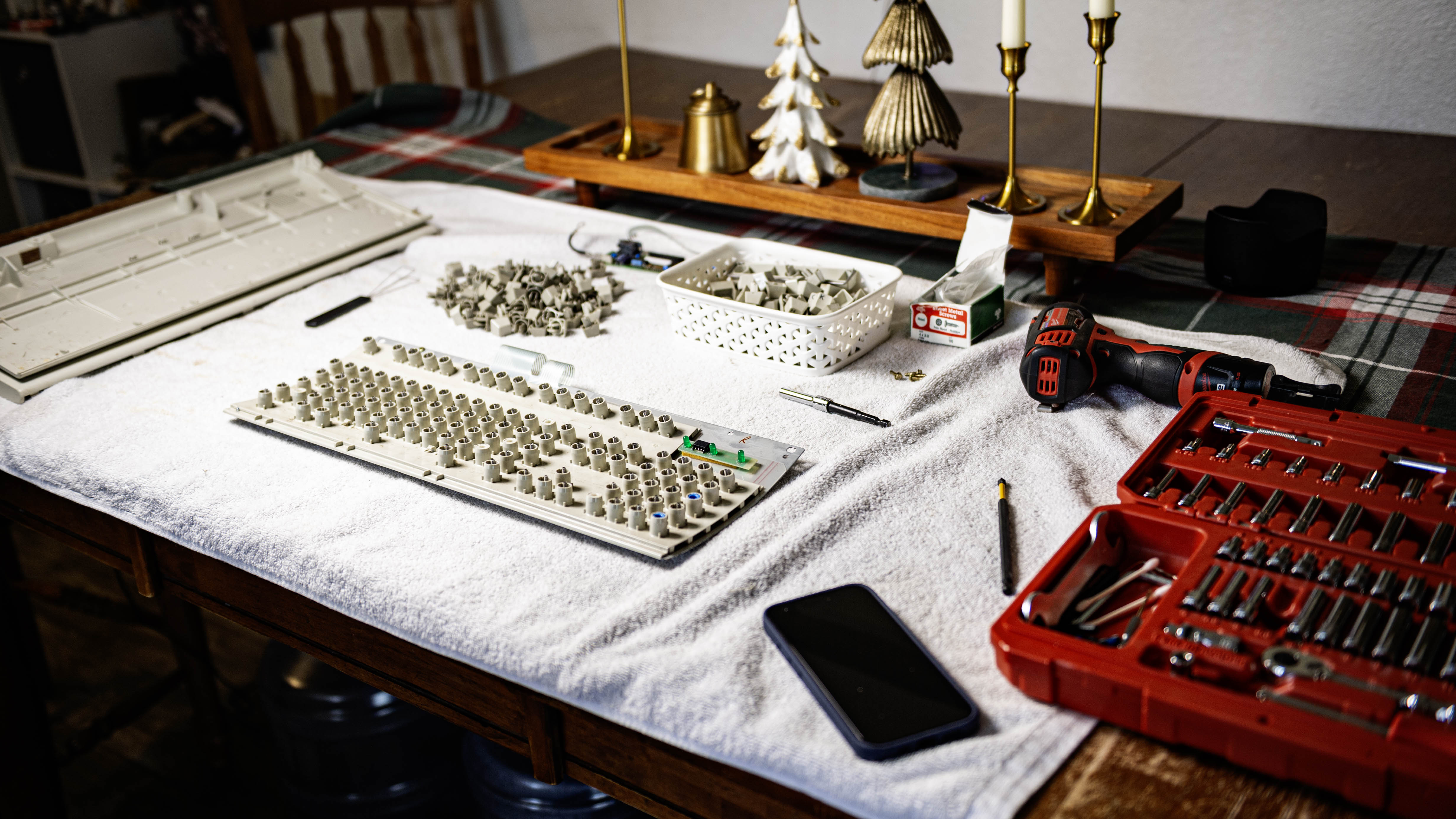

That's awesome and thanks for the pic. 100% agree with bringing the oldies back to life!Falkenroth wrote: 16 Dec 2025, 16:16 Pretty much in the same boat as you Green Maned Lion. Defiantly passed the five grand mark long ago. Twenty plus different variant model Ms and Fs. I would have to do a inventory check on my stock to know the exact amount. Haha. Problem is I say I'm done then the next thing you know I'm on ebay browsing Model Ms or Unicomp comes out with a limited Blacked Out board with black keys and I'm sucked right back in. Plus I enjoy overhauling Model Ms that have had a hard life and bring them back to their former glory.
