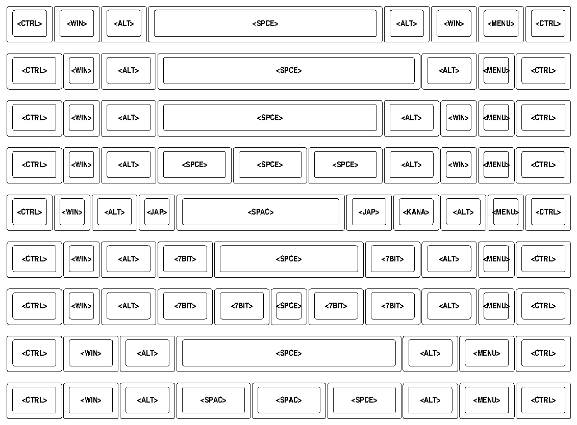

One of the more interesting subjects at hand is the spacebar row. The possibilities are endless.. and I really need input on this. There will be 11 columns available for that row (13 if dropping the 7bit extra two F-keys). Combining every theoretically possible layout will not work as well for several reasons. I think it will be possible to make the layout options very broad though. So fire away..

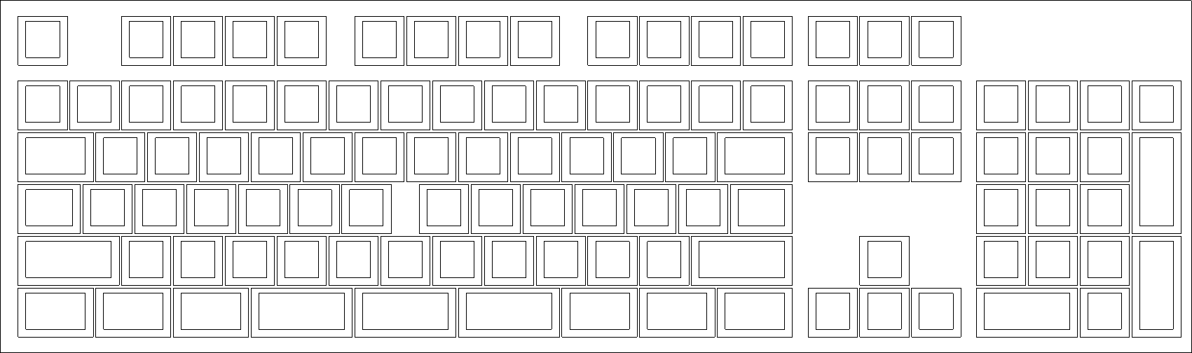

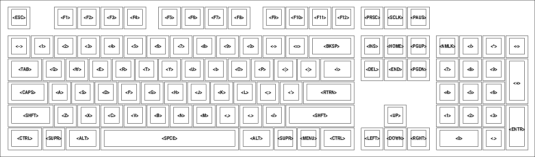

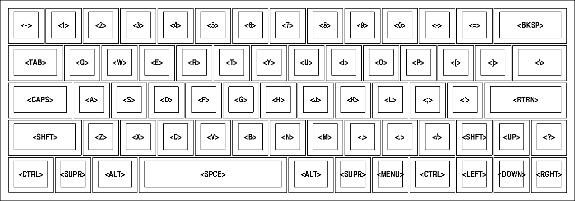

There is the standard ANSI layout of course.
Standard ANSI 104 key layout

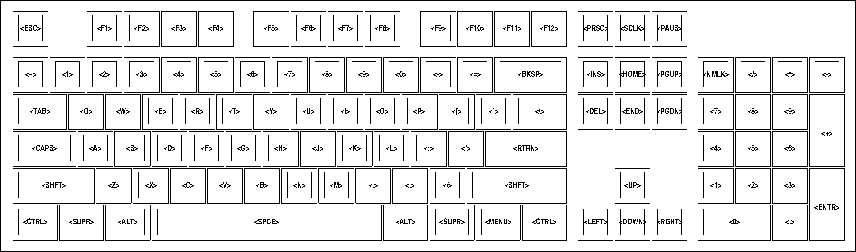

Combining rows from the standard stagger and the symmetrical stagger you end up with the same stagger as is seen on the Japanese version of the HHKB.
"Realforce JP" constant offset stagger
Using the same "Japanese" layout adding arrow keys.
HHKB layout with arrows

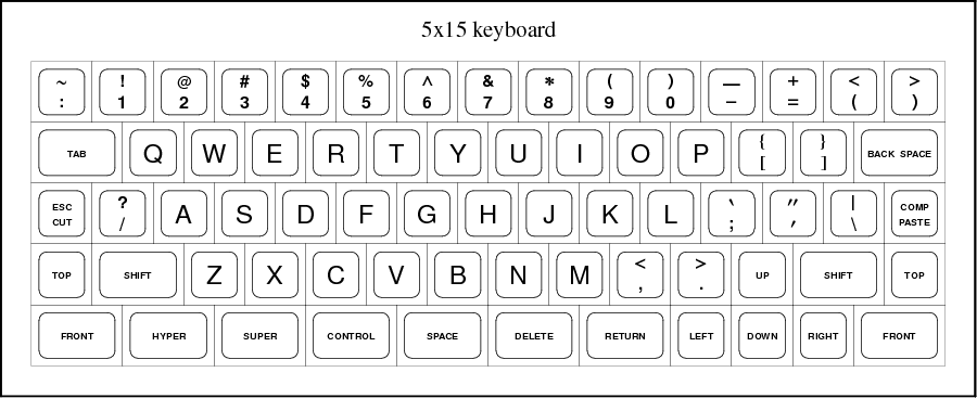

08 Jul 2012, 16:30
This is not radical enough!
Here comes my latest 5x15 design:

You really dislike stabilizers and capslock ;)
Djuzuh
08 Jul 2012, 17:03
7bit is always too radical, to the point where it doesn't look awesome anymore, just scarry xD.
I have never used a space bar this little, is it really useable?

Hmm, the 7bit hex-stagger =D That is 15 keys on the home row though. You always come up with ideas not quite compatible with what I had planned =P but I will look into it. And on a separate SFF board there would be enough I/O-pins to cover 15 columns on all rows of course.
I have a one unit wide key to the right of the right shift on some of my boards. It almost drives me crazy every time. I'm so used to shift sitting all the way out... I also like it to sit all the way in under my pinky. I could probably get used to a split shift with an up arrow in the middle though, but that is just wrong... =)
dorkvader
09 Jul 2012, 05:36
I would nominate 7bit's as the layout suggestion of the decade, but unfortunately, it still has flaws.
Firstly (and this is not really a flaw) the spacebar should be centered between B and M. This i exactly where I put my right thumb when using it, and moving it would certainly be just awful. It's easily possible to have a useful spacebar that short, especially if it's in the right place. Ideally, there'd be a second one for the other thumb, but that's just preference.
Secondly, there's no reason for the up arrow to be on the wrong side of the shift. It' just makes it harder to hit. I don't know if you ISO type are used to reaching over extra-far or something, but as a habitual ANSI'er, I like my right shift to end where it does. I only hope that I'll start so use it properly.
Also, I don't know about the extra "hyper" modifier. I'd prefer a "fn" button for another (navigational, most likely) layer. I know I'd use "home" and "end" a lot more than "front" (unless "front" is "home").
Dedicated cut and paste keys are great. That's almost the first thing I added to the Cherry G80-8113 I just got (thanks Reptile!).
Were I good with a graphics program, I'd fix the layout for him, but alas, I have none installed. It's a step in the right direction, what with the split spacebar, and the numerous thumb keys it provides, though. That would make one heck of a decent "small keyboard"

Here are some pretty standard spacebar rows that are out there on commercial boards or that I (or 7bit) thought up myself.
Spacebar row layout ideas

09 Jul 2012, 15:39
I don't know about others, but I tend to press the space bar with my right thumb in the area below N and M - sometimes more under 'N' and sometimes more under 'M'.
I am also very much used to the right Alt (Alt Gr for me!) being below , (comma). I think that I could live with a one-unit key in-between right Alt and the space bar, but that's it for extra keys on the right. I would vote for space bar options 1, 3, 4 and 5 above but not for any other.
BTW, I am planning to use option 3 on my Phantom, with a modified plate. Thanks again to PrinsValium for having added the switch positions to the PCB!
bpiphany
09 Jul 2012, 15:55
All the space bar rows in that picture are pretty much for sure going to be available. Number 5 with the JAP key is as I understand it the Filco Japanese standard and will be a top priority to include. 7bit not so much because I am particularly fond of it as because of... ehmm, "historical" reasons... But I want MOAR!!1 more alternatives you would like to be included.
