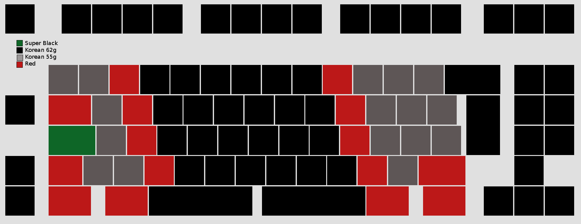

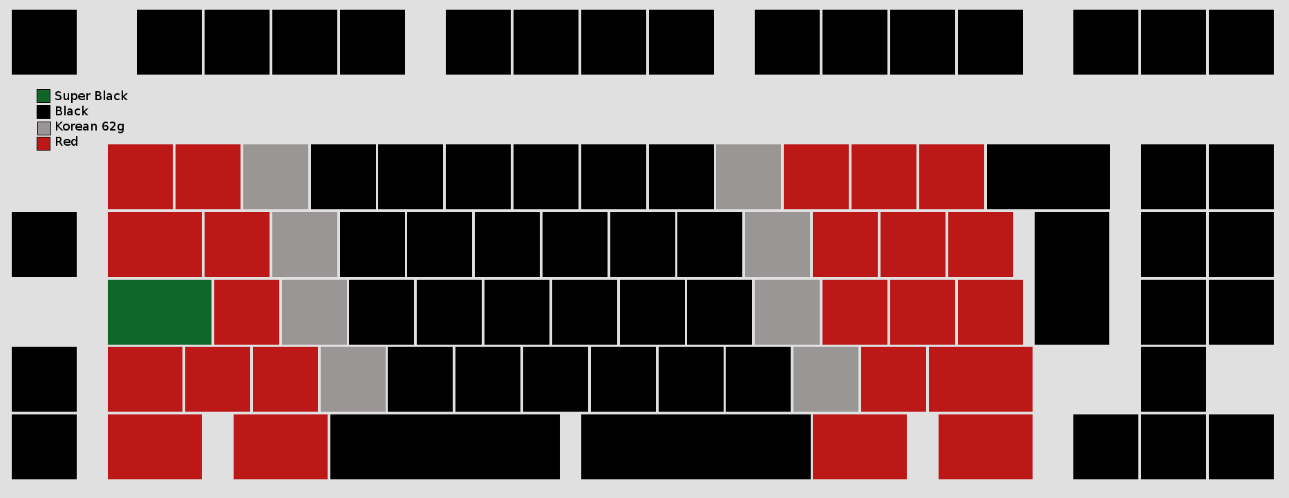

fossala
Elite +1
20 Sep 2012, 17:08
How about this? Should work.
Jim66
20 Sep 2012, 17:11
Do the grey steps have a tactile bump like clear? If so, I would just stick to red and black linear.
I think it could work really well.
fossala
Elite +1
20 Sep 2012, 17:12
No it will be the non-tactile grey switches. Exactly the same as red/grey. Just thought it would help me to remember what is under each switch.
Also put a "super black" under the caps lock, that should help accidental miss-presses.
HzFaq
20 Sep 2012, 17:16
Why not mod it to CTRL/backspace or something?
http://deskthority.net/workshop-f7/rema ... tml#p14552
edit - Layout looks good though, I'd look at another row of "greys" personally but see how it goes I guess.
