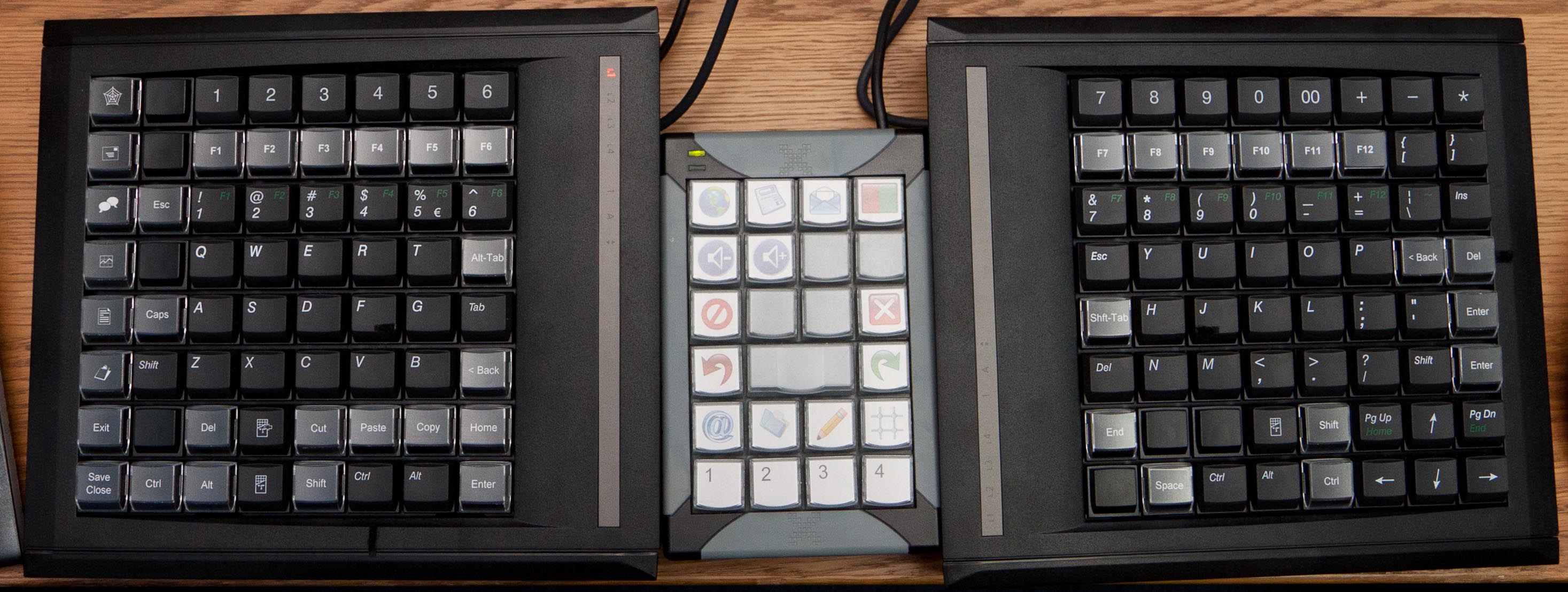

Here are some pics:
Not sure yet if I'll take out the X-key device in the middle. It has one major advantage: keys can be programmed to be application dependent; so they act differently depending on which application is active.

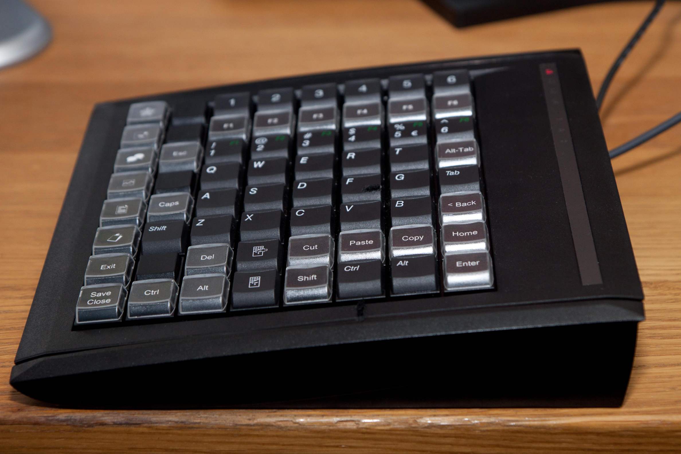

I have placed the modules sideways to create a bit of tenting. Keeping them in the original position (higher end towards the monitor) would probably not be very ergonomic. Unfortunately, the Changeme utility doesn't allow me to match this position onscreen, so programming the keys is slightly more tricky. I have added about one cm of lift in the back (i.e. lifting the numeric/function keys).

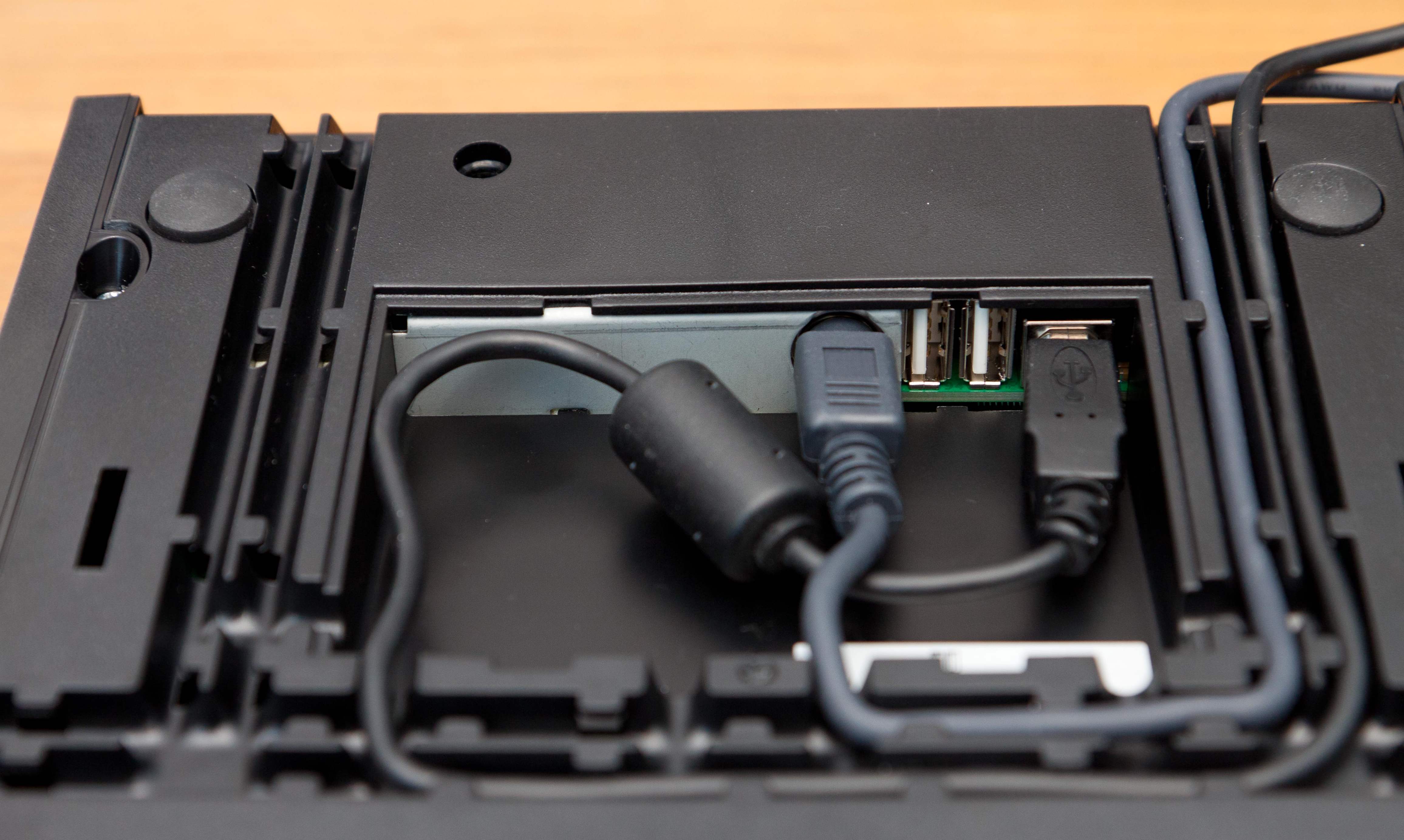

Here's a pic of the USB module in the master module. You can also see the cable management grooves in the back.

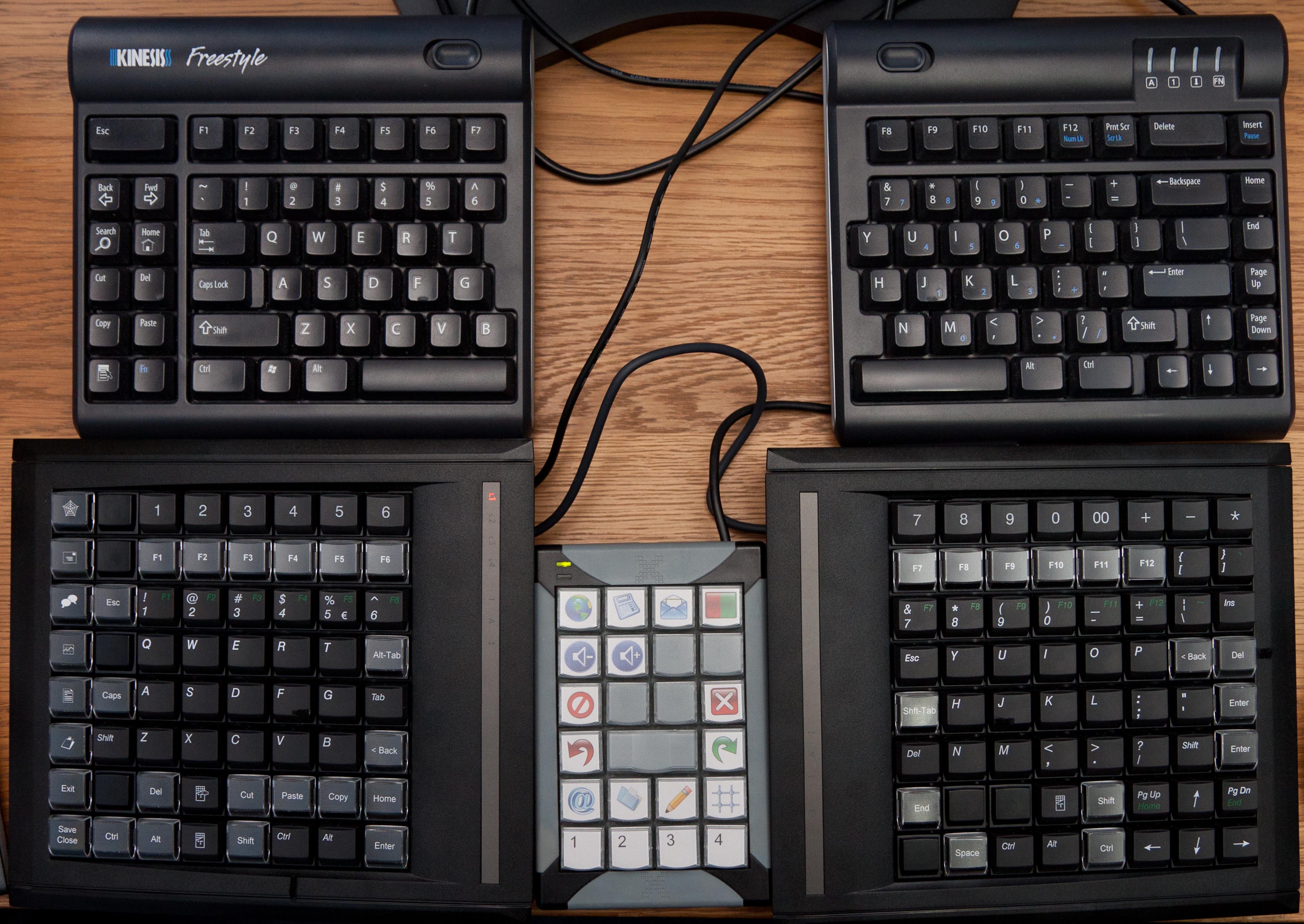

Here's a comparison with the Kinesis Freestyle. I noticed that I tend to separate the FREE modules more than I would with the Freestyle, mostly because of the matrix layout of the FREE modules. As a result, there's not a lot of room left for pointing devices to the side.

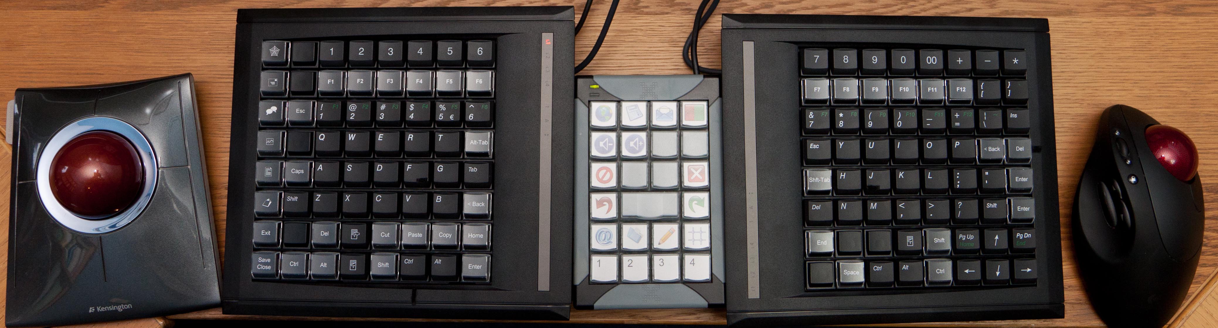

I use trackballs.I believe this workspace would be too wide to combine with a mouse. Theoretically, you could move the modules closer together, but ergonomically that seems unwise given the matrix layout. Originally, I had intended on placing the Kensington trackball in the middle. Keeping the trackballs on the sides works, but barely. My arms point slightly outwards when I use them.
