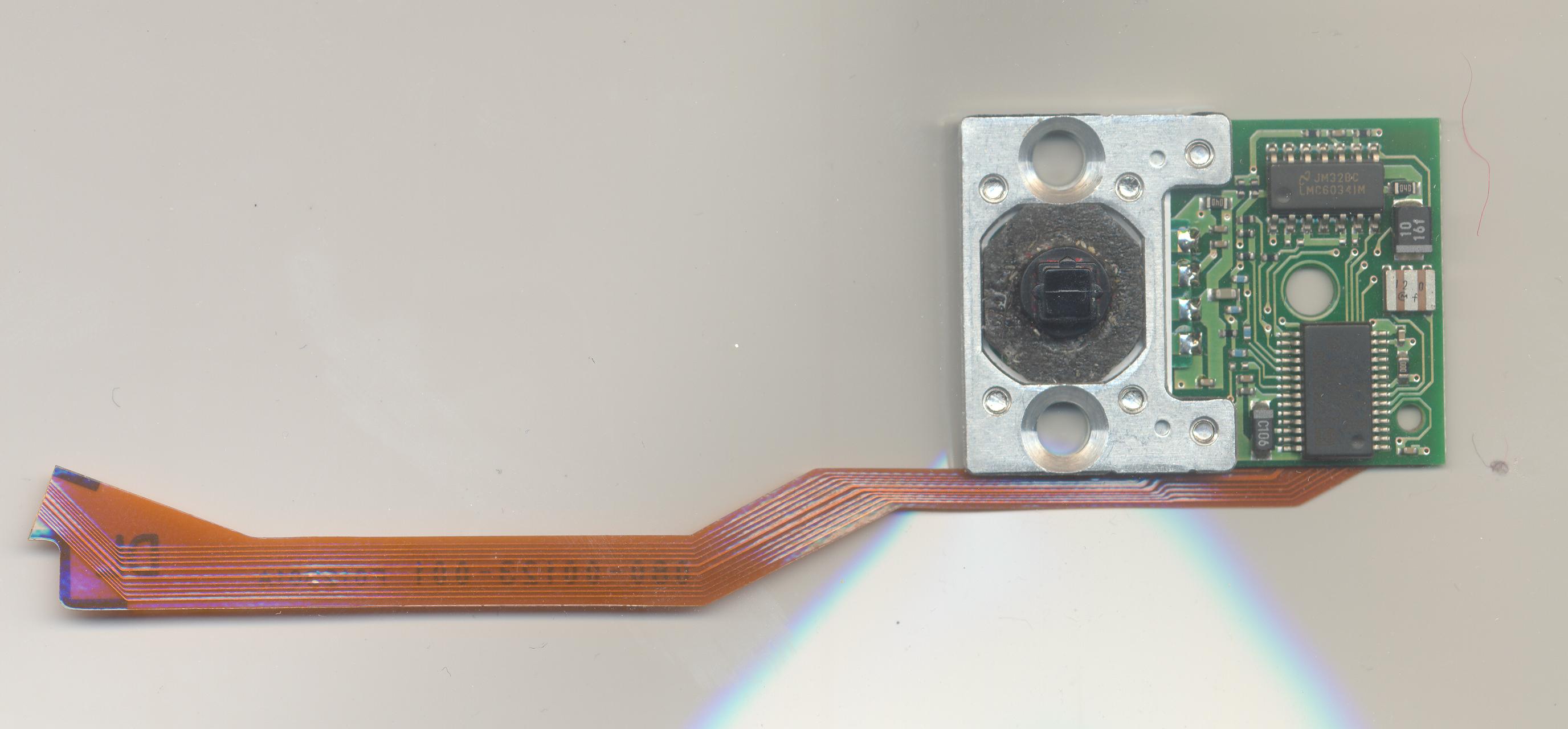

i harvested a trackpoint from an old IBM laptop i was disposing. i know i will never use it, but thought that someone from the community might. if you would like it, send me a PM.

LOOK!!!!
I think it has it's own pcb like the KPD8923...this helps.
Any help or info on what this part is from the IBM Thinkpad...
Translation would be the bomb!
http://alpha.mixi.co.jp/2011/10803/

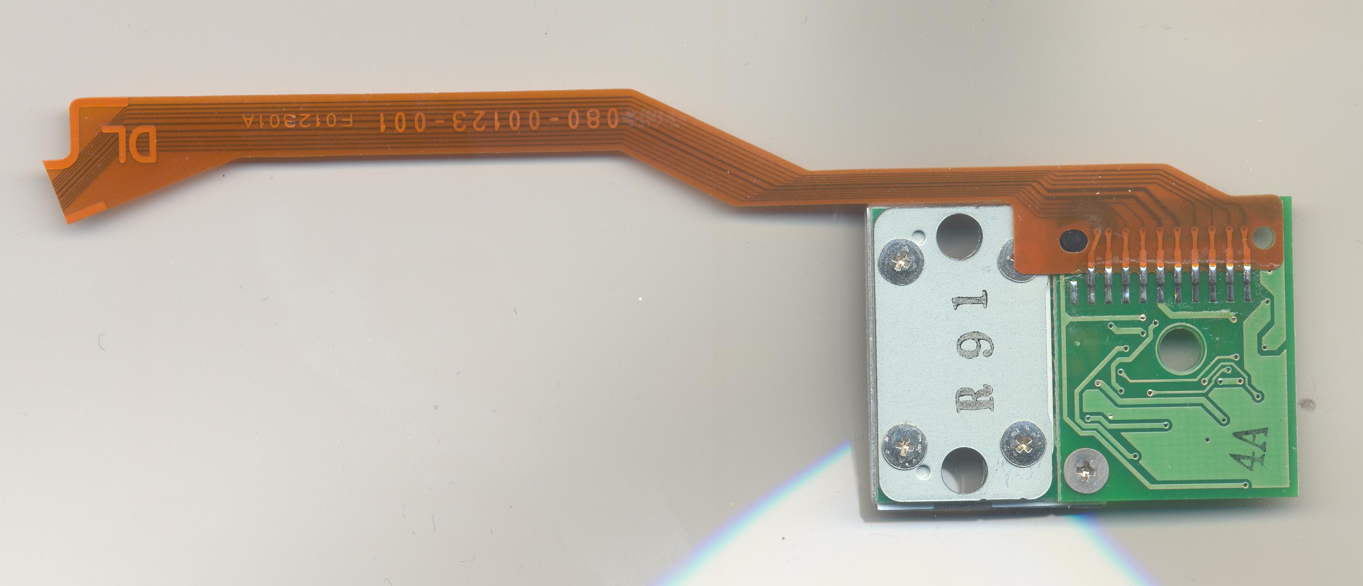

So 4 of the 10 contacts the ribbon connects to, are the 4 usb wires (or ps/2). Those would be the only connections needed.
Am I seeing/understanding this correctly?

yes, i believe that 4 of these are PS2.input nirvana wrote:So 4 of the 10 contacts the ribbon connects to, are the 4 usb wires (or ps/2). Those would be the only connections needed.

Wcass sent me the trackpoint shown above from an IBM G40.....2388-BBG (Thank you!)
At some point, I'll find the pinouts, maybe test with a meter, solder intermediate connecting wires directly to the pcb, and then to a passive ps/2>usb adapter which will connect to a 4 port usb hub located in the Kinesis. Locate the 3 button connections (I know each button has 2 wires...the buttons must just be contact switches). The other 4 wires are the ps/2 connections.
Of course, that's assuming Mac OSX will have no issues with it, just like the trackpoint from the KPD8923 is problem-free.

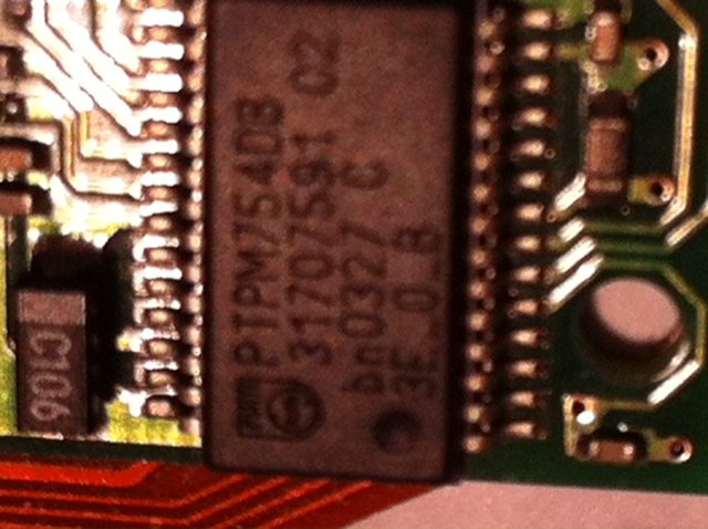

Looks like a PTPM754DB just like in Icariums datasheet link...not that I'm familiar...I'm not an electronics guy.
So according to some schematics, I'm thinking this is a Trackpoint IV, with firmware 3E.
I noted on Icariums photos, he had 7 wires (4 for the ps/2 and only 3 for the buttons, not 6 for in/out buttons?)
So maybe the 10 contacts to the ribbon are the same?

In case you want to cross-check, I have two other trackpoints documented in my DIY project that use the same chip.

Thanks you guys...looks to be very similar. I've taken a look at the data sheets and the links to posts and pics. I feel confident that the pinouts may be the same. I already figured the 2 middle pins were for power and ground since they had the larger traces...and that matches your pinouts. I don't think I can go wrong as long as I have power and ground.
So for the 3 buttons,there is a wire going to each contact switch, then the other side of the switch goes to any ground, correct?
What is the 'reset' for, and what will it be connected to?
