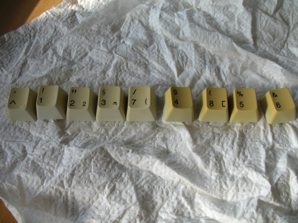

I pulled out a white Filco today (the "original" Otaku), and I was shocked. Slight yellowing! It has been in a box!
In original state:
In original state:

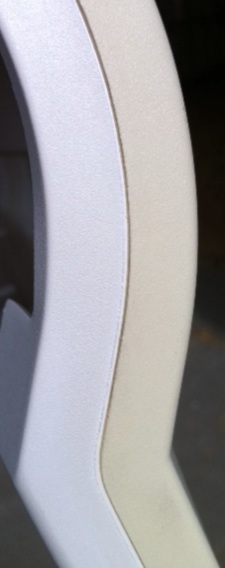

TAKE BEFORE AND AFTER PICS!!
No one believes until they see.
Kinesis top case in oxy-clean and water ONLY, bottom case untouched.

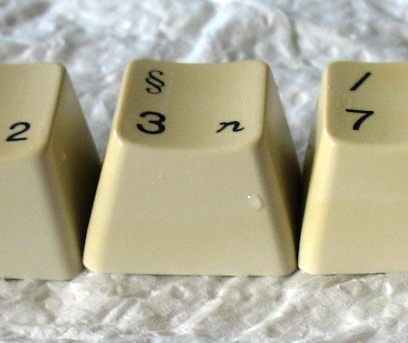

so after a couple of days in, what I would call, English weather there is some noticeable progress
you can see the edge of where the stuff was applied
but overall I have to say, that, while it is good for
-availability
-price
it sucks for
- handling
ps.
these are printed focus key caps (just like yours)
-availability
-price
it sucks for
- handling
ps.
