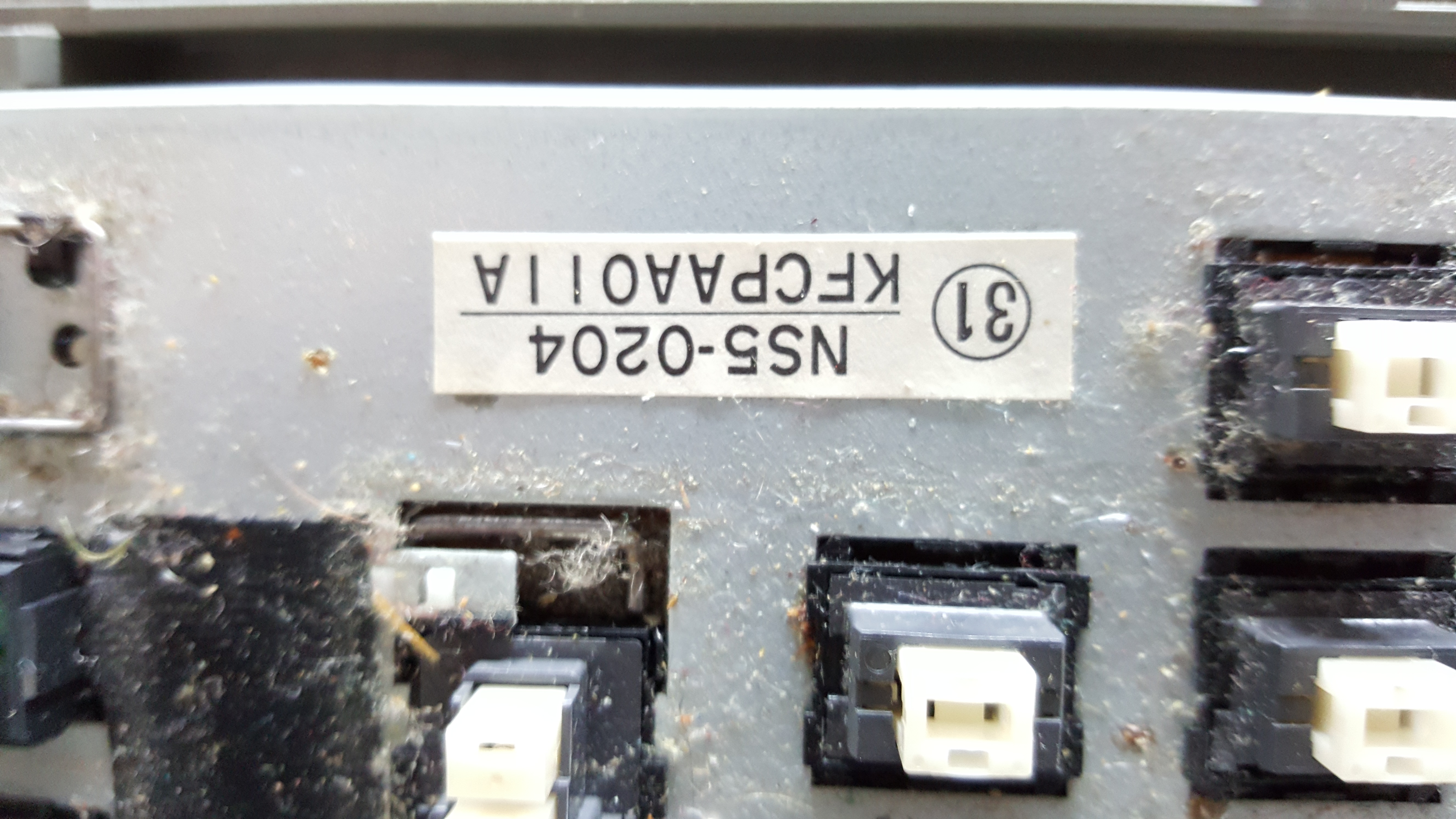

The AP560 also uses ALPS Plate Springs. I have taken it apart and noticed the following markings on the plate:
Hopefully that's helpful. If there's any other info you need, let me know!
15 Sep 2017, 09:36
Hmm .... interesting. SKCP series by the looks of it, which alphabetically follows SKCL/SKCM, so is plate spring newer?
The patents are 1974 and 1984, but I always had my doubts on that. The 1974 patent seems to be for a different switch, which was then adapted to make what we call plate spring, giving rise to the 1984 patent. If so, it's probably contemporary with SKCM — perhaps this was some way to get a click version before they thought of using a click leaf a year later.
That is: SKCL (green/cream/cream lock) → SKCL + extra actuator leaf (more tactility) = SKCM Brown → SKCP (1974 design + switchplate) → SKCL + click leaf = SKCM Blue
(SKCP could have come before SKCM Brown though — hard to understand Alps codes, as SKCN and SKCO appear to have been skipped within a very short space of time)
I did wonder why vertical plate spring falls under SKF* which seemed to contain all the little PCB-mount switches — it seems that SKF* is in fact most metal contact stuff, and SKC* is any type with a switchplate. SKE* types use conductive rubber domes inside discrete switches.
Thank you — now we just need a few clean shots of that typewriter model on the wiki.

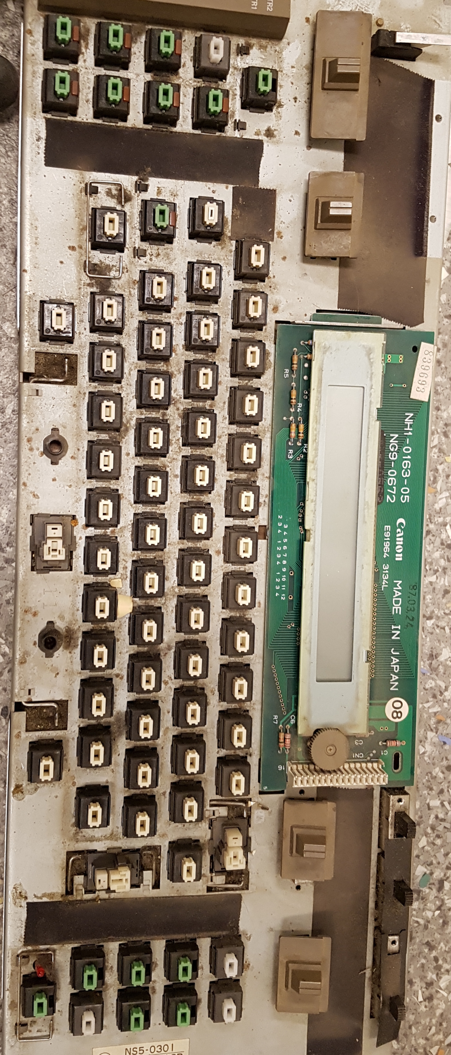

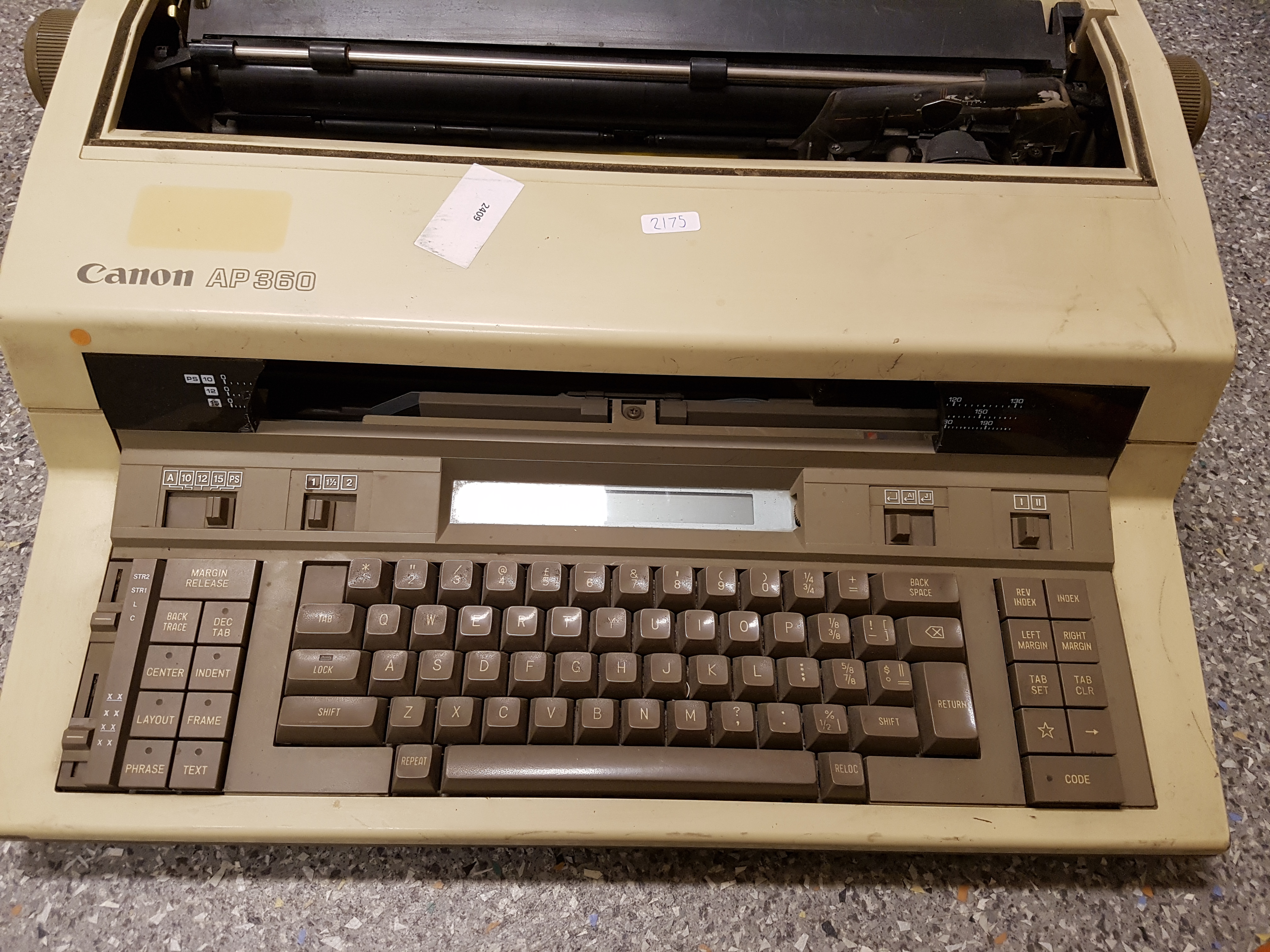

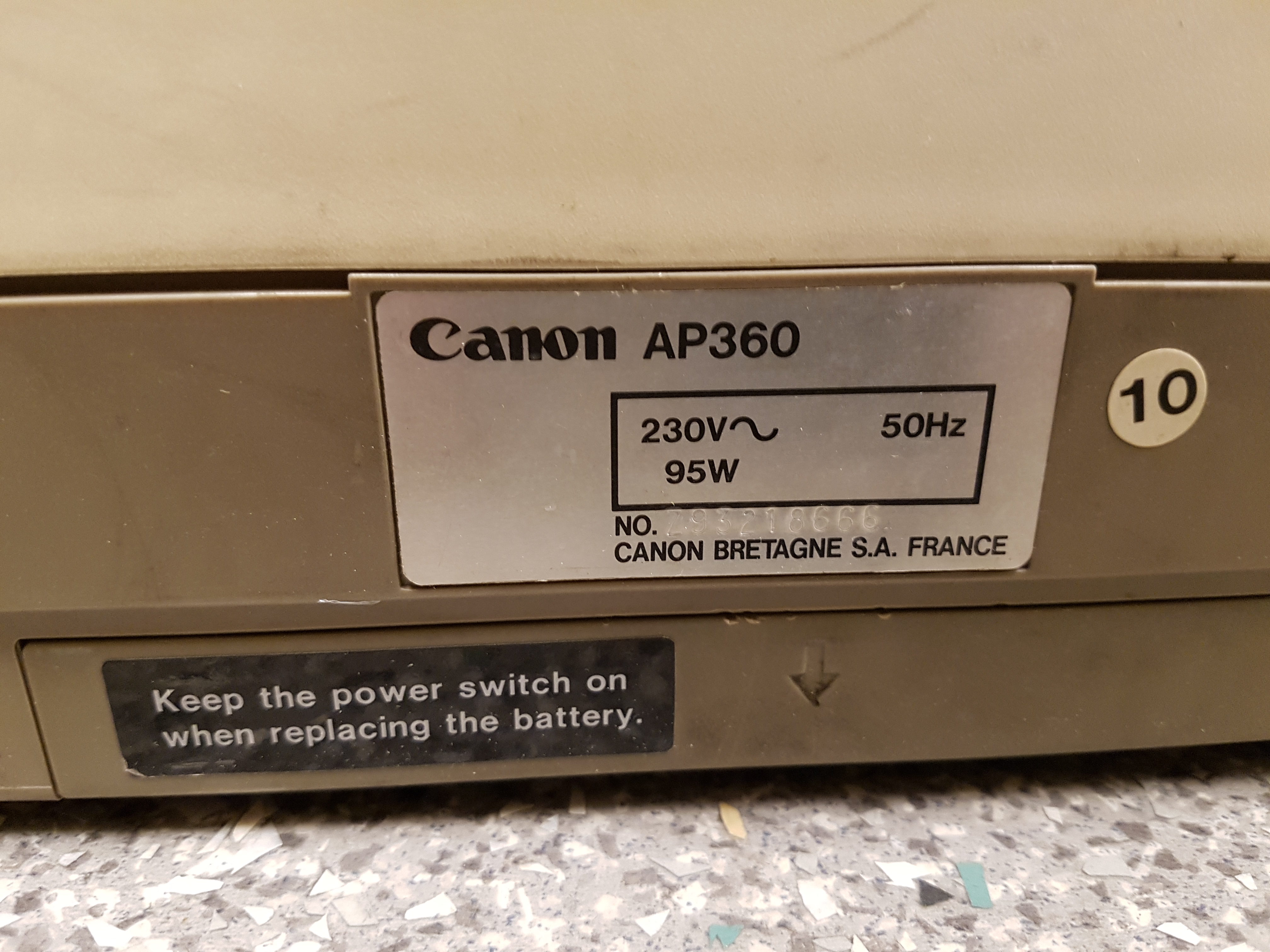

I recently bought a Canon AP360 typewriter, and I thought I would share my findings as well. The AP360 seems to be the EU version (or atleast EU-made version) of the AP350 II in the op. Atleast I suspect so as they have a almost indentical layout.
I was unsure exactly what switches the 360 had, but as it had a similar layout to the 350 II and rectangular centered locklight window I decided to gambel and buy it.
This is what the AP360 looks like:
This model has apparently been assembled in the French Canon factory in Bretagne.
I was also happy to find out that the AP360 also apparently carrie SKCM Creams, SKCL Greens and few weird SKCL Double Action switches :D

The Tab key... ouch! :(
Interesting use of Double Action key switches. I wouldn't have expected one on the Return key.
Tias
19 Jul 2019, 20:43
Findecanor wrote: 19 Jul 2019, 13:48 The Tab key... ouch! :(
Yeah, the broken stem is a bummer :/
I don't have any plans for the keyset, but I intend to atleast clean it and try to glue back the broken stem
Findecanor wrote: 19 Jul 2019, 13:48 Interesting use of Double Action key switches. I wouldn't have expected one on the Return key.
These double action switches are really funky tbh, a really weird and stiff feeling when you engage the second action as the plate spring (I assume it is a plate spring) at the bottom of switch housing compresses
Also noticed that there isn't any pictures of this particular switch in the Wiki. I'll disassemble some of them and snap a couple of pictures :)
