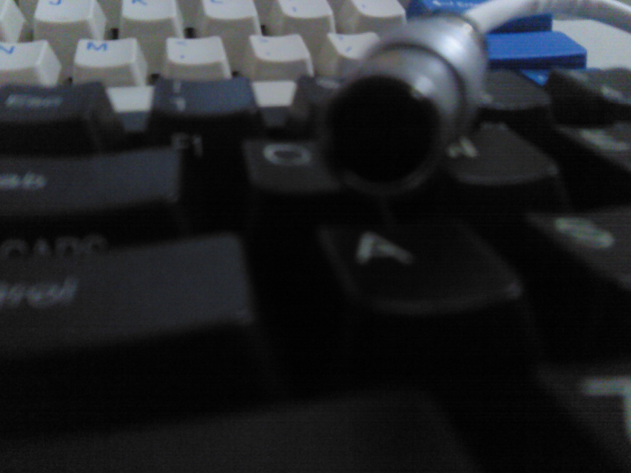

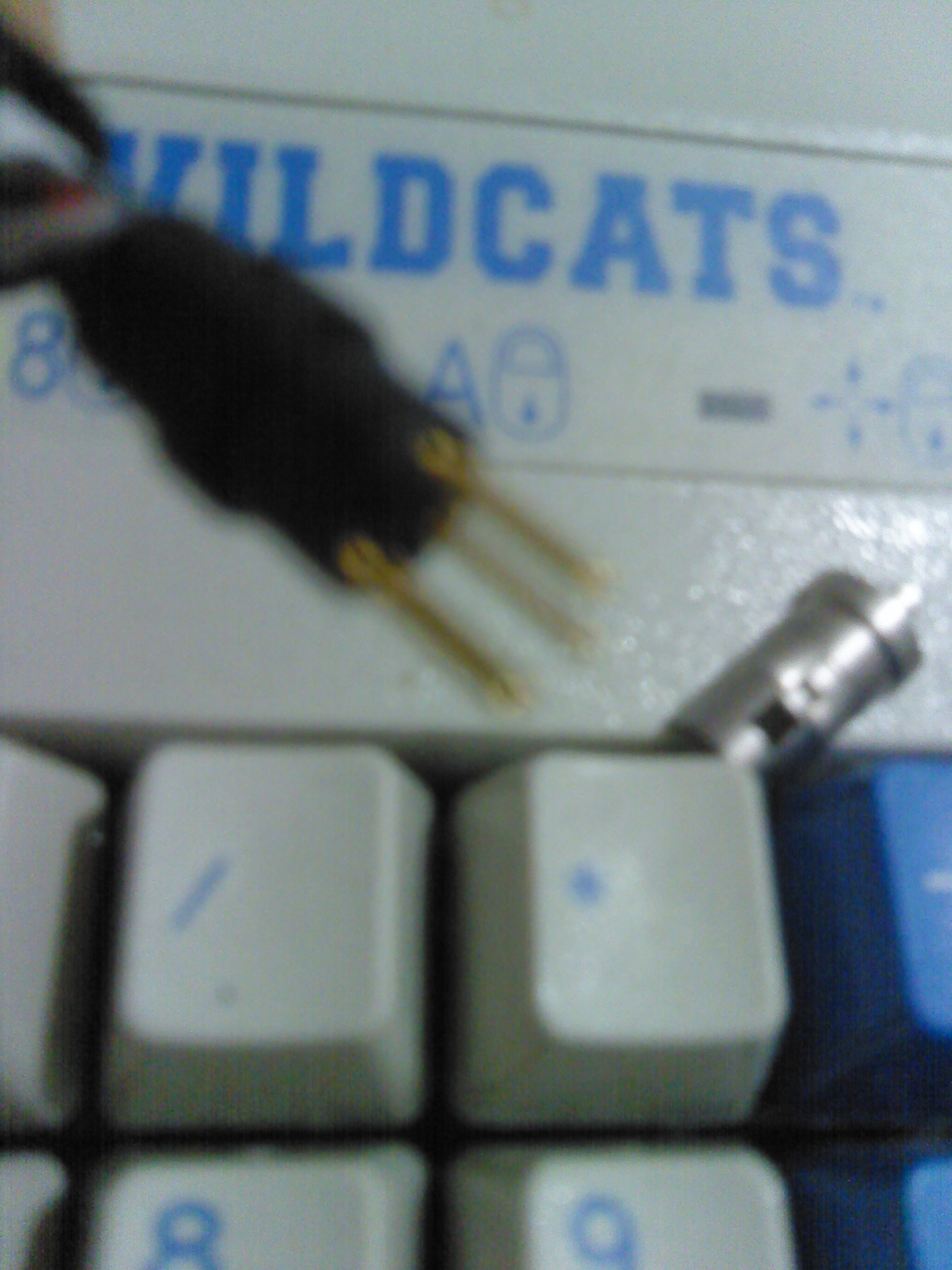

chimborazo
19 Nov 2012, 00:47
it's definitely five pin. not four. customized. got the casing shell off of it. whether it will fit, remains to be seen.
i don't have a digital ps. just a phone. sorry
Image0 (1).jpg (415.51 KiB) Viewed 6977 times
chimborazo
19 Nov 2012, 00:56
haha. that's so messed up. it looks like three pin there.
rodtang
19 Nov 2012, 01:52
HHKB? What you have there is a Unicomp Model M...
chimborazo
19 Nov 2012, 02:27
rodtang wrote:HHKB? What you have there is a Unicomp Model M...
rodtag mind the background. besides, since when unicomp customize (electrical components) its wildcats version?
let me try another picture guys. my apologies.
chimborazo
19 Nov 2012, 02:38
still not good.
bhtooefr
19 Nov 2012, 13:53
That almost looks like 270 degree DIN-5. What an odd connector to find.
Is the connector physically larger than a PS/2 connector?

RC-1140
20 Nov 2012, 23:20
Daniel Beardsmore wrote:http://deskthority.net/workshop-f7/xt-a ... 0-120.html
See the second socket on the left — having seen that, and it does look more like it. No idea what it does, but there's a converter for it :-P
That's a 270 degree DIN 5-Pin. They can be found e.g. on 122-Key Terminal Model Fs. After looking more closely on the picture it really seems to be one of these. The 270° plugs I've encountered were really heavy duty, full-metal, with a screwring on. Looking on the second picture, that looks like full-metal with a screw ring.
Soarer
20 Nov 2012, 23:54
The last pic shows it to be less than the width of the top of a keycap, which means it's probably mini-DIN sized.

21 Nov 2012, 00:29
chimborazo wrote:still not good.
Could you shine a flashlight into it when taking the photo, or hold it up facing a window?
And keep back from it – cameras can't focus up close (less than 30 cm/12 in or thereabouts) unless they have a macro mode.
chimborazo
22 Nov 2012, 06:36
daniel. the picture doesn't work. the pins sit at the bottom and with this phone theres nothing i can do...
one way to describe it- think ps/2 just slightly smaller.
is there a list with clear pictures (haha the pot calling the kettle black) so i can see all adapters that have been made so far.
chimborazo
22 Nov 2012, 06:42
heck. looking at it one more time, one of the six holes is empty. and probably one of the pins could have broken off
Soarer
22 Nov 2012, 06:54
So it could be PS/2? Does it have the rectangular plastic pin in the middle? I suppose the question then is, which of the 6 pins is missing?
chimborazo
22 Nov 2012, 07:06
soarer. im far sighted. but i just looked at it. and i guarantee you that there's none. unbelievable.
chimborazo
22 Nov 2012, 07:08
the usual four wires black red green white and a grey, and no plastic
