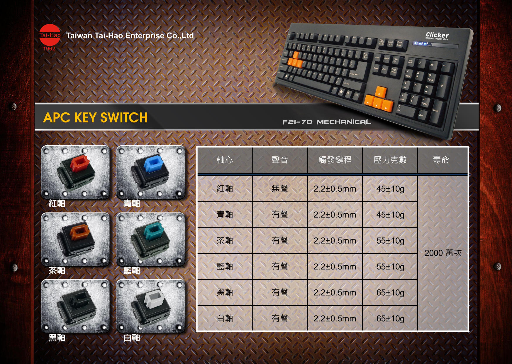

I've attached a spec (in Chinese!) of all the current Taiwan Tai-Hao APC brand switches. From this, you can determine the specified force, as they're all colour-coded. Red Alps! Do want!
Unfortunately I can't put an image through Google Translate, so I can't easily translate the rest of what's on the page. I may find this out from Tai-Hao.
According to this spec, there is no 70 g switch at all! I've also asked them where the APC BSW 070WH comes into it. I only have the spec of the 055WH at the moment.
According to Felly Du at Taiwan Tai-Hao, they've been making switches since before the 80s, their switches are patented (I've not verified this), and they copied no-one, so if they're telling the truth, they were possibly the creator of the four-tab design. (As noted yesterday, they're also responsible for the non-Alps-compatible Aruz switch, which is a discontinued product range) They also sold unbranded switches bearing only numbers, for other companies' keyboards. I've suggested that they still must have copied Alps, surely? Unless Alps copied Tai-Hao, as the Z mount design was used for other switches before Alps moved to the most famous design (that we have no name for yet, possibly "Alps leaf spring").

English version of the above posted to http://deskthority.net/wiki/APC_switch along with all the switch part numbers. The chart omits the APC BSW 075WH and APC BSW 075WH (75 cN) and the APC BSW 070WH (70 cN) is discontinued.
The current approach is that they didn't "copy" from Alps, they "learnt from" Alps ;-)

Haha, the Chinese translations are funny. The greenish turquoise switch is called "blue", the actual blue one is called "pale", and the brown one is called "tea" lol (yes the one that you drink)
So the one on the Azio Levetron Clicker got discontinued? From the box, it shows that the switches are white, and from my tests, it's closer to around 65g of pressure to actuate versus the 70 that they stated. TBH I would be happier with a switch that took less effort to press, but the Azio Levetron Clicker was the only one that was under $50 that I could find. Hopefully once I wear it in, it will take less effort to press.
EDIT:
I can translate, but it's pretty much exactly what you would expect them to say
The first column is the colour switch obviously
The second column is whether or not the keys make sounds when you press them (the first one on the list doesn't while the rest do)
Third and fourth are self explanatory
The last is the expected life of the keyboard (20 million)
EDIT:

青 is not pale. It can be used to describe both blue and green in color. Etymology wise, it is closer to green. MX blue is called 青 too. Calling the teal one blue is very odd. 藍=blue. MX Brown is called tea. Nothing new there. Tea is used as color. Not sure why that's a funny concept. Lots of colors are named after items. Orange, salmon, lime, indigo, turquoise etc etc.
ruhtraeel
- Main keyboard: HP KU-0316 / Lenovo Y470 keyboard
- Main mouse: HP UAE96 / Beijing Water Cube
- Favorite switch: rubber dome
Wow, I've never heard 茶 being referred to as brown. I've always used 啡laffindude wrote:青 is not pale. It can be used to describe both blue and green in color. Etymology wise, it is closer to green. MX blue is called 青 too. Calling the teal one blue is very odd. 藍=blue. MX Brown is called tea. Nothing new there. Tea is used as color. Not sure why that's a funny concept. Lots of colors are named after items. Orange, salmon, lime, indigo, turquoise etc etc.
Also, at that colour, I would just go 绿色
laffindude
Well, there are a ton of words that can be used as brown. 啡 is a semi new usage, coming from 咖啡色. 褐would probably be the more traditional usage.
Edit: Your unit is off, 億 would be 100mil ;o~

I counted wrong from a measure I rarely get to use -_-laffindude wrote:Well, there are a ton of words that can be used as brown. 啡 is a semi new usage, coming from 咖啡色. 褐would probably be the more traditional usage.

White will be 65 gf; "65g and 75g is the same stem color – White and Black. 65gw is always used in our 7D KB and 75gw is sold by us for some project used."
I've attached the copy of the picture with translations. There is one tactile and one clicky for each of 45, 55, 65 and 75 gf.
- APC BSW range as of 2012.jpg (309.2 KiB) Viewed 21619 times

The image changed... I'm guessing the second one is right, because it would seem weird that only one of the switches doesn't make noise and the rest have identical pairs of switches
- Daniel Beardsmore
- Main mouse: MS IMO 1.1
Yeah, you're right, they messed up the first one :) I'll let them know.
