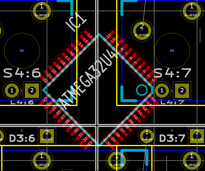

Because there is not enough space, I'm thinking about placing the controller directly on the PCB. My problem is that the footprint for the controller in Kicad apears larger than the one placed on the G60.
Does anybody know the exact measures needed for that controller (ATMEGA32U4)?
Footprint in kicad.
G60-controller placed at the same position as above, appears to have more space.
The controller plus necessary extra stuff in Kicad. Does anybody know what the ISP and C1-C4 sections for?
Thanks!
Footprint in kicad.
Thanks!

Your images don't work...
And is there really no way to make enough vias and attach a Teensy through wires? I thought the top of the keyboard had some room to spare.

Do you've got the exact measures of the chip?JBert wrote:Your images don't work...
I can make soldering points all accross the PCB so the Teensy can be wired up. I've tried to add the Teensy-footprint to the top row and it did not work out because there is no space left on top.
The chip on the GH60 apprears to have smaller soldering points, which would fit between 2 switches. I hope that this is for real and not a mistake.

I believe they are soldering the atmega chip straight to the PCB, which is more difficult to solder, but takes up way less space.

This is what I mean. Now I need to know if the size is correct and the footprint I've got is wrong. I need the exact measures!damorgue wrote:I believe they are soldering the atmega chip straight to the PCB, which is more difficult to solder, but takes up way less space.

Seems to work!
Please notice that I can make the LED pads normal holes and put the diodes elsewhere to get more space.
The only problem is with pin 34 almost touching one of the switch soldering pads. But that is not too much of a problem as we don't need all pins anyway.

Atmega is not enough, it cannot communicate via USB, only I2C. So you will need an usb-to-i2c bridge (cheapest is ~$1.2 in 100+ quantities) plus some resistors/capacitors/diodes. Anyway this is going to be much cheaper than teensy. And all of this comes with KiCAD libs and full specs.7bit wrote: Now I need to know if the size is correct and the footprint I've got is wrong. I need the exact measures!

You can choose another chip, ATMEGA168A-AU for example have only 28 pins (while still having 23 io pins), ATMEGA168A-PU is a rectangle as opposed to a square for 32U4.
I suppose there's a lot of space under space bar/enter/tab etc for mcus.

TBH, I would be really surprised if this works. I've seen many people who were new to PCB design start a project, build a first prototype, order 40 PCBs and then discover a small mistake which makes all these PCBs useless. We had very big problems with electromagnetic influence on most of these boards, and in many cases it was because some pins were too close to eachother.
And philpirj: The ATMega32U4 has native USB support… But they're a real bitch to solder.

You're right, ordering 40 pcbs is not a good idea, i had experience resoldering io pins.RC-1140 wrote:TBH, I would be really surprised if this works.
Have just spotted native USB support in 32U chips. There's an 32U2 in a smaller TQFP32 package.
Any idea if PWM/ADC is used in keyboard controller or more than 1KB memory required? Hopefully not.
