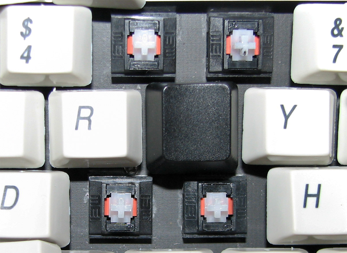

Anyone know if these are U mount?
http://deskthority.net/wiki/MEI_switch
Icarium
26 Dec 2012, 16:45
I had to look up "U Mount". >_<
Now it seems that they obviously are. What am I missing?
26 Dec 2012, 16:58

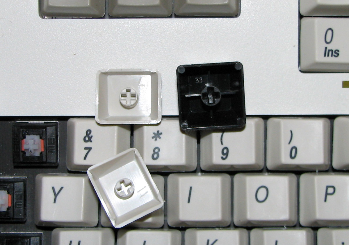

Yeah, several people have asked where "U mount" originated. It's possible Cherry just copied it. Back in these days, both Cherry and Alps were toying with various mounts, including cross and tee switches each. (The Cherry tee switches may take M7 keycaps; don't know.) There are other switches with crosses — the Futaba or Futaba clones on the BBC Micro look U mount, but the dimensions are slightly larger and Cherry caps won't fit.
Cherry settled on a cross with 1 mm by 1.5 mm arms. What cannot be proven from that one photo, is whether MEI are using a cross of those exact dimensions, or something annoyingly different.
It gets worse. The [wiki]Cherry M8[/wiki] switch (which predates MX) has a cross with those dimensions, but M8 and MX caps are not interchangeable due to differing stem lengths, so, perhaps to assist companies with M8 tooling, there are MX switches with shorter M8 stems! This is in addition to the MX Orange (with a non-standard cross) and the MX switches with Z mount (Alps) stems ...... Without a vintage catalogue, I cannot prove that the Orange and Z mount variants are actually MX (i.e. MX* product codes), because if so, then the U mount categorisation at the wiki needs to be moved onto the individual switches that actually are U mount, not MX as a whole. (If not, then MX Orange isn't MX, just Orange :-)
The more work you do on the wiki, the more you realise is missing from it. So much knowledge scattered about in forum topics that needs to be collated. (If people each just covered one switch they're familiar with, we'd get there.)
In terms of MEI, it may be slightly different to 1 by 1.5 mm cross arms, or it may need special keycaps like the M8 did. I've e-mailed MEI for specs, but I don't know that it's even the same MEI. Probably not. Can't find another suitable MEI.

Confirmed over at Geekhack previously. Also: http://www.smcelectronics.com/swkey.htm
Next people for me to harrass for specs ;-)
26 Dec 2012, 18:51
It's a fit.
26 Dec 2012, 18:56
Interesting. Keycap spacing proven to be 19 mm. Someone at Geekhack previously claimed 18 mm, but the Datalux spec says 19 mm (19.05 specifically), which you have proved correct. Plus, a top down shot for better tracing for the switch diagram.
I forgot to ask Datalux specifically whether the current models are Cherry ML, but I imagine they are. Hopefully that will make them more willing to divulge who MEI are if I can't actually buy MEI switches now.
