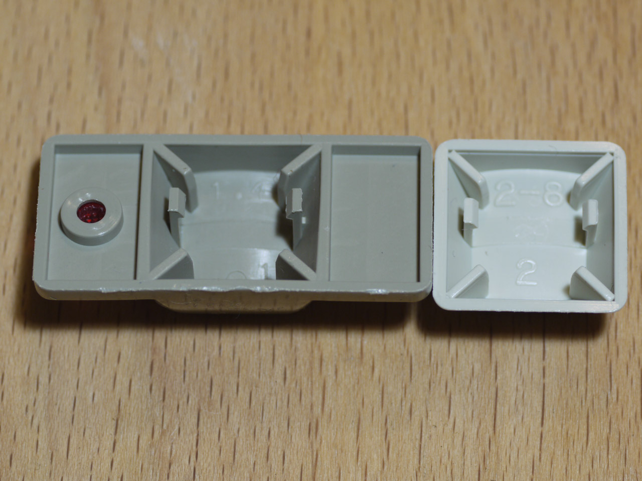

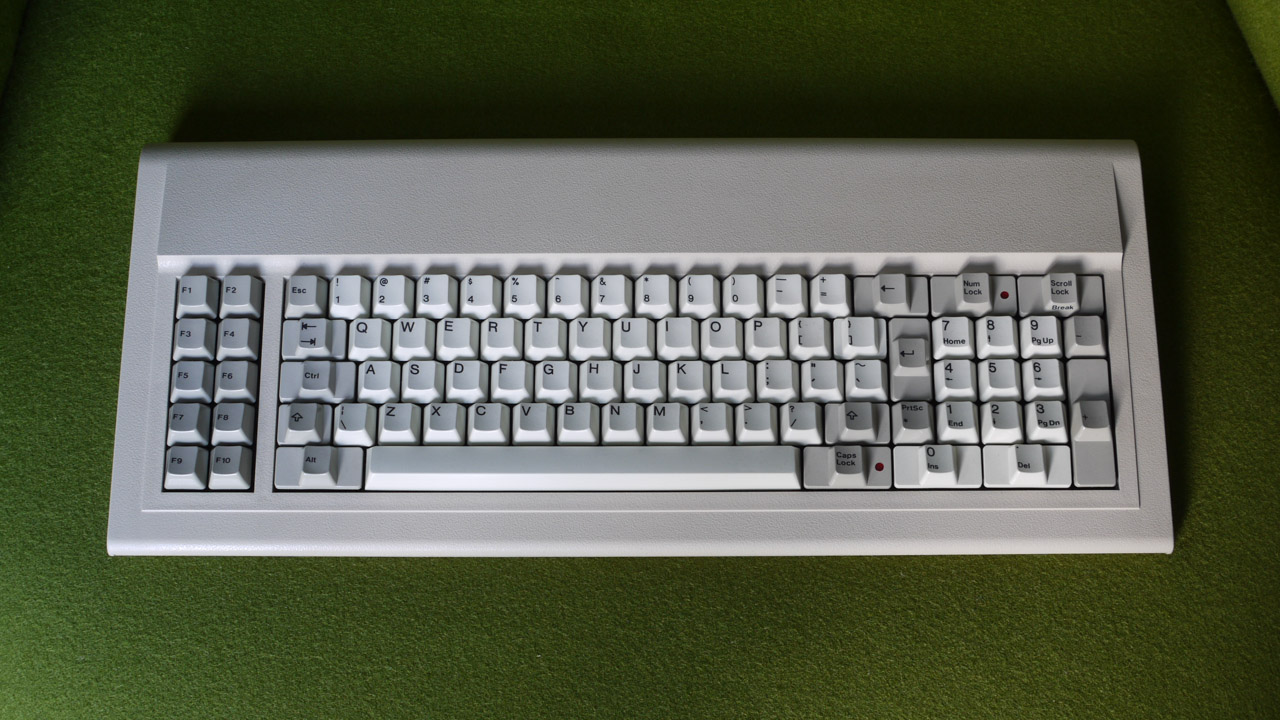

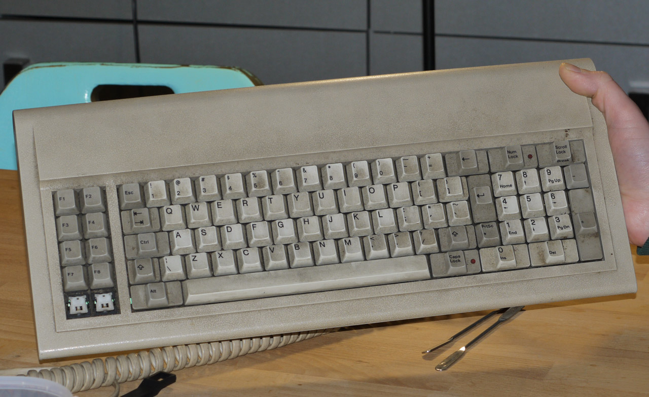

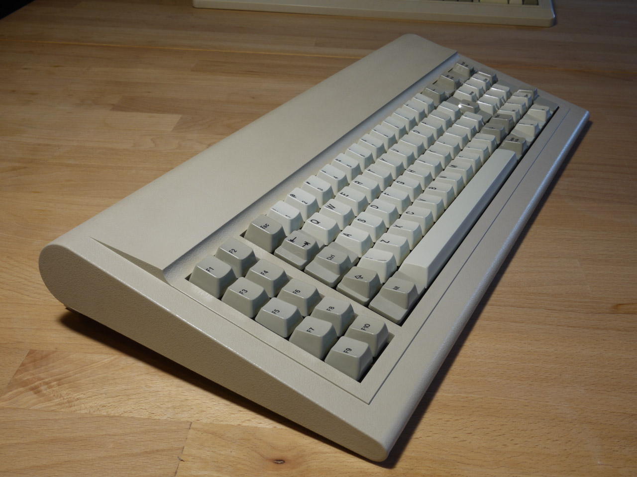

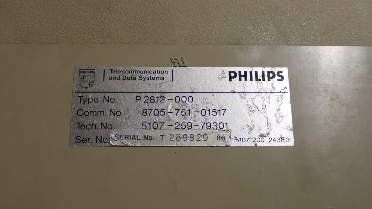

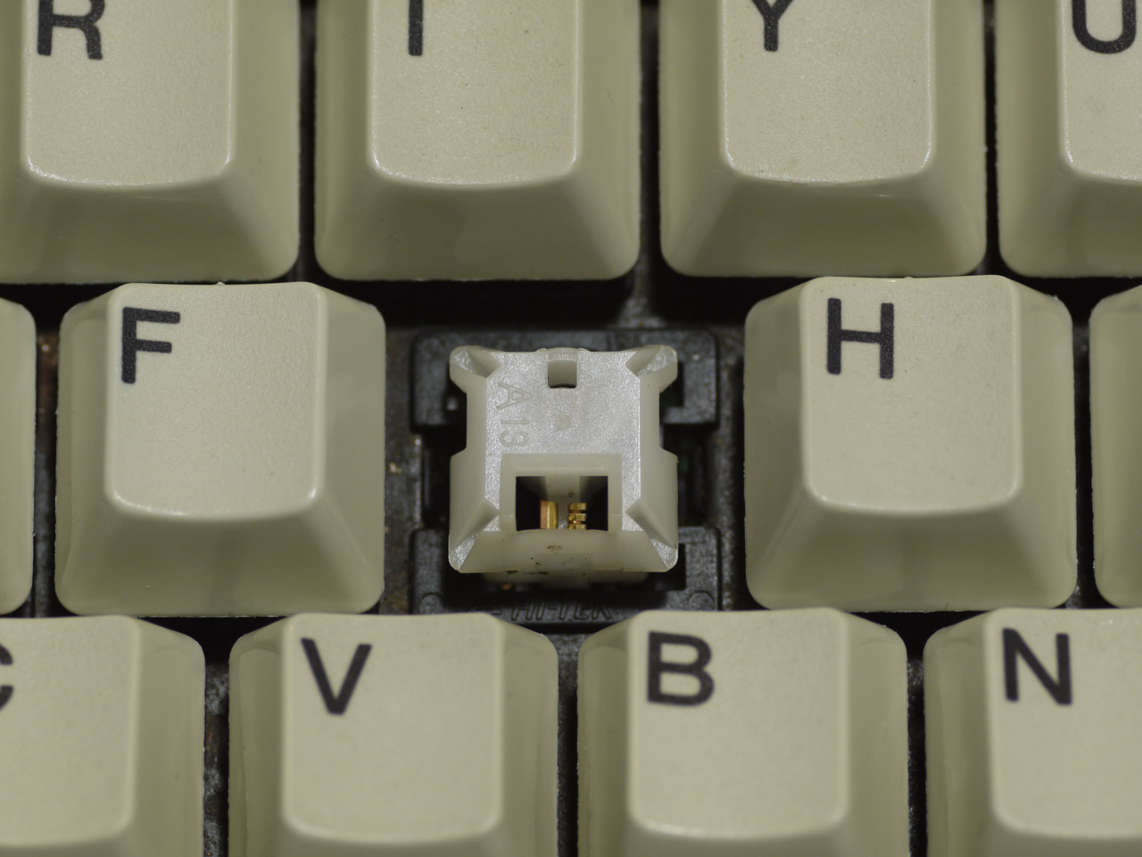

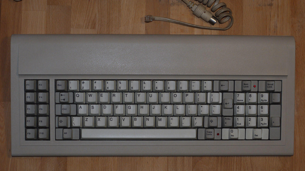

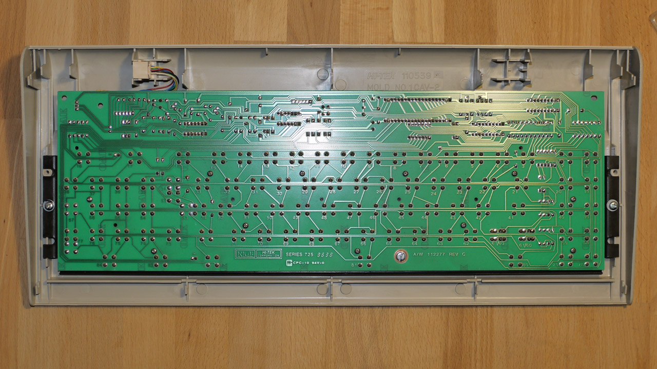

I've bought this Philips P2812 keyboard which was advertised as a "Philips data entry keyboard". From the blurry pictures in the ad, I was hoping for a re-branded Model F. Meh, should have done more research. As far as I know now, it was sold with a Philips P3105 personal computer. This baby needed some serious cleaning but it came out rather well.

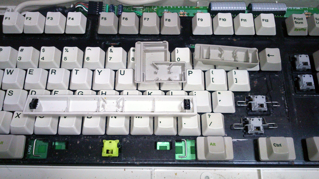

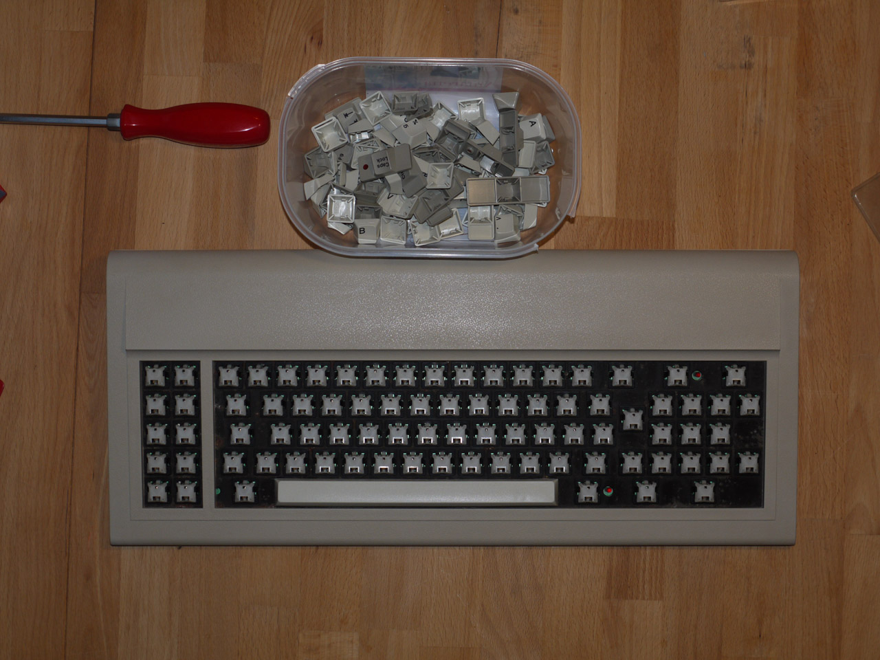

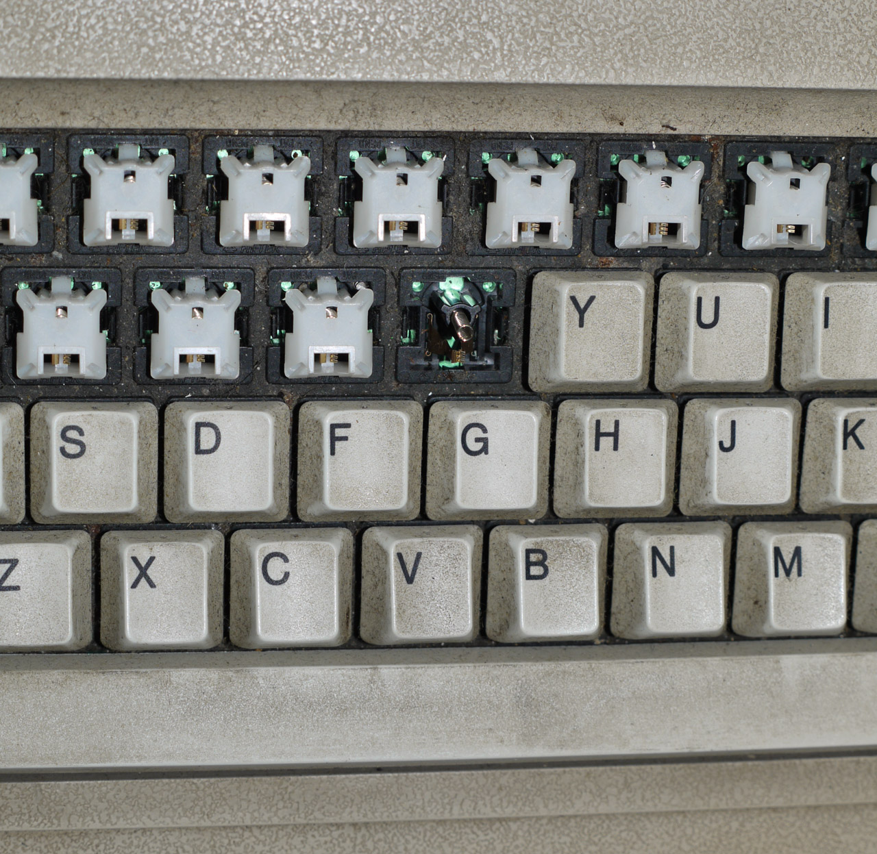

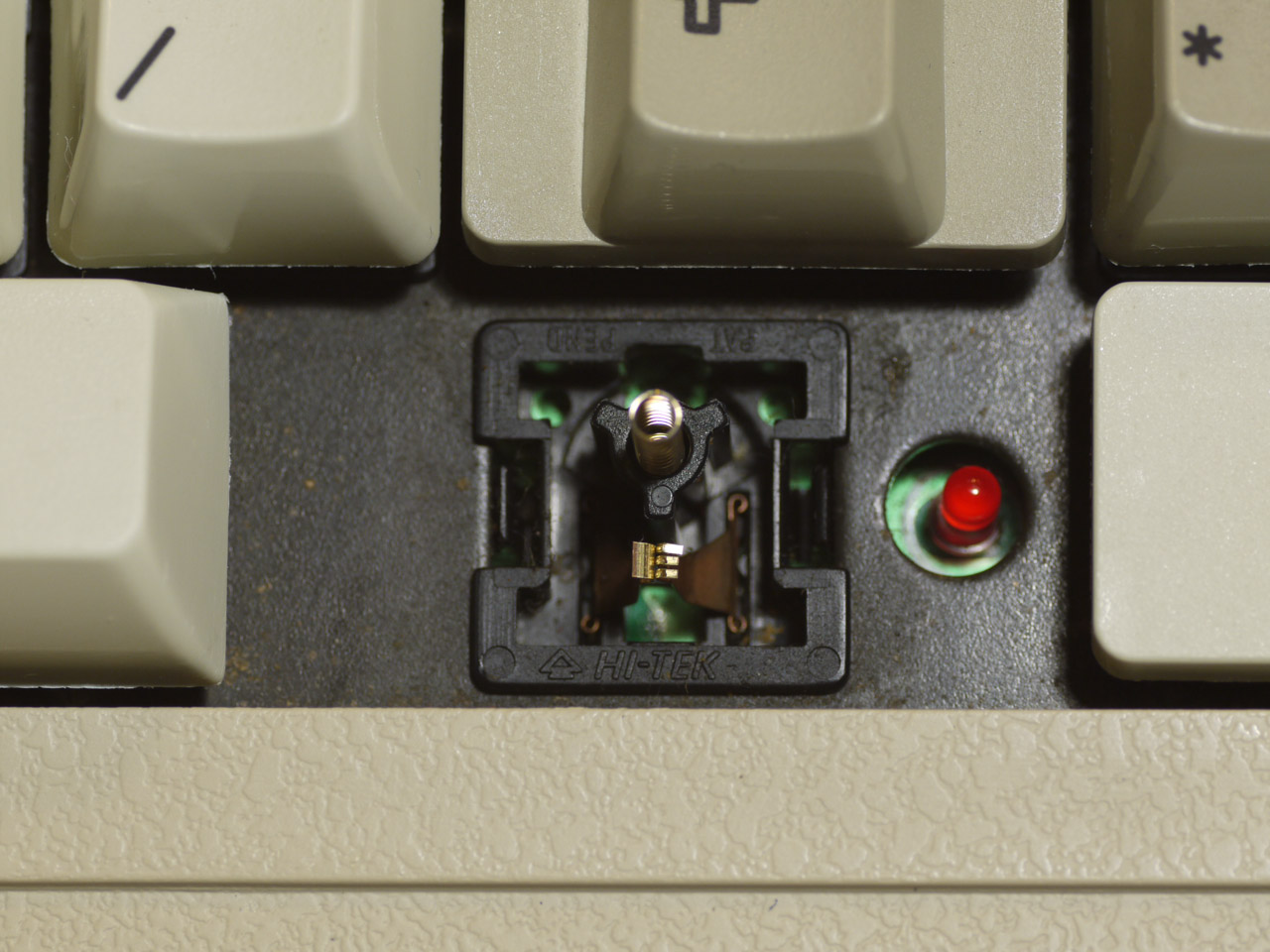

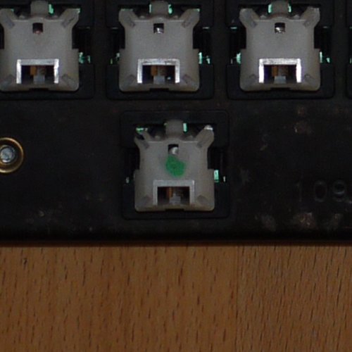

It has linear NMB Hi-Tek "space invader" switches which, in my opinion, feel rather similar to Cherry MX blacks. They are a pain to clean because the slider (space invader face) comes off with the key cap and putting this back on the base can be fiddly. Surprisingly, there aren't any stabilizers underneath the larger keys except for the space bar.

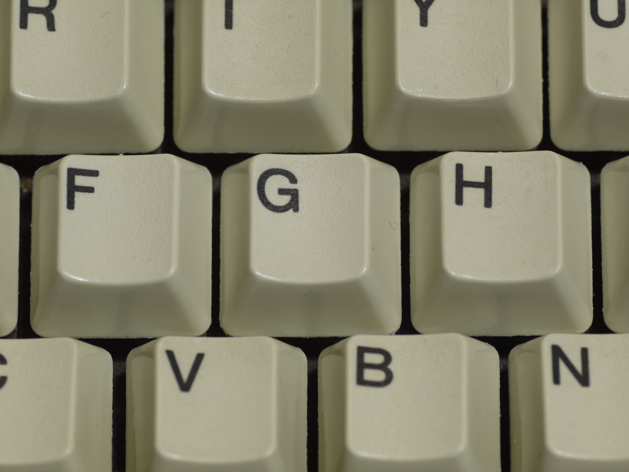

The legends look dye-subbed and the caps feel like PBT, not sure though.
The board doesn't seem to work on modern day PCs, although it comes with an AT DIN plug (5 connectors in a 180 degree arc); not via a DIN->PS/2 adapter nor with a DIN->PS/2->USB adapter chain. The LEDs light on shortly so the power should be ok. I haven't tried Soarer's converter yet, though.

Dirty space invaders

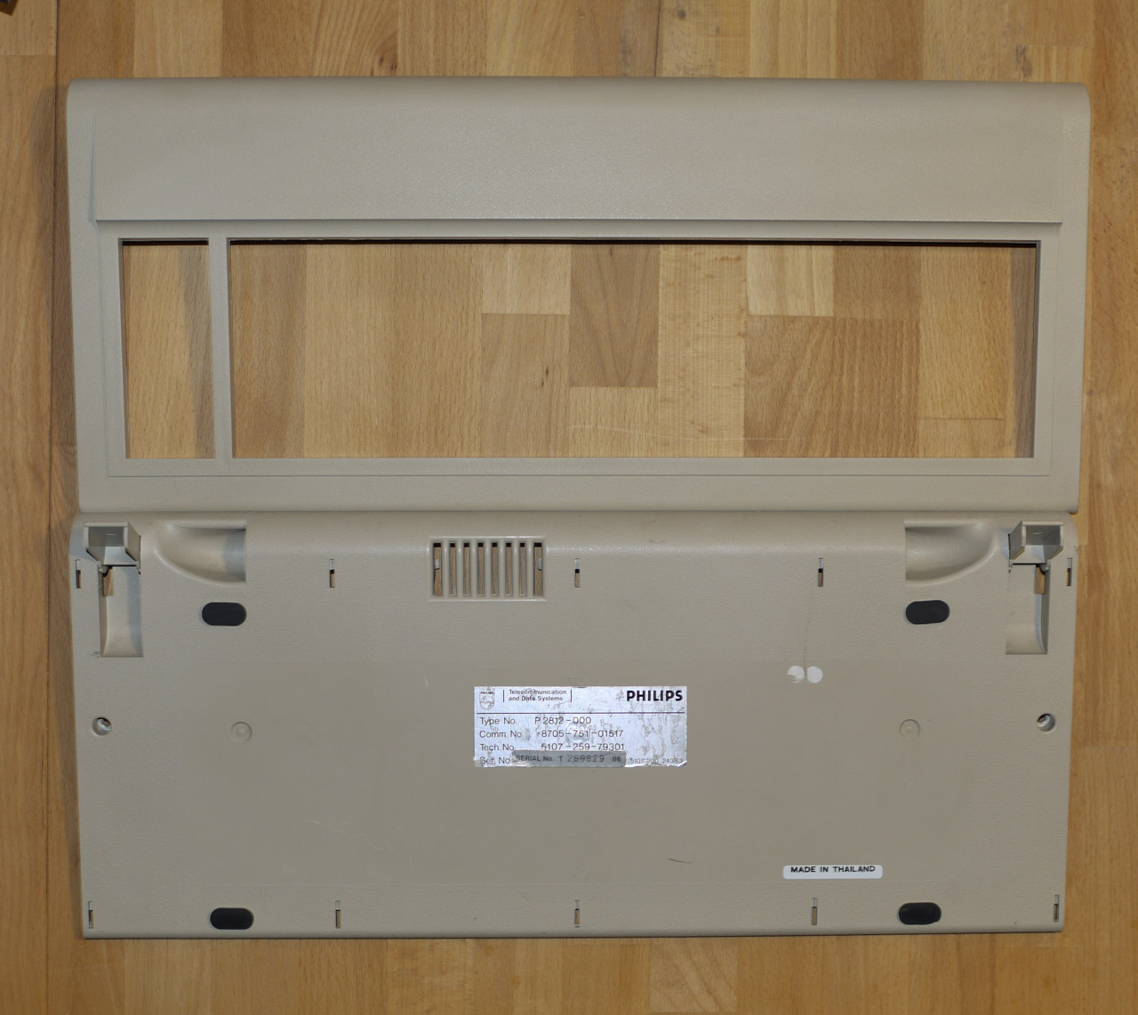

Label
Label

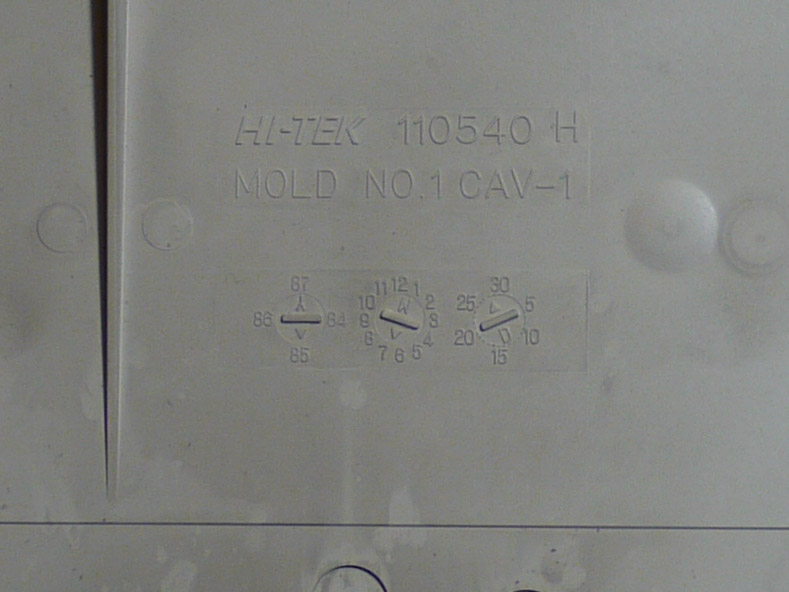

Top and bottom shell
PCB
PCB
Cleaned space invaders
Top view 1
Top view 1
Top view 2
Top view 2

Key caps detail
Key caps detail
Switch detail 1
Switch detail 1
Switch detail 2
Switch detail 2
Caps top
Caps top
Caps bottom
Caps bottom

NMB are a nice switch if you like stiff ones. Do you find them totally linear of feel some tactility?

maxmalkav wrote:NMB are a nice switch if you like stiff ones. Do you find them totally linear of feel some tactility?
I feel no tactility whatsoever.

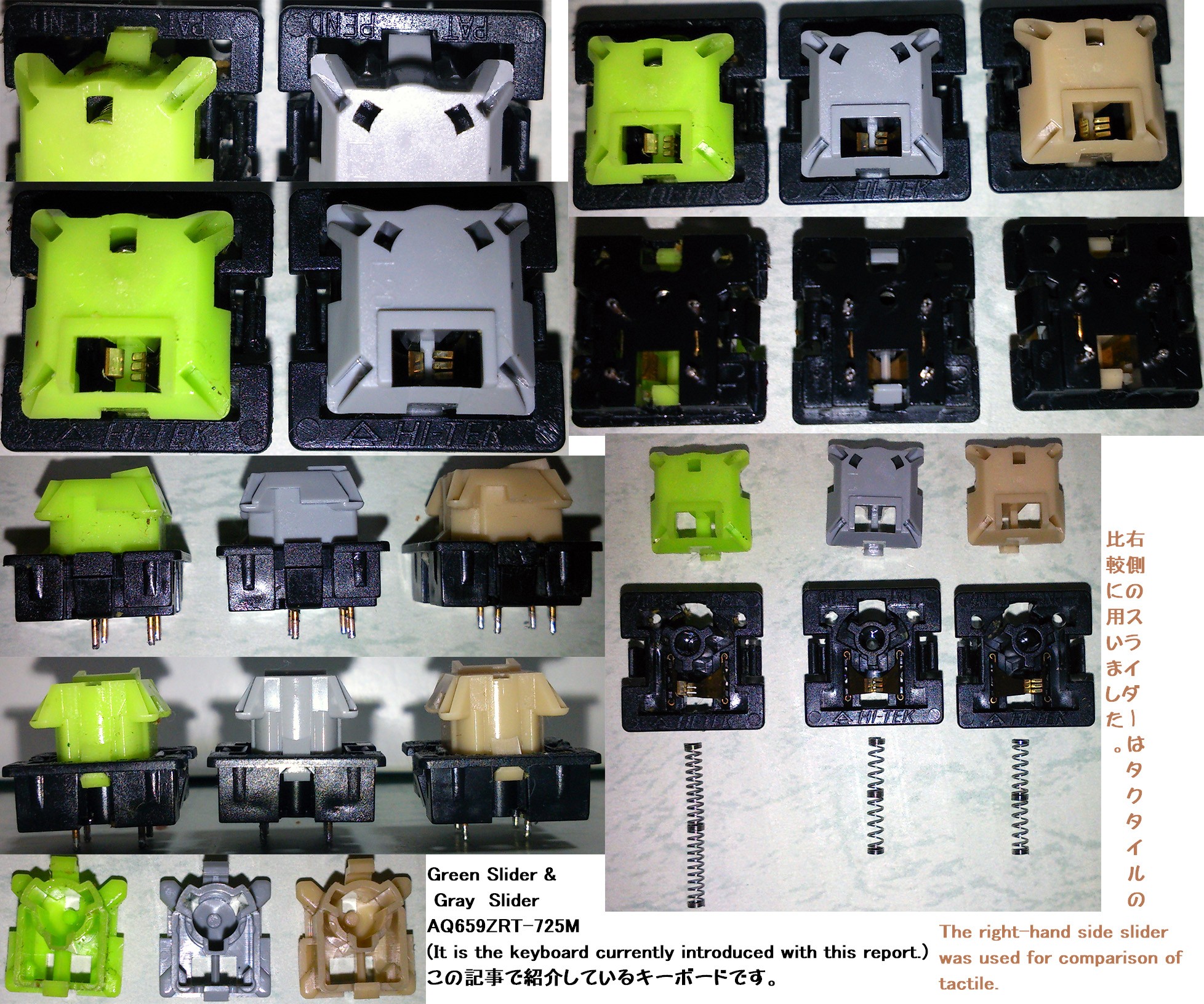

It's the tactile ones that confound me. I've concluded that the white follower arm at the back of black and cyan switches is the clicker, but I cannot identify anything in the remaining switches that makes them tactile. The linear switches in the keyboard above just look the same as tactile switches, i.e. completely linear. Also, what purpose the "eyes" serve, as some switches have them, and some don't. Eyes seem to be on the clicky ones, but some grey (tactile) ones have them, too.
NMB are on my growing list of people and companies who haven't responded (including Futaba, Monterey and SMK). It should be possible to get some details out of NMB — year introduced (probably 1985), year discontinued etc. Possibly specs. Preferably the correct product name!
Also, scroll down to the bottom of http://www7.ocn.ne.jp/~hisao/jiku.htm — there's a soap-dispenser-handle one that I've never seen anywhere else, alongside the typical blind white one, and the grey variety that does have eyes. And another Omron variety (slider with flat front and back instead of stepped). He doesn't say what keyboard that was in.
The keyboard cleaned up well, though; you should post that to the wiki too. Looks like it's an XT keyboard from a Philips P3100 or P3105 XT clone: http://geekhack.org/index.php?topic=5362.0

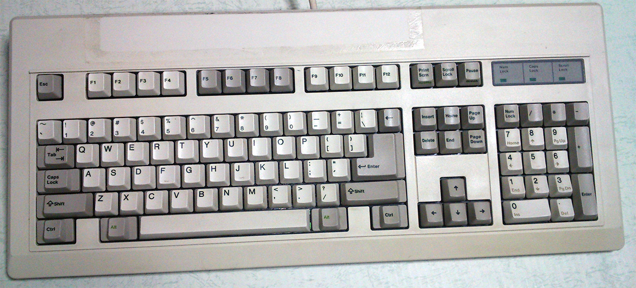

Ah, same as this Tandon version of the Hi-Tek 725: http://deskthority.net/keyboards-f2/pic ... t3909.html
What colour is the spacebar slider? They're often different.

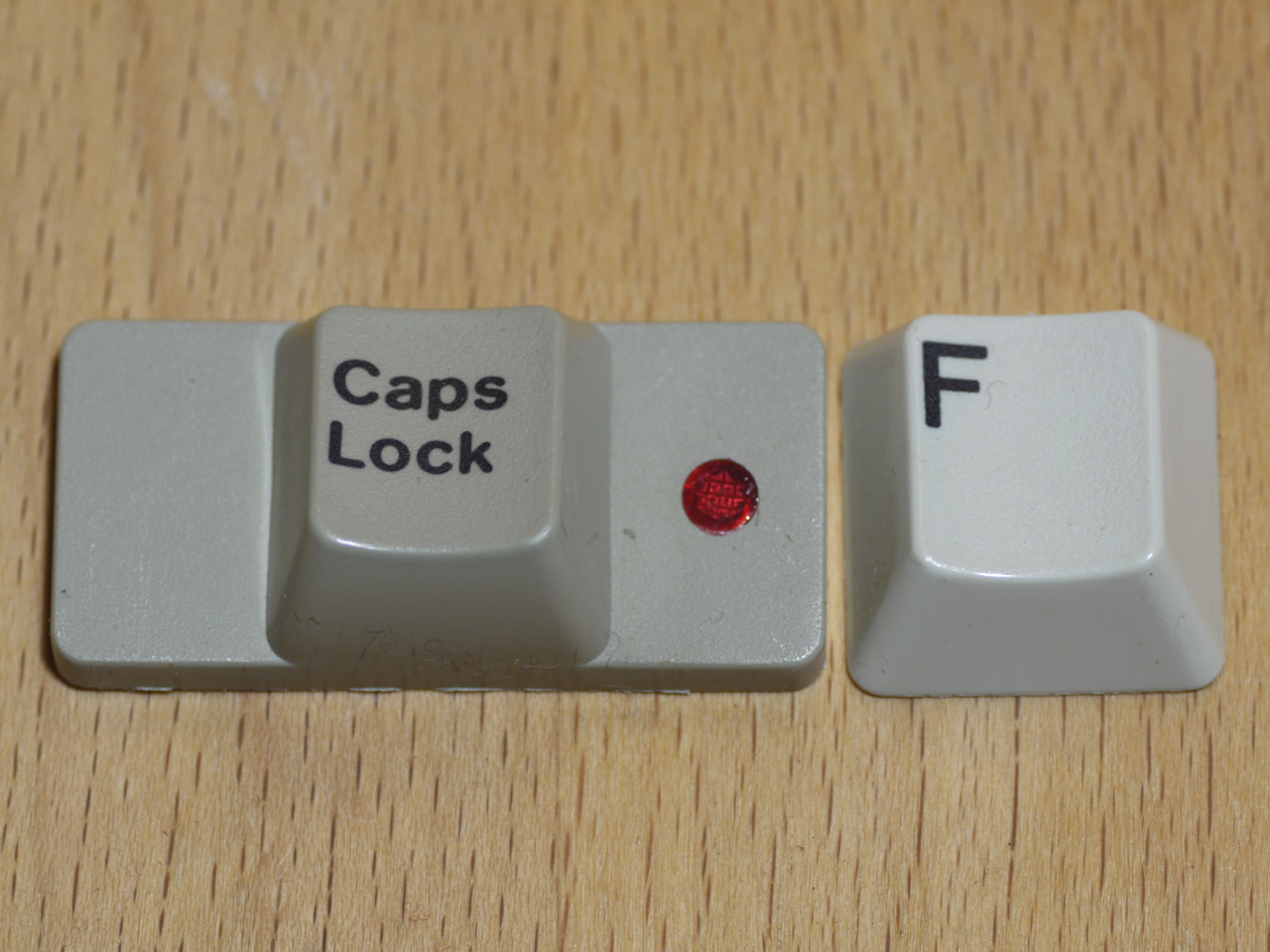

Daniel Beardsmore wrote:...............What colour is the spacebar slider? They're often different.
The space bar switch is identical to rest but it has a stiffer spring. Oh, there's also a blob of green paint on it.
07 Jan 2013, 22:00

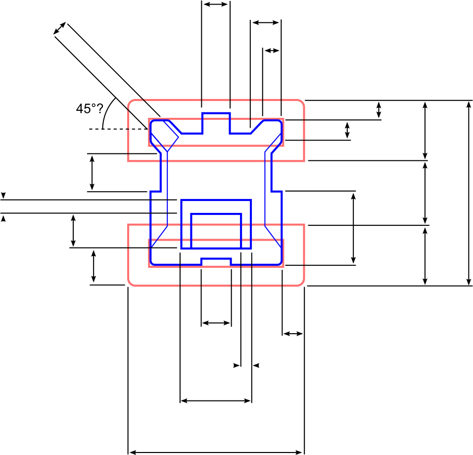

Cheers. Yeah, it seems to depend on the board — some have the spacebar switch in a separate colour, others do not. The most bizarre is keyboards where the lock keys are not only a different colour, but a different shaped slider, with no explanation: http://kbd.rzw.jp/nmb/aq659zrt-101a/ — they loved their neon colours.
Wiki page updated with confirmation that spring is stiffer even though switch is the same colour.

OK, taking how far I got in trying to diagram this one, I've knocked up a measurements diagram, attached (I've taken care of this for anyone who can't draw). Could someone please fill in the measurements — I had a really hard time trying to figure out the shape of this one from photos due to perspective skew.
NMB Hi-Tek measurements.png (29.47 KiB) Viewed 8457 times

NMB RT-101+ AQ659ZRT-725M HI-TEK Grey Slider Tactile
YouTube, Typing
Details http://kbd.rzw.jp/nmb/rt-101_aq659zrt-725m/
