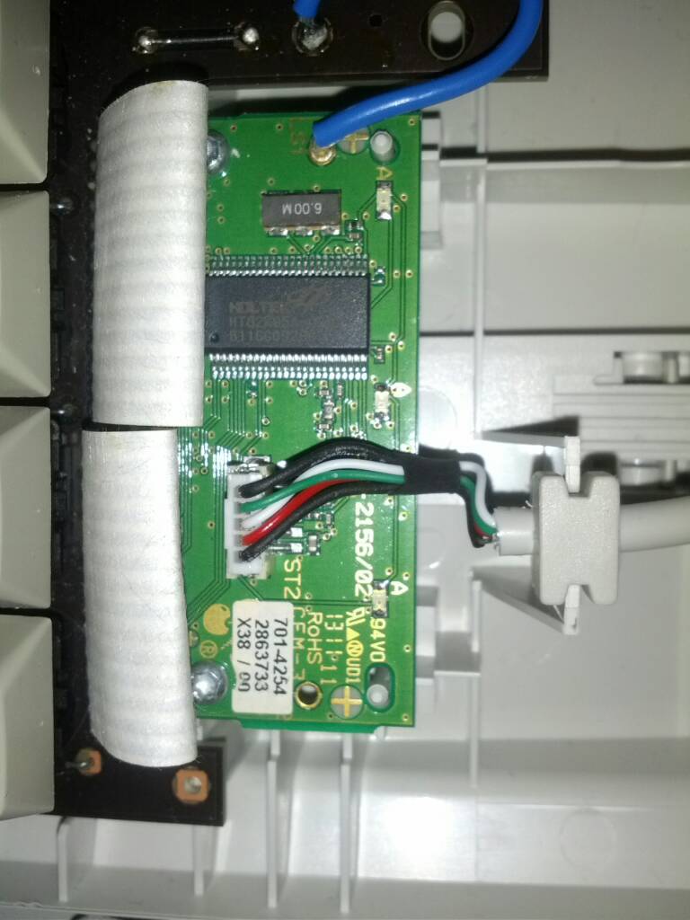

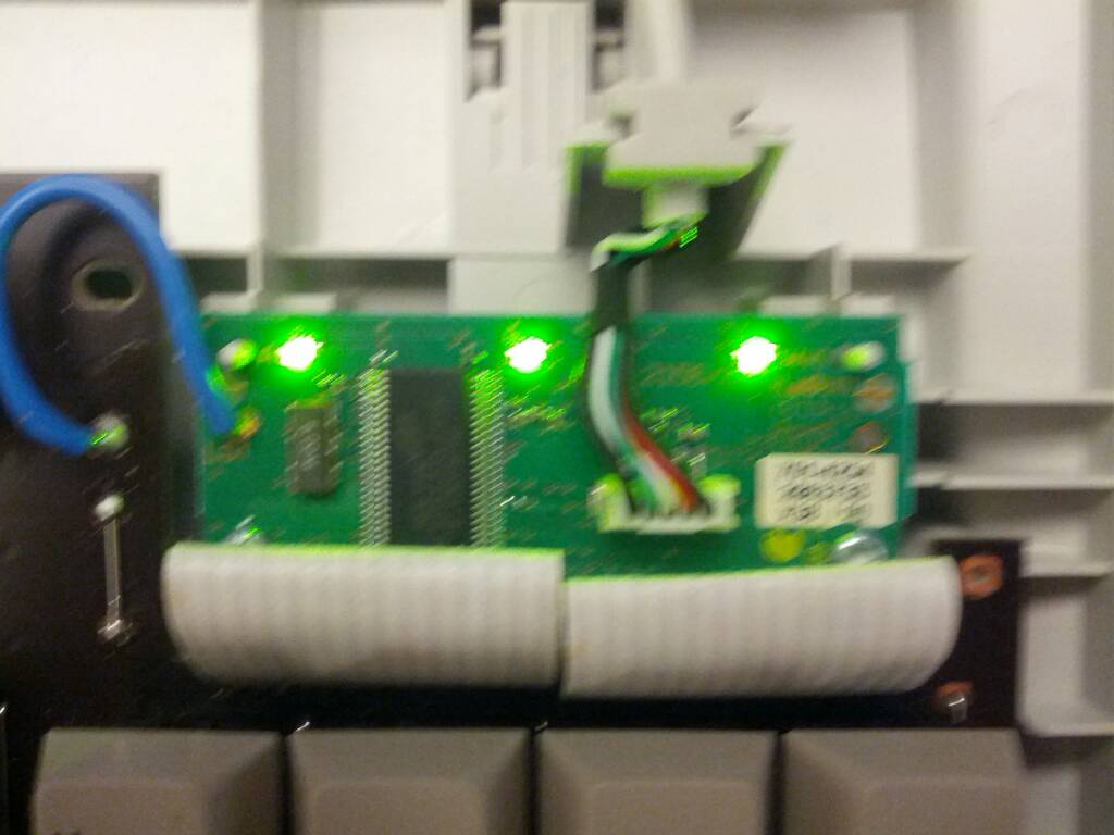

rindorbrot
14 Jan 2013, 08:16
Ok I have got a slight problem here...
The newer type don't have usual round LEDs.
I have my G80 at work so I could not check earlier.
Looks like these are SMD LEDs?
I can't take a pic of the underside. Have no tools here...
RC-1140
14 Jan 2013, 14:32
Definitely SMD. These are a bitch to solder, but not impossible.
IvanIvanovich
14 Jan 2013, 18:11
Eh, haven't seen one like this yet. I guess it was about time they made smaller controller pcb isntead of one half the size of the switch pcb... though not sure why they didn't just make switch pcb revision to include that as it could clearly fit if the extended the pcb a little. Seems kind of dumb.
