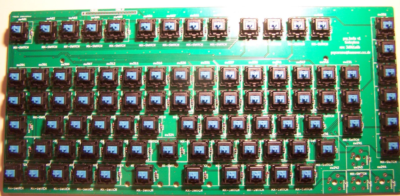

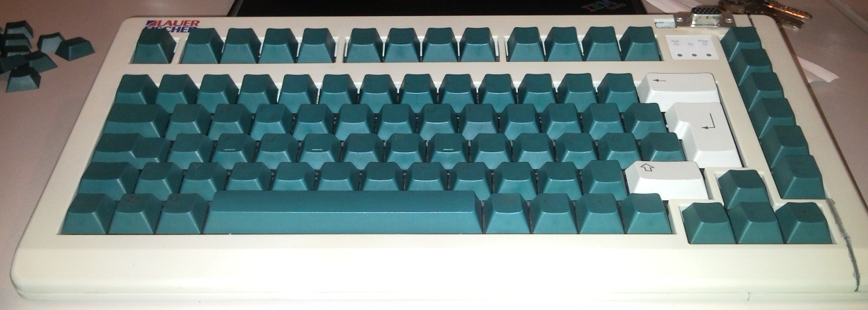

About a year ago, I got one of those G80-18xx from imp and modded it into a tenkeyless.
tenkeyless -- starting point

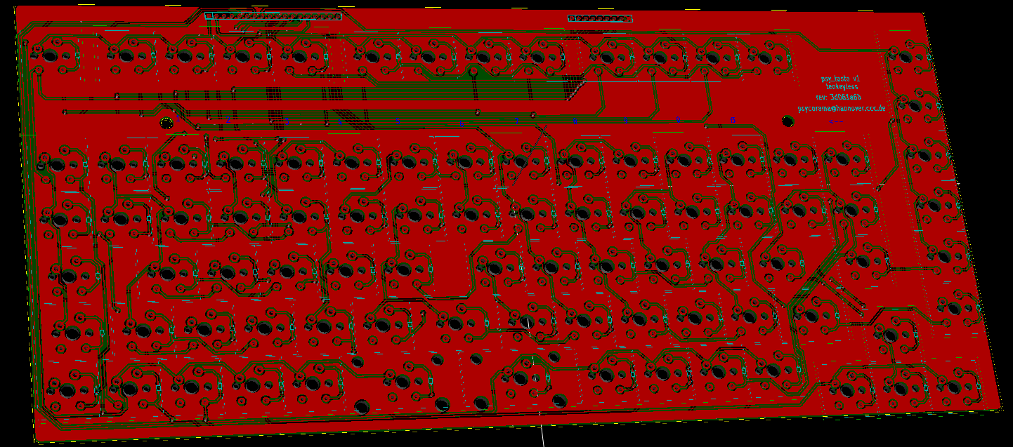

I thought about a symmetrical layout which is not completely possible because of the location of the arrow keys and nav cluster.
Nontheless I implemented something and at the moment I'm waiting for it to be shipped. :)
The render doesn't have stuff for the switches so you have to use your imagination.

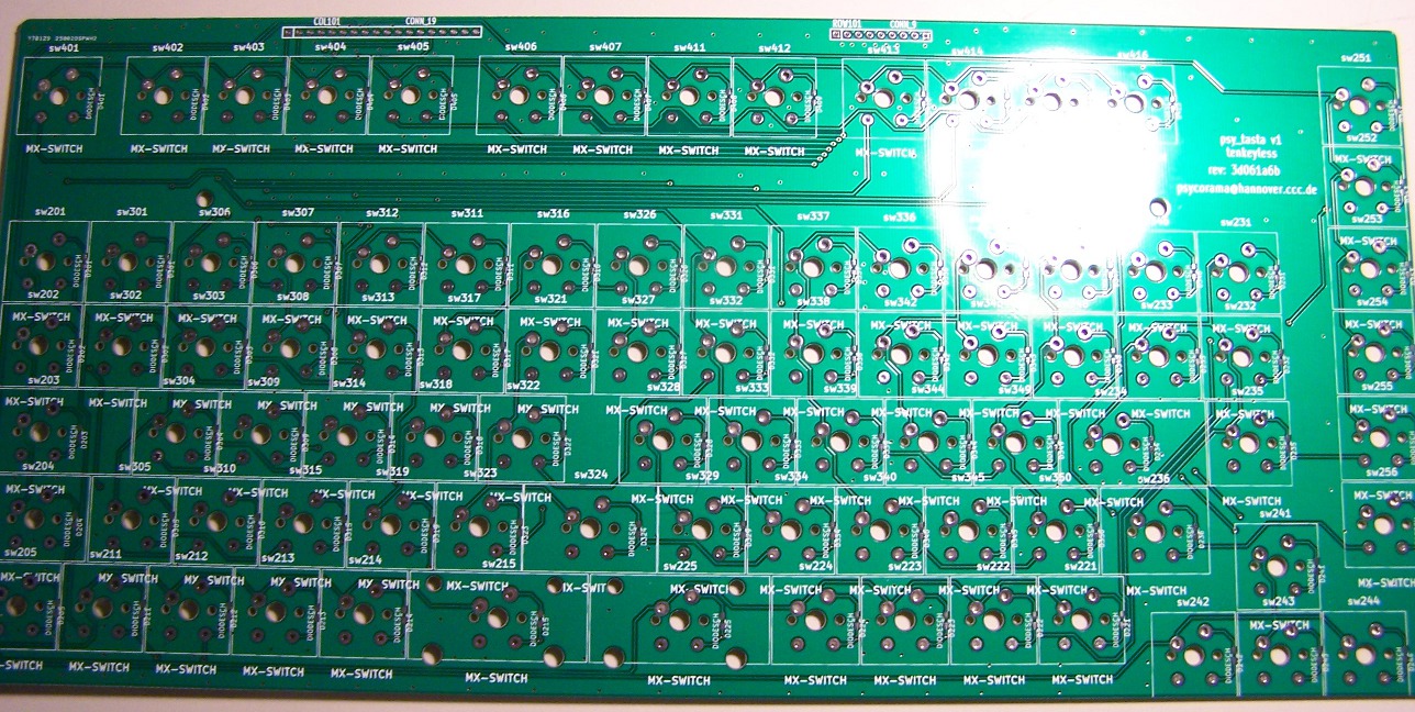

board layout
board layout
The right hand side got more keys then the left, but I'll have to see what it feels like.
Both sides are rotated inwarts (not rotated left as most "standard" boards).
I split the space key (it is way tooo big for my preference) and got some extra room for modifier keys.
One nice feature I hope to achieve will be the 6kro (nkro ist not possible with USB, afaik), but I will have to test all of this.
I'm not finished with the exact layout, but this is where imps controller replacement comes into play. 8-)

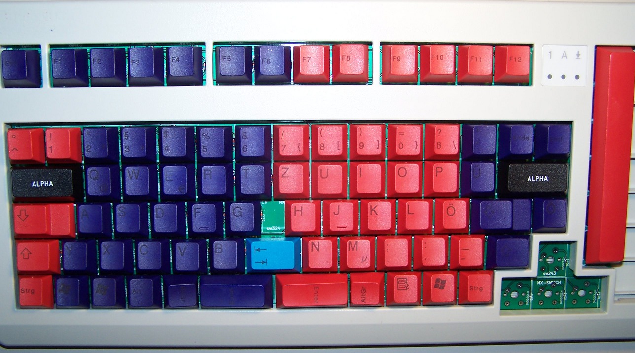

psycorama
03 Feb 2013, 14:00

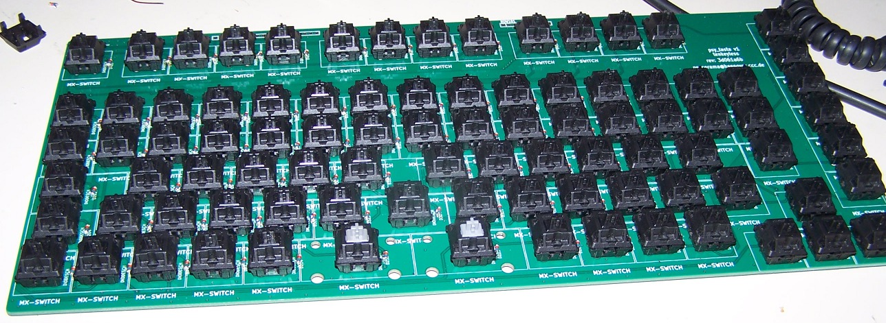

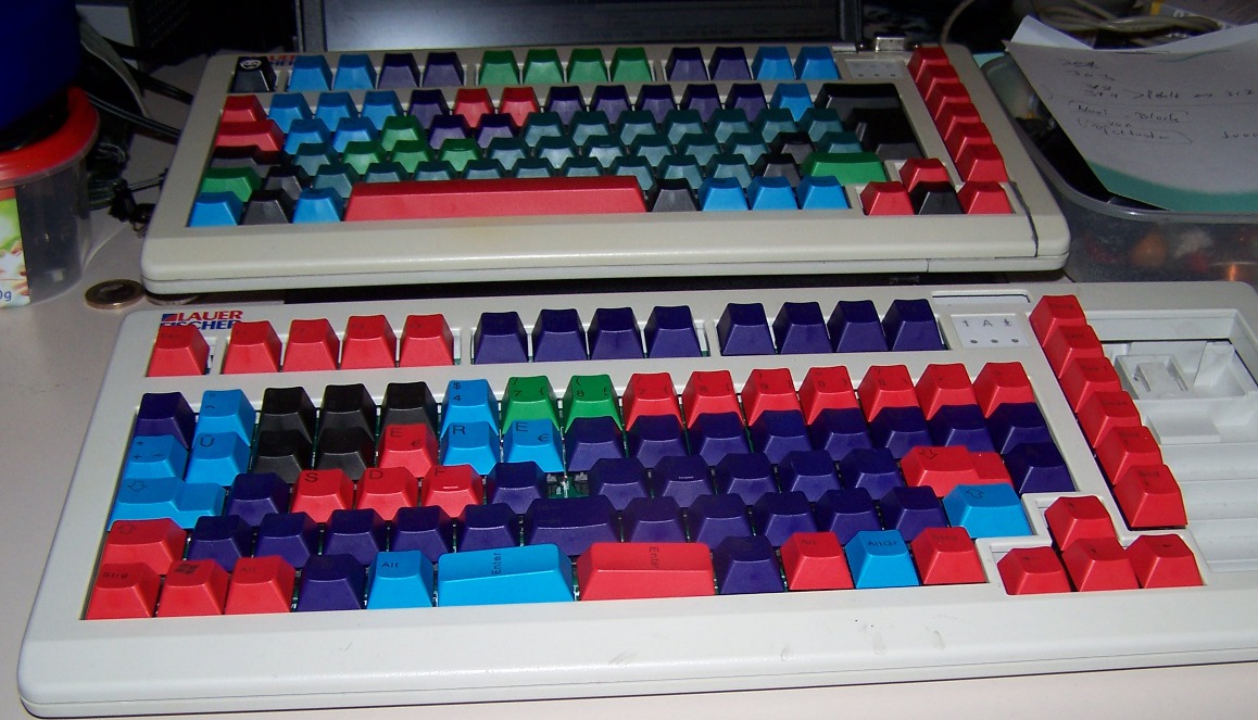

My PCBs arrived and they turned out quite nice.
imp and myself heated up the irons and got to work.
I grabed a bunch of blacks and imp had some blues lying around.
I went for a colorful approach and fully populated arrow keys and nav block.
In the background the keyboard from the earlier post is lying around for easy reference.
imp's version allows you to see the markings on the buttons more clearly.
Some keys need to be placed in software and the case has to be fitted, but for now i'm quite happy with this.
Icarium
03 Feb 2013, 18:26
Hahaha..nice spacebar placement. ;)
Seriously though, looks like a pretty good layout do you have any spare PCBs? :)

Jmneuv
03 Feb 2013, 19:49
i very much like this vertical nav cluster layout;
what controller do those use?
psycorama
03 Feb 2013, 21:19
Icarium wrote:Hahaha..nice spacebar placement. ;)
At the moment i just got about enough for local use. But I'll make another batch, since there're some bugs in the PCB and
I'm not 100% pleased with everything.
I'm unable to use the new version at the moment and I want some first hand experience before I decide on my next steps.
But I will keep you posted. :)
7bit wrote:Where did you order the PCB from?
I ordered those from http://www.hackvana.com
Jmneuv wrote:i very much like this vertical nav cluster layout;
The vertical cluster is a relict from the original keyboard.
You can see that I cut the original case and PCB and glued it back together.
The older versions with the more standardized layout, I've been using for the last year was driven
by an Atmega32U2 hacked together by imp.
The new version with custom key placement is controlled by a fully custom controller likewise created by imp.
http://deskthority.net/workshop-f7/g80- ... t4534.html
I designed my matrix to play well with his controller.

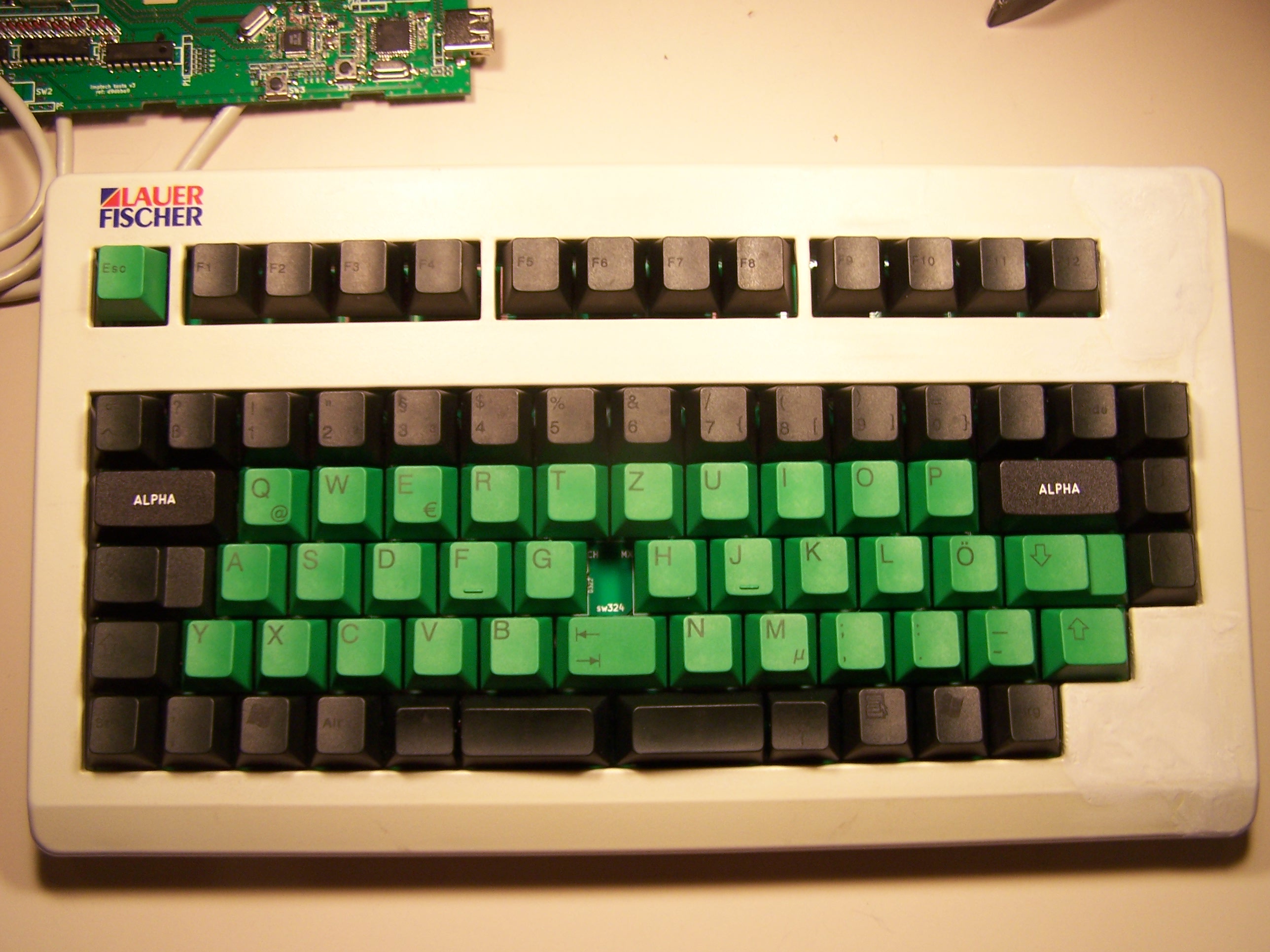

imp
26 Feb 2013, 22:25
And another image of an freshly finished case, matrix and imptech v3 controller:
another one
another one
It's only missing a black capslock and small shift for the right side.
For some closeups of the modded case, see http://deskthority.net/workshop-f7/abs- ... ml#p101366 .
Jmneuv
27 Feb 2013, 12:22
seriously cool.
That gap in the middle asks for a dim led behind a little frosted window :p
How do you access arrow-keys?
gmjhowe
27 Feb 2013, 12:41
That modded case and keycap set combo is coming along very nicely.
Looking ace.
imp
27 Feb 2013, 19:54
Jmneuv wrote:seriously cool.
We can try that :). The main idea was to use the space for a trackpoint.
Jmneuv wrote:How do you access arrow-keys?
Since I'm typing neo2, there'll be the arrow keys in the 4. layer on esdf, surrounded by backspace, del, page up/down, home and end.
Kurk
28 Feb 2013, 12:47
These boards really do look great! Staggering like staggering should be.
