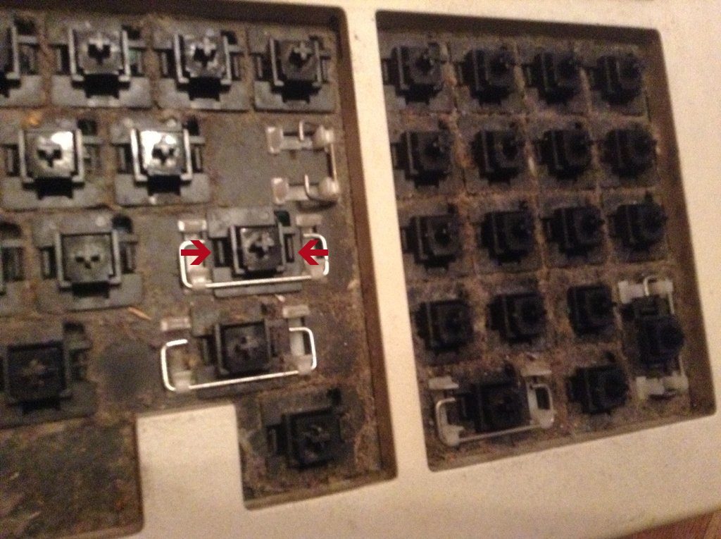

What do you think guys, should I try to clean it, wash it?
It feels pretty nice.
Tell me, do you recognize switches?
Because I don't... It seem that they aren't Cherries?
Also, is there any good tutorial how to wash/clean the mechanical keyboard to the very very small detail?
Thank you, and I hope that someone can tell me more about this one! :D
Also, it got the old 5-pin connector, so ye, might need some modding...

For cleaning, I take off all the keycaps and let them soak in some dish soap, scrub a bit if needed. For the case take the pcb out and wash it in the sink. For the PCB I would use some compressed air to clean off any dust while you have it all apart.
If it's AT you just need a simple AT to PS/2 adapter. If it's XT then you would need to do quite a lot more to get it working with a controller converter or swap.
As far as the switch, if it is what I am thinking it's a capacitive type. Push in those 2 tabs on each side of the stem to pull it out and see what is underneath. I'm sure some others would be interested to see that as well so maybe take another photo to post of the switch internals.

I took some new photos without caps...

They certainly should be. If this is like one I had before, though it looks a bit different maybe a generation older.
Press in the tabs and pull up on the part the keycap attach, to see what is under. Want to verify if it's the kind I think it is.

I popped up a switch, took some photos, and uploaded it to the album :)

Okay ... now what's in the gap where that used to be?
vedranius
22 Jan 2013, 00:49
Daniel Beardsmore wrote:Okay ... now what's in the gap where that used to be?
Ye sorry, I took a photo but forgot to upload that one :D
Here it is, and I added it to the album:
http://i.imgur.com/fK5lEgR.jpg
IvanIvanovich
22 Jan 2013, 04:32
Oh, it's a type of hall effect switch. Not what I was expecting at all. Very nice.
