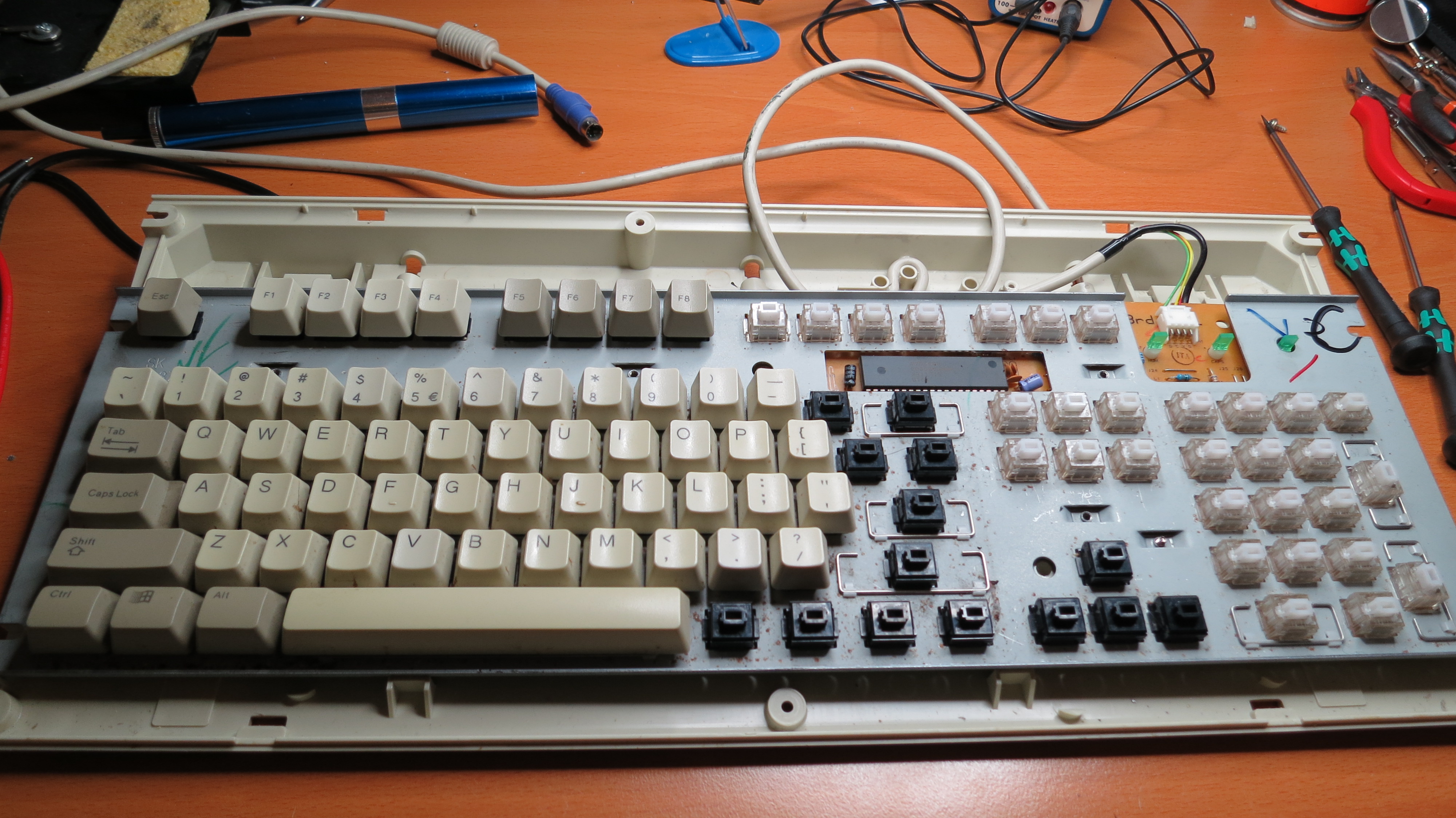

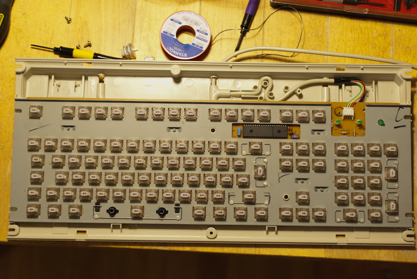

From Dell AT101W to Matias Quiet.
Thanx to Matias for supplying the switches and to qwerkeys for providing my keycap :D

Updated OP with tutorial video.
Comments welcome.
Gonna update the vid soon, I forgot an important piece of info ( how to mount the non standard keys. )

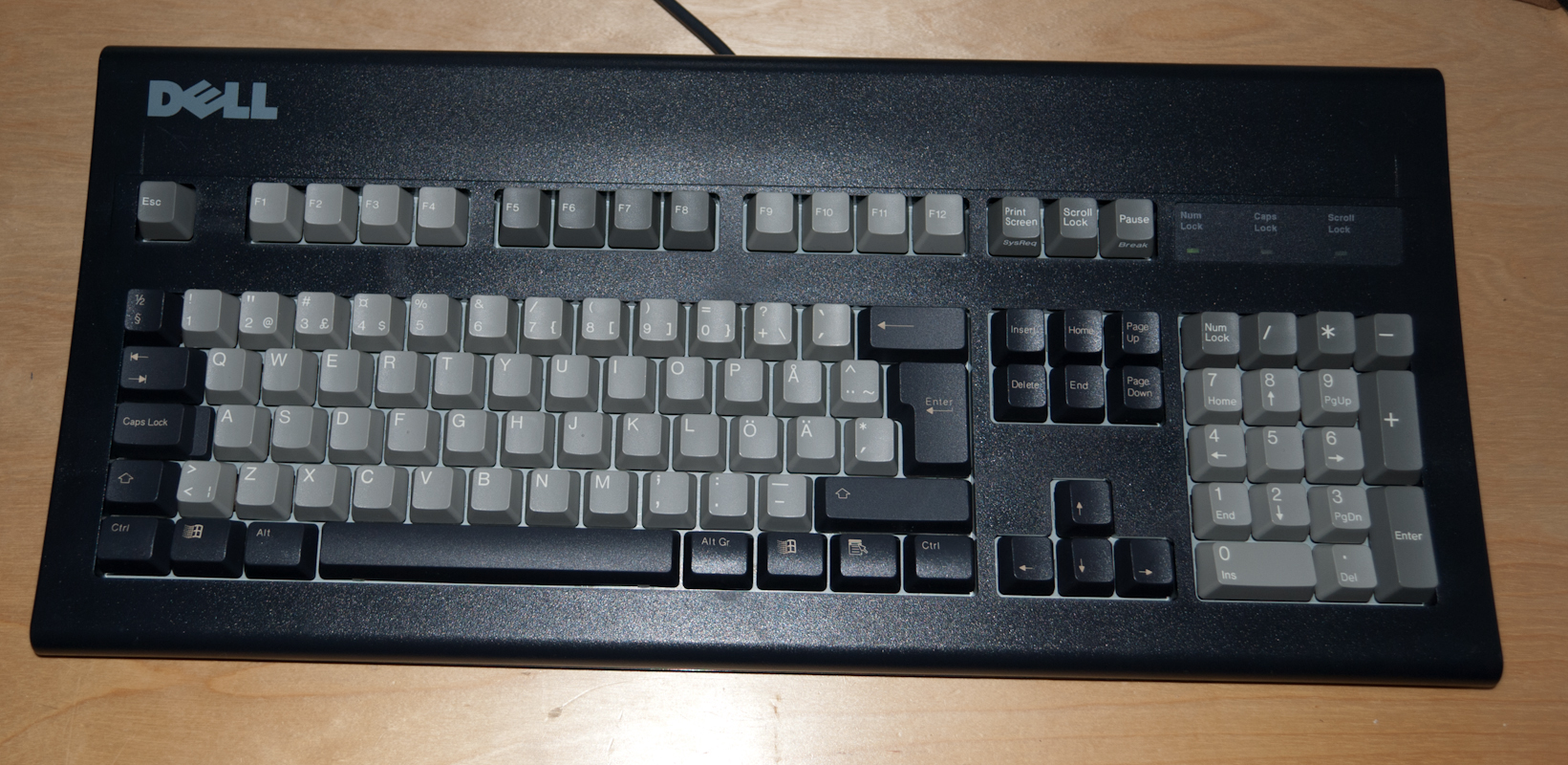

So I finally made me a Dell AT102W mod. The parts are from the electronics recycling bin except for the Matias Quiet switches. The gray double shot keycaps are from a Toshiba T3200SX, the quality is really good and I like the colors too. The best part is that they are in Swedish layout! Something that seems impossible to find for Cherry switches. Sadly nearly all the non 1U keys are of non standard sizes so they don't fit.
I used it at home for a couple of days but it turns out I don't like the switches that much. It's hard to describe what I don't like about them but they feel plasticy, mushy and a little uneven depending where on the switch you hit them. Maybe I could get use to them if I used them longer but I just want to go back to MX browns. On of the switches was very stiff and obviously had a quality issue so I had to replace it. If you buy some of these get a couple of extras in case you get a bad one.

tlt, where did you find the black enter and short left shift? Was it a black AT102W? Never seen one of those before :D
I was going to do the exact same thing. And I mean really exactly the same :p but I don't have the enter and short left shift in black :)
tlt
17 Jun 2013, 21:44
Yes, I it was a black AT102W. I think it's pad printed or could white on black caps be lasered?
18 Jun 2013, 00:12
Pretty sweet, although the stock Dell keycaps look a bit naff. From the icky beige lettering, they're going to be lasered; the beige AT10* keyboards have even uglier lasering. That same dirty beige on black is what WASD was offering until they finally managed to pull of white on black lasering. The only way you're going to do better is to harvest caps from an ISO Datacomp or Focus (they also made white-on-black Alps keyboards) and just find something else to go on the Windows key.
The only other thing I would say it needs is the plate painting black — the white plate just seems odd. Otherwise, that colour scheme is excellent!
I agree with you on the switches not being up to par. They're quite scratchy, and feel more like Dell's old Midnight Grey rubberdomes, although they're definitely smoother. I was quite disappointed that they turned out to be nowhere near as good as Matias's hype, when you consider that even a tinker toy baling wire SMK switch is beautifully smooth and perfectly tactile. (I don't know if the partial binding on non-stabilised modifiers is just a defect with my SMK board, or whether the switch needs some improvement.)
The one thing that stands out with the Quiet Pro itself, not the switches, is the perfectly silent stabilisers. The Quiet Pro is incredibly quiet, so much so that a coworker in the office has it and I'm not even aware when he's typing. It sounds loud when I'm using it, but then I am a very heavy-handed typist, and even then, it's still quieter than other keyboards around me that are further away. In terms of noise level, the Quiet Pro is not hyped: it definitely delivers. I just wish that Matias hadn't based their premium switches on such a shoddy design from Alps.
