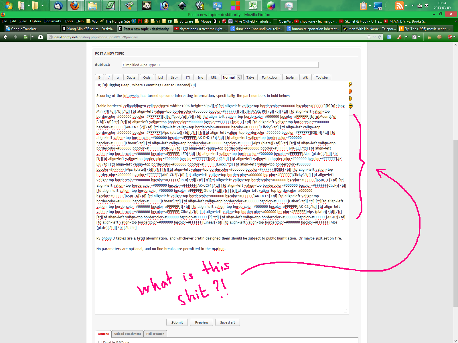

PS phpBB 3 tables are a fetid abomination, and whichever cretin designed them should be subject to public humiliation. Or maybe just set on fire.
phpBB 3 tables suck the smelly ones.png (233.17 KiB) Viewed 1635 times
No parameters are optional, and no line breaks are permitted in the markup.
