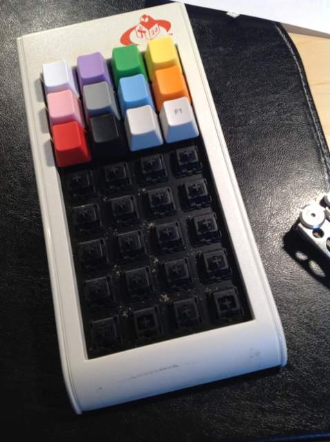

I just picked up a SHS-KM032E-001 on ebay for what seemed like a good deal. I ordered up a PS2 double male cable at the same time and they both just arrived. The cable connector on the unit is 5 pin so I have broken the plastic piece out of the cable and bent one of the pins down so that it inserts into the keyboard. When I hook it up to my laptop with an adapter the adapter is recognized but the keys don't put out any characters. The same happened when I hooked it up to my desktop with the native PS2 (though it is a dell which I have heard can be special). I just opened the unit and it was warm and smelled warm. On the main board there are two places for the cable coming from the PS2 style adapter to connect, but switching it didn't seem to help. Am I missing some piece to get this up and running or did I just pick up some keycaps and nothing else :)

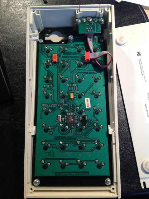

Could you post a pic of the PCB?

Here it is. Any thoughts on the cheapest way to get it up and running?

21 Mar 2013, 12:59
Frank308 wrote:[…] Any thoughts on the cheapest way to get it up and running?
Absolutely no way.
The two red sockets are only for communication between Tipro units, and at least one of the units connected together must connect to the computer via a controller which not only is not present in your unit, but couldn't even be fitted because it requires a dedicated socket (identical to those in your unit but placed at the centre of the PCB, just above the small yellow thing - you can see the traces for it, but no socket there).
So I'm sorry, but what you have is sort of a trailer where the car is missing. It just won't work on its own.
