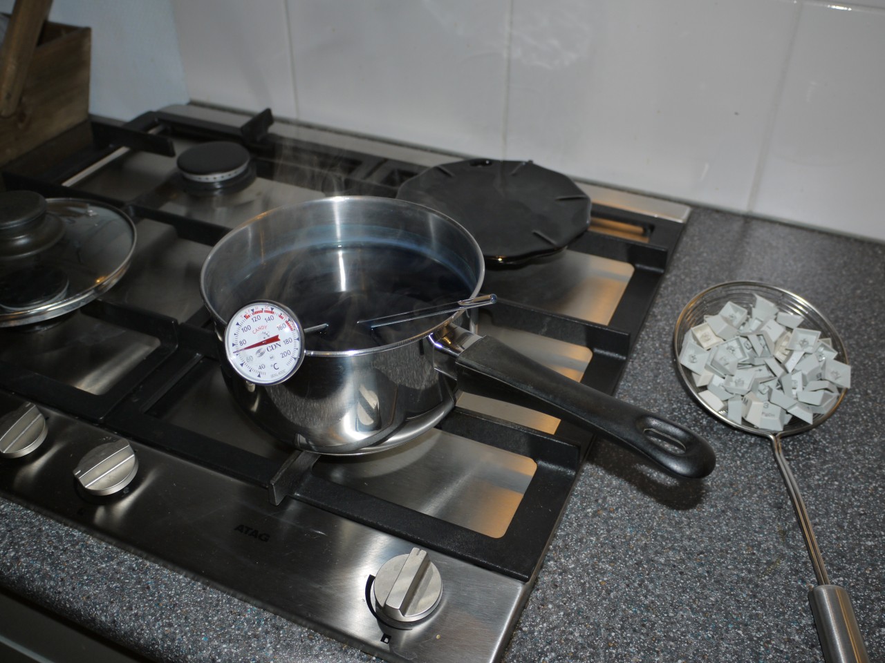

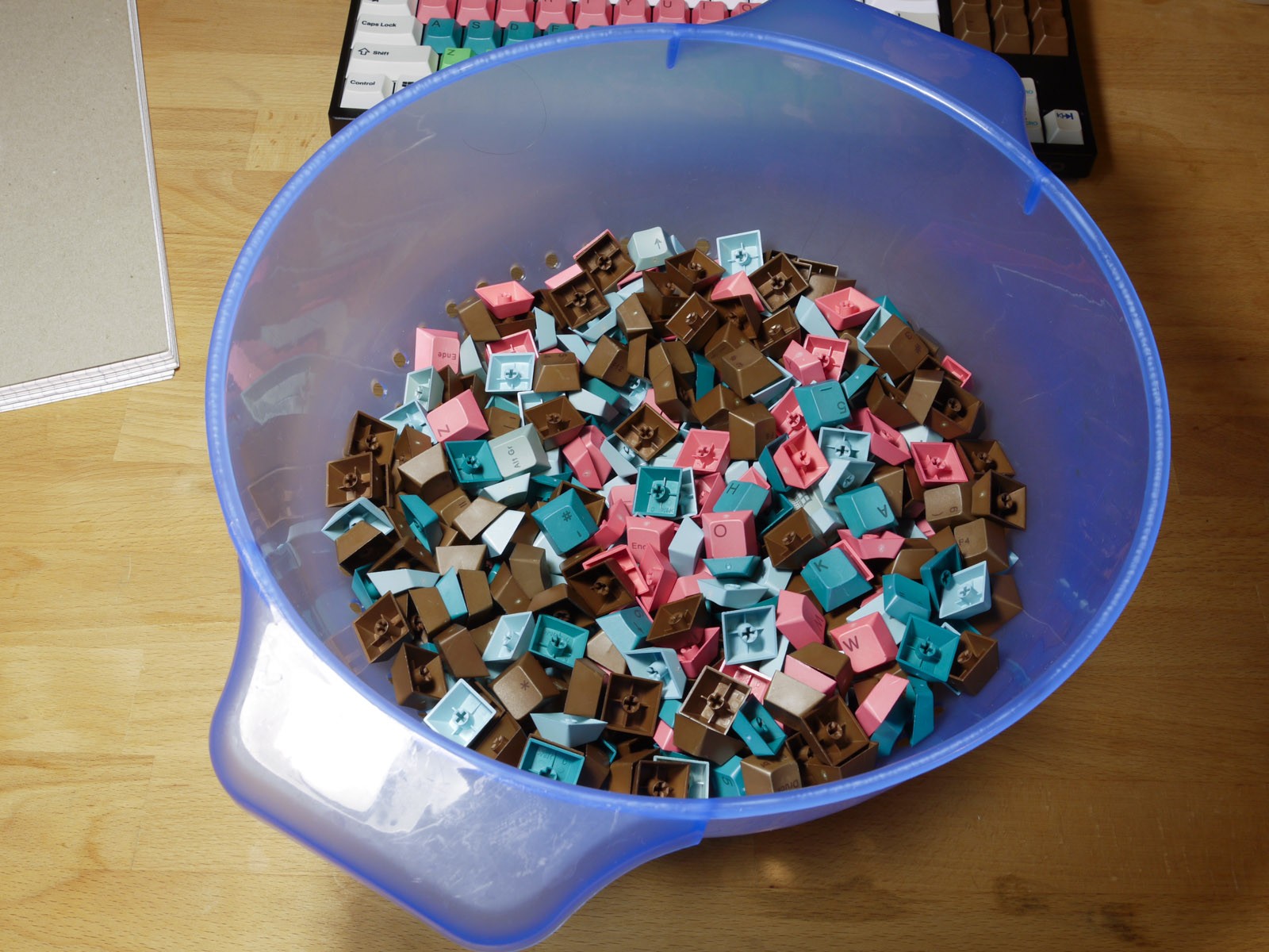

The general procedure was as follows:
The dye (4.5 g Dylon multi purpose) was dissolved in 1 liter of boiling tap water inside a thoroghly cleaned (scouring cream) stainless steal pan. The dye bath was allowed to cool to 70 °C (thermometer) before the clean key caps were added. The caps were fully immersed in the bath with constant, gentle stirring while the temperature was kept at 70 °C. Afterwards, the caps were rinsed with plenty of warm water.

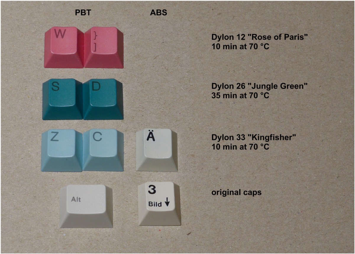

Results:
Dylon 33 "Kingfisher": 10 min contact time resulted in a light blue. An ABS cap hardly cought any of the dye.
Dylon 26 "Jungle Green": 35 min contact time resulted in a deep green-blue.
Dylon 12 "Rose of Paris": 10 min contact time resulted in a light pink.
Dylon 5 "Havana Brown": 35 min contact time resulted in a deep brown with a greenish hue.
Conclusions:
-The addition of salt is not necessary for dyeing PBT caps.
-A temperature of 70 °C seems to be sufficient.
-ABS plastic cannot be dyed efficiently with this method.

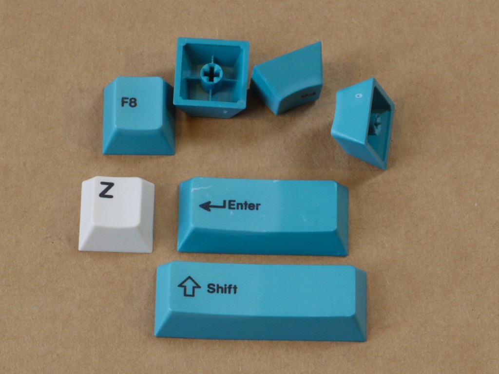

I've tried Dylon on a set of thick IMSTO dye sub caps. Not such a great idea as it turned out...
I followed the recipe of post #1, one tin (4.5 g) of Dylon No 26 Jungle Green in 1 L water at 70 °C. Initially, I was going for 5 min contact time but right away it became apparent that the caps didn't take up the dye evenly. I let them simmer for some additional time hoping that the color would even out. But, alas, the shade difference persisted. See here the result after 12 min.
It's not dramatic but the color difference is very notable even under bad lighting conditions. The areas of the legends display a lighter shade of blue than the rest of the caps. You can spot it on the tops of the 1U keys and especially well on keys that are much larger than their legends, i.e. shift and enter. My guess is that the dye subbing process changes the structure of the plastic or its surface, probably due to some heat treatment.
My only previous experience with dyeing dye-subbed keys were with IBM model M 1U caps. I didn't notice any shade differences there.
BTW, the enter key is a special case. Not only does it have a shade difference but also some some specks that look like plastic defects. Such imperfections are normally found around the sprue marks.

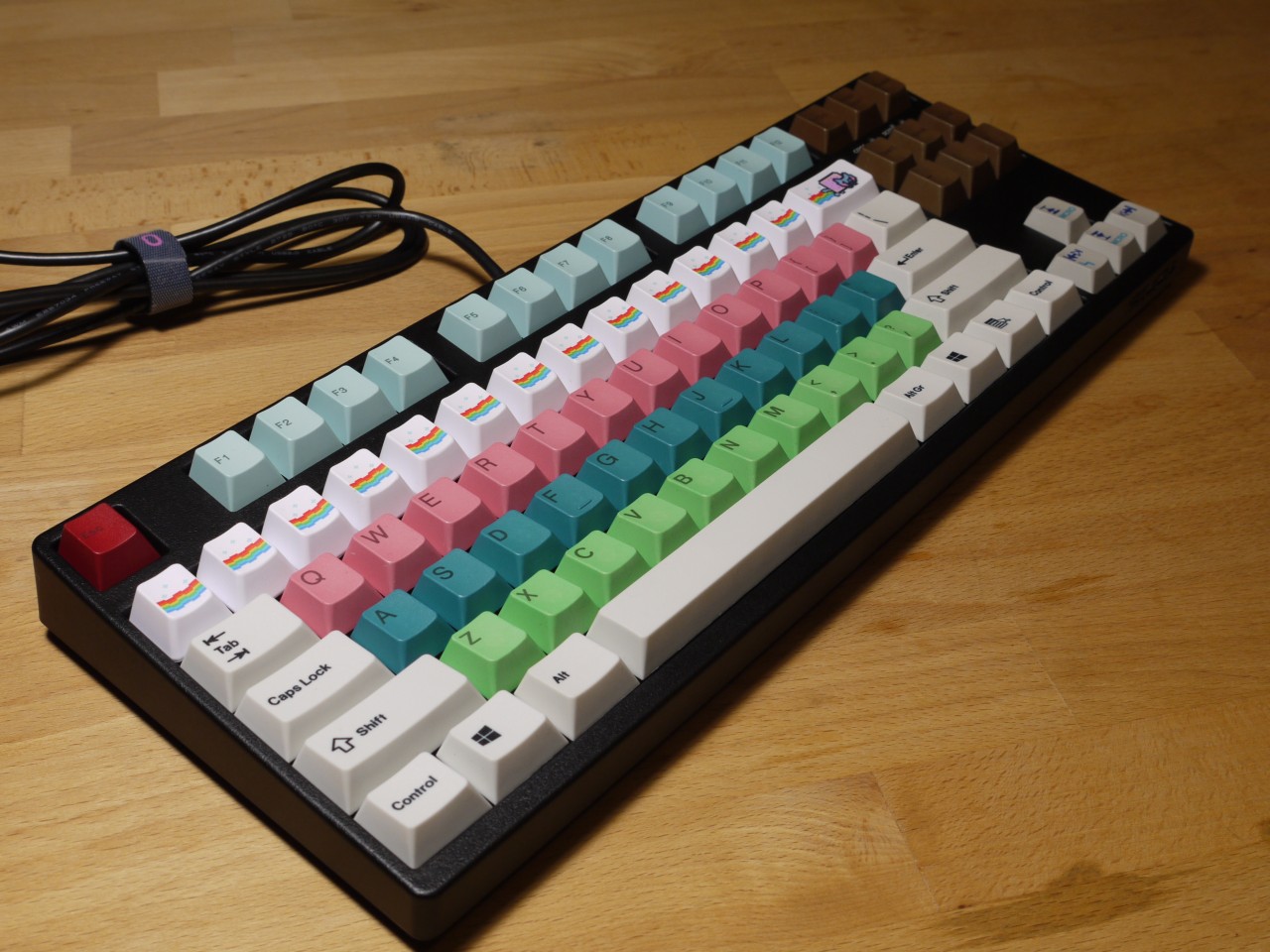

A few days work to get to this...
My take of the handarbeit (it is a DE set but I "adapted" the blue for PO, hence 2 more blue caps):
This was done with dylon:
02 - golden glow
25 - emerald
33 - kingfisher
09 - pagoda red
34 - olive green
15 - windsor purple
39 - tangerine
12 - rose of paris
The purple is very dark, will have to try with 18 - Madonna Blue, if I can find it...
02 - golden glow
25 - emerald
33 - kingfisher
09 - pagoda red
34 - olive green
15 - windsor purple
39 - tangerine
12 - rose of paris
