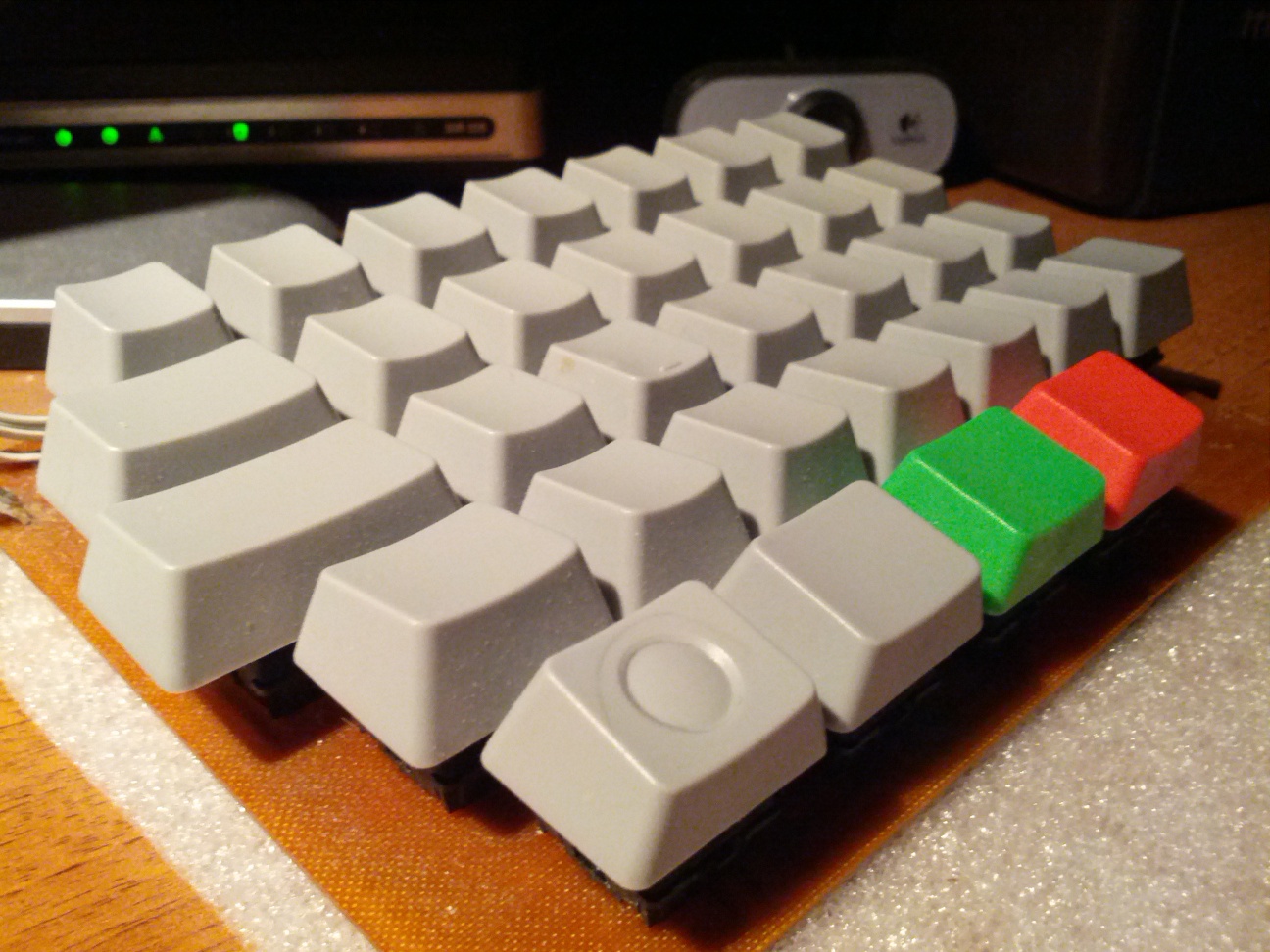

What I added is: [ and ] keys on different sides (not just right), += key in place of CapsLock (pretty frequent key as for programmer). Four keys for each thumb. And Since Cherry MX stems are plus signs I turned those four keys upside down for comfortable pressing.

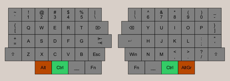

I tried different designs but finally came up with this one (this is main layer):
FN key turns second layer on. Main features here are:
  • arrow keys instead of jkl and i.
  • F1-F10 instead of 1-0

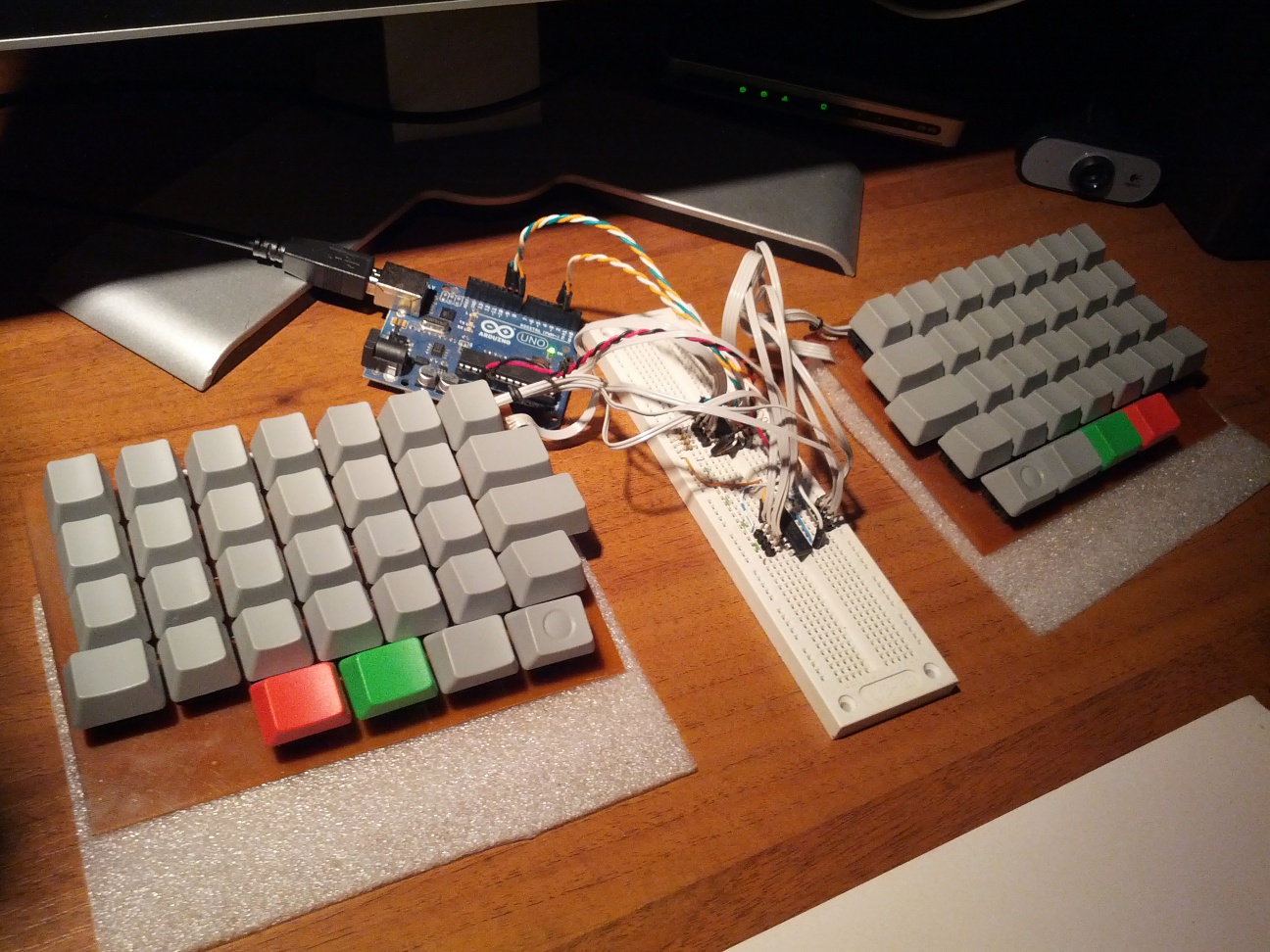

This is how it currently looks:
Keys are PCB-mounted only, without plate, I put a diode in each so there are 4 leads per switch and they keep switches firmly.

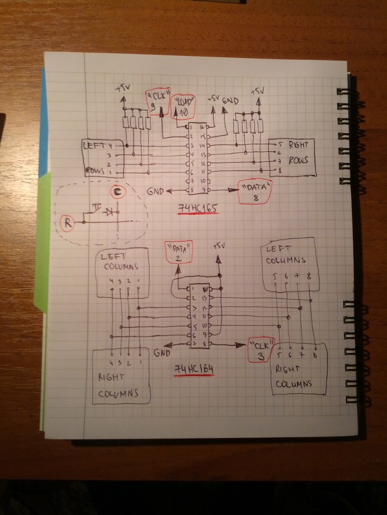

Since there are 64 keys I used 8x8 scanning matrix, that would require 16 free pins on Arduino.
I used two shift registers, 74HC164 and 74HC165, one for input (rows) another for setting a columns which is currently being scanned.
Arduino is driving them and outputs keypresses via USB to host (reprogrammed USB chip acts as USB keyboard)
Each half contains 4 rows by 8 columns so there are 12 wires attached to each board. Breadboard in the middle contains shift registers. and then only 7 wires go to arduino (3 for one register, 2 for another and vcc/gnd).
No problems with multiple pressed keys, 6KRO, Firmware actually remembers more than 6 presses but due to USB protocol limitation sends only last 6 pressed keys.
Next step is to make some case for it, just have to figure out how to do it better.

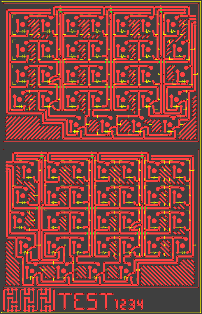

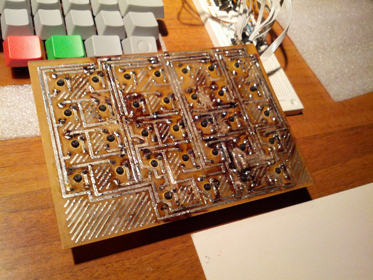

Do you have any pictures of the wiring on the bottom? Did you etch a board, or wire it by hand?

I used etching. Here is PCB design (prepared in ExpressPCB). It is single side with few jumper wires (shown as green):
Since this is a prototype, I used some old material, hence soldering is quite dirty
Also I have added some non-functional patterns to minimize etching solution usage.
Actual look of the back side of PCB (shame on me):

Oohh, third index finger row, have you gotten used to typing on it, yet? :)
12 Apr 2013, 18:19
Great design. Of all the customs that I've seen, this makes the most sense. I'd want Ctrl+Option+Command all in a row for chording (so used to that for adding my own shortcuts in apps on the Mac). But I lift my hands out of home row too much, I know.

Icarium wrote:Oohh, third index finger row, have you gotten used to typing on it, yet? :)
All keys are easily accessible by index fingers, even "|\", it's like pressing "6" with right hand on traditional keyboard.
Plus I find it extremely handy to have "Return" "Backspace" under index fingers.

Fancy sharing the code and the non-keyboard part of the Schematic? I have an Arduino nano sitting here looking for a purpose.

Schematic (I hope it is readable :) ):
Sources can be found here: https://bitbucket.org/chyvonomys/kbem/src/
At the beginning it was a two part solution: firmware sent evens about row/column presses. And there was a program on host computer listening serial port and translating it into OS keyboard events.
For this solution look into arduino/kb0 for firmware, and windows/linux folders for host programs.
Currently it works as USB keyboard so there is no need in host program. All scanning and layer/keycode logic has been moved to firmware: arduino/kb1. However for this to work you have to put alternative firmware to secondary chip on your Arduino UNO (8u2 chip).
Basically you have to put your device into DFU programming mode by short circuiting some pins. And put special USB HID firmware on it. After that it will no longer act as Serial Port so to put another "main" firmware you'll need to put back Serial firmware in DFU mode.
More info about USB HID firmware here: http://hunt.net.nz/users/darran/weblog/ ... art_2.html
On windows I used "Atmel Flip" programmer to put alternative firmware.

My approach with putting USB HID firmware is incompatible with your Arduino Nano. There is another kind of Serial communication chip (FTDI) than in UNO.
I hope shift registers schematic would be helpful though. I learned a lot regarding matrix scanning from this site: http://www.openmusiclabs.com/learning/d ... -scanning/
