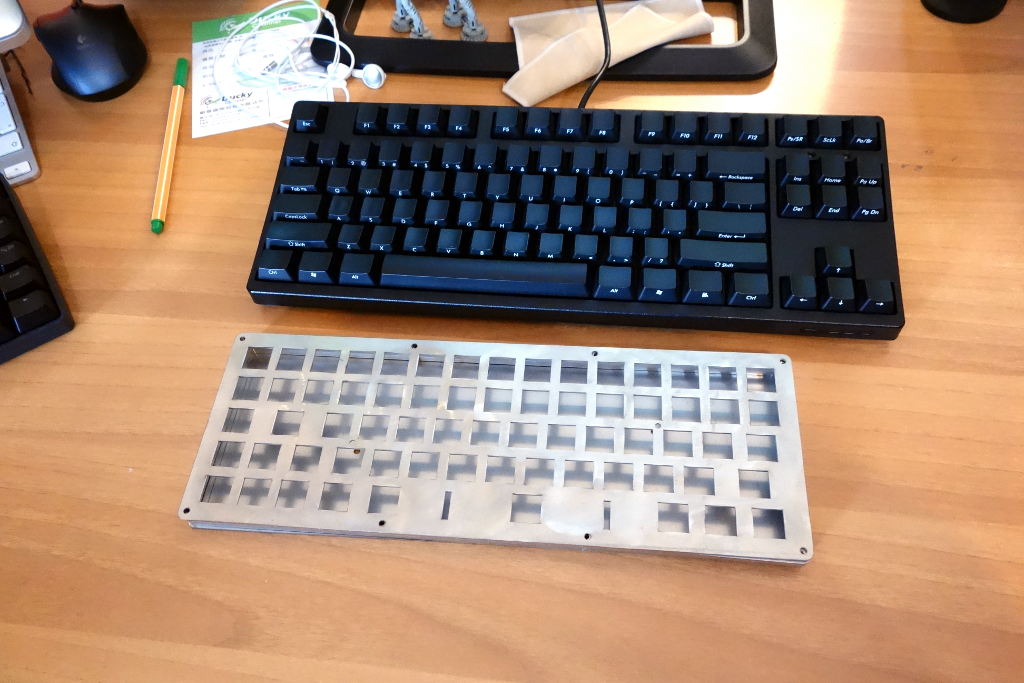

Everything originated from this post. After approx 2 months I've been able to build my first custom keyboard (if you exclude this of course).

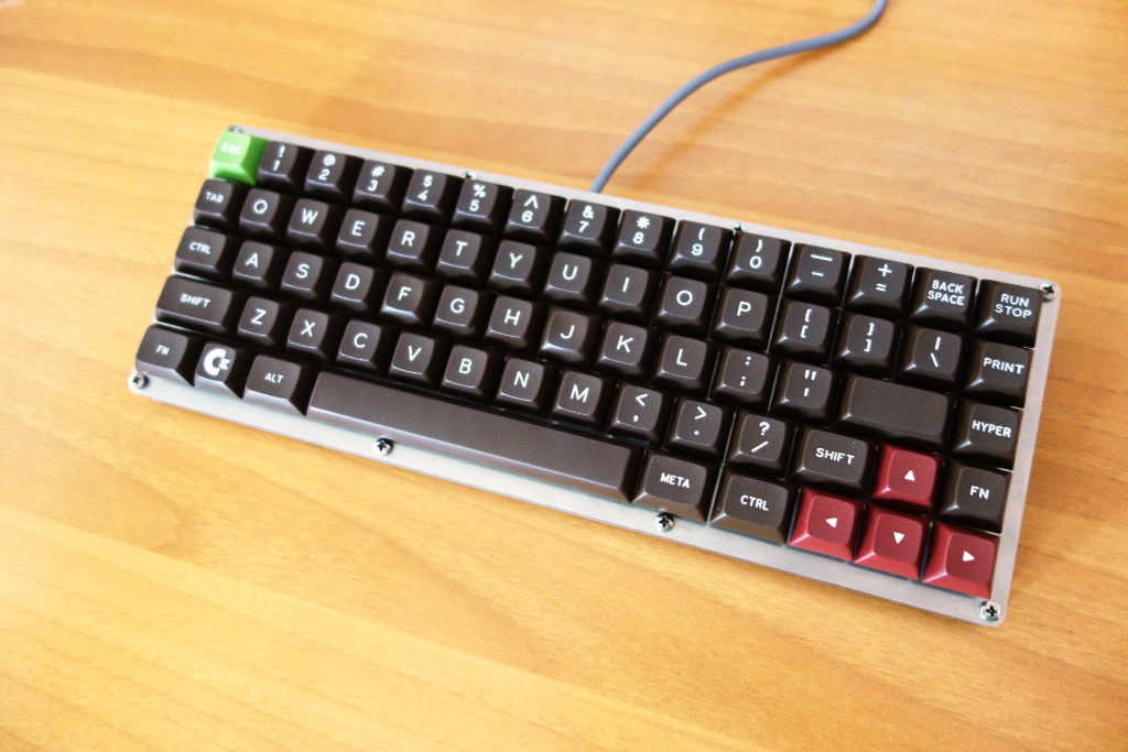

This is the end result. It still misses a decent cable sleeve and possibly better screws, but it's 100% functional (I'm writing on it right now).
As I said this is my first experiment and it has been an entertaining project. Before this I had no idea how to build a keyboard from scratch and I have very little electronics skill, so if I can do it I encourage everyone to try.
The case is 100% stainless steel. I wouldn't recommend using SS actually. It's a hell to work with. If I had to start over I'd probably go aluminum or even acrylic.

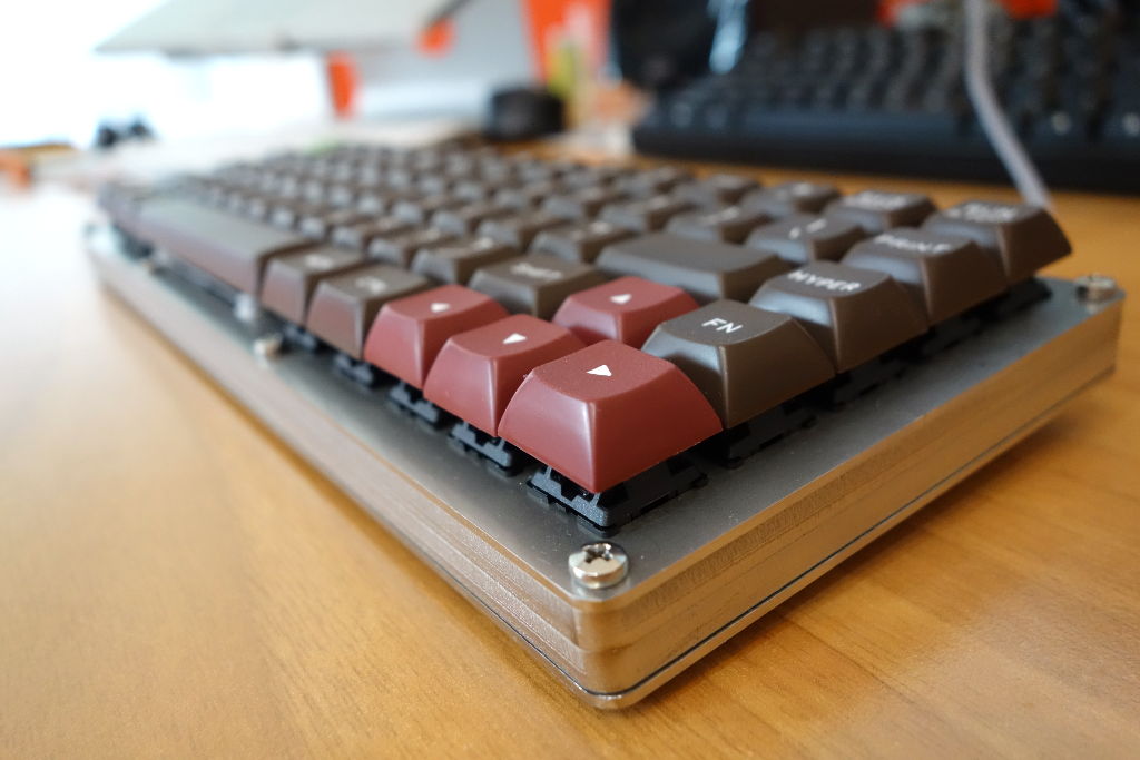

The case 100% stainless steel

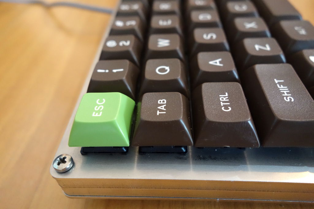

The good about SS is that the keyboard is rock solid, there's no vibration or rattling parts. It's so firm that makes a Filco feel cheap. All you hear is the sound of the switches. Very pleasing to listen.
The bad is that it's really too solid :) After a long session of typing my fingers almost hurt. It's probably just a matter typing with a little less energy, but it's something that must be considered.

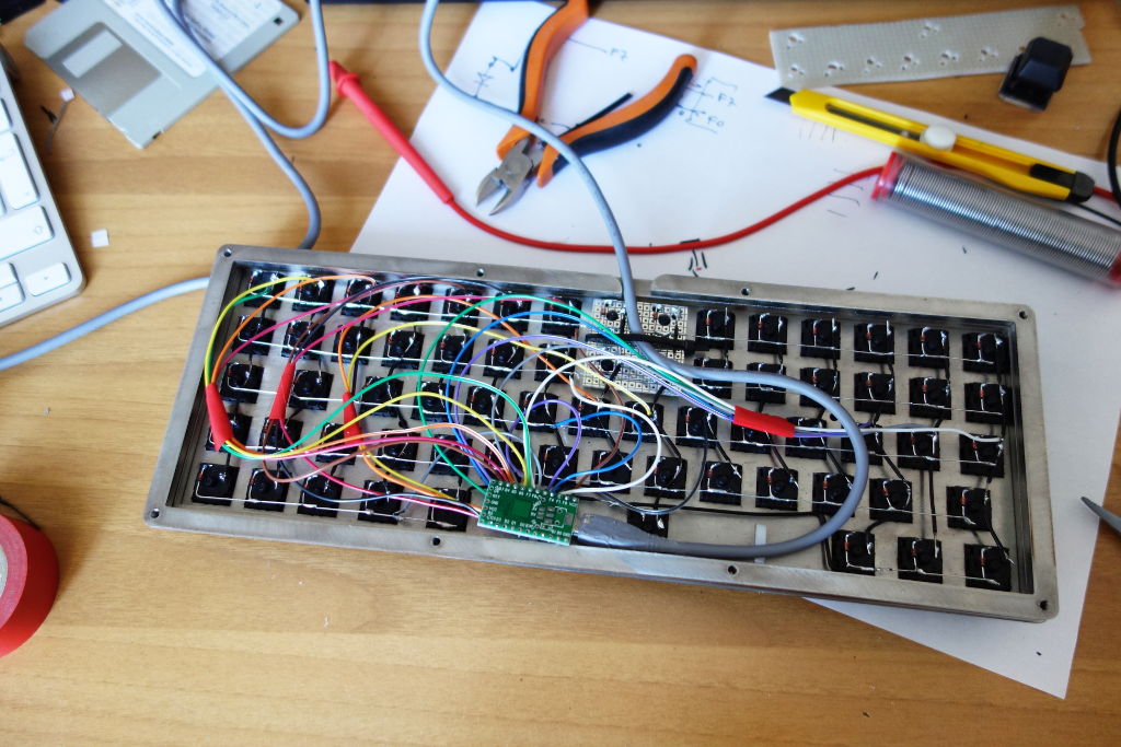

I was not able to find someone who could help me design a PCB so I ended up with wires :)
Wiring and teensy
Wiring and teensy
Being the case all metal I had some problems with shorts, but I've been able to sort them out. Soldering took me almost two days. The firmware is a modified version of the GH60.
