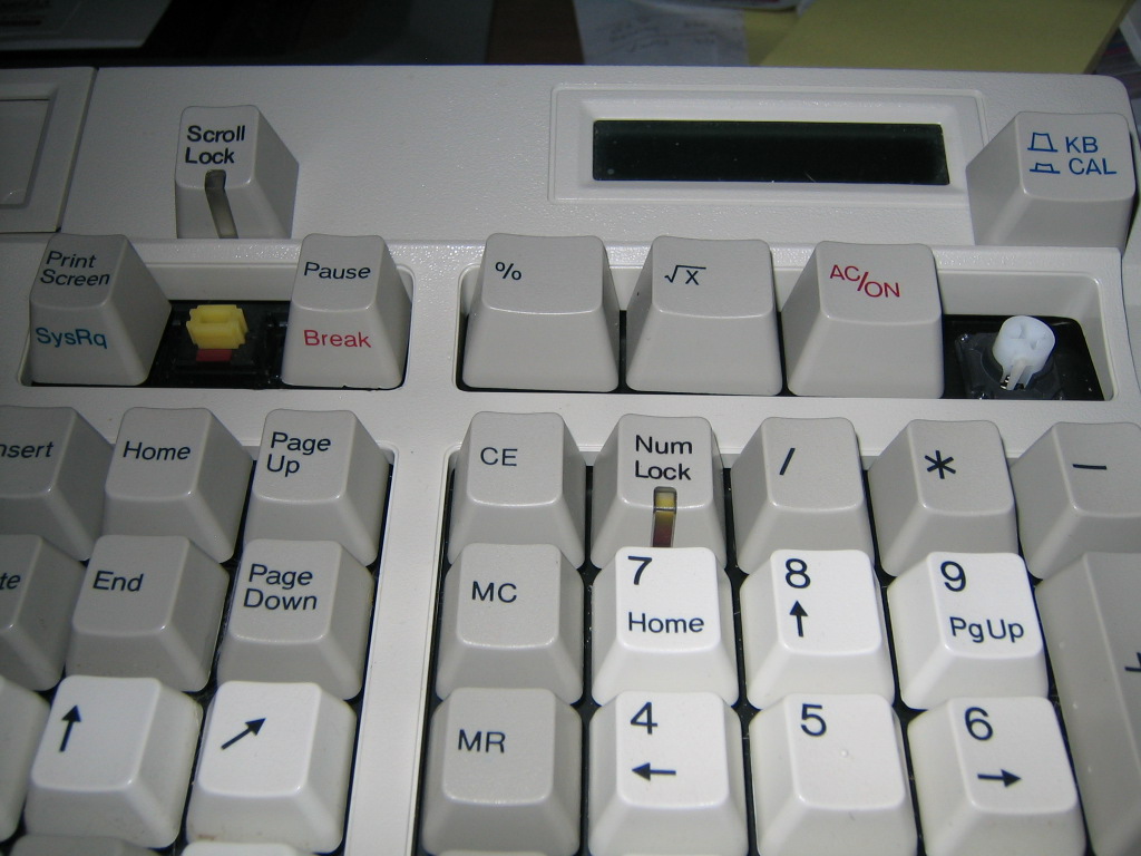

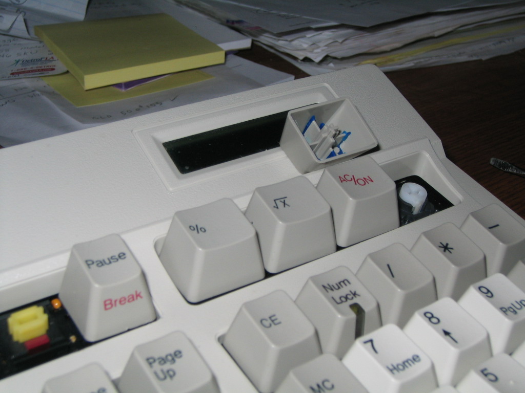

Here are some pics of my 5001 showing integral LED switch (scroll lock) and latching KB/CAL key.
- Picture 018.jpg (180.22 KiB) Viewed 5589 times
- Picture 014.jpg (148.99 KiB) Viewed 5589 times
- Picture 012.jpg (193.73 KiB) Viewed 5589 times

Yeah, the rest of the keys appear to be standard white ALPS, except for the 3 with integral LEDs. Those have yellow posts, as shown in the image above.

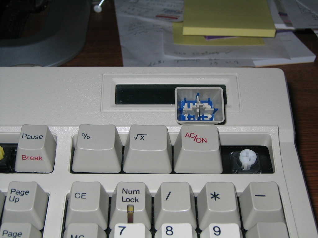

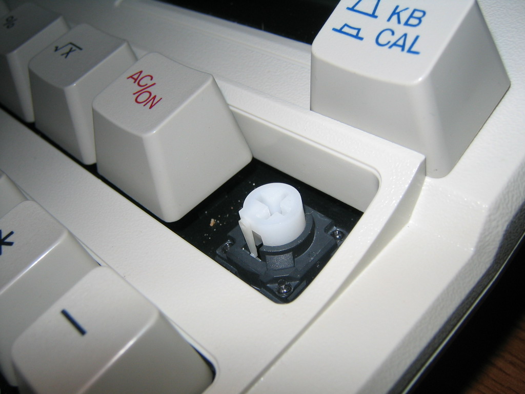

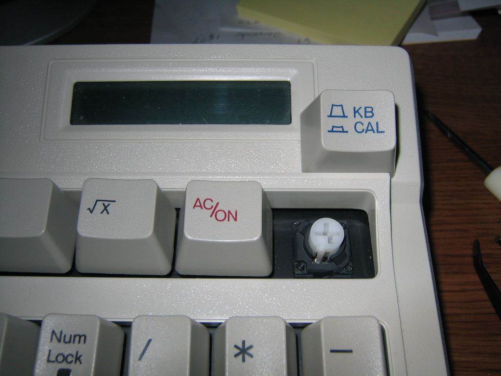

Those are some great photos of the Futaba switch. Could I trouble you for one of the inside of the keycap showing their weirdo mount?

I can't tell from your photos whether the yellow switch is Alps or a clone as there's not enough light; see the following page for a recognition chart showing the difference (real on the left, clone on the right):

Daniel, the yellow switch with integral LED is indeed ALPS (imprinted on top of switch housing).
Below are pics of the futaba locking keycap you requested.
Regarding your last comment, your information regard 5001 is incorrect. As I said in my previous posts, my current keyboard (the one imaged above) is indeed a 5001, and it obviously does not have the LED panel. It's an early model 5001. More pics below.

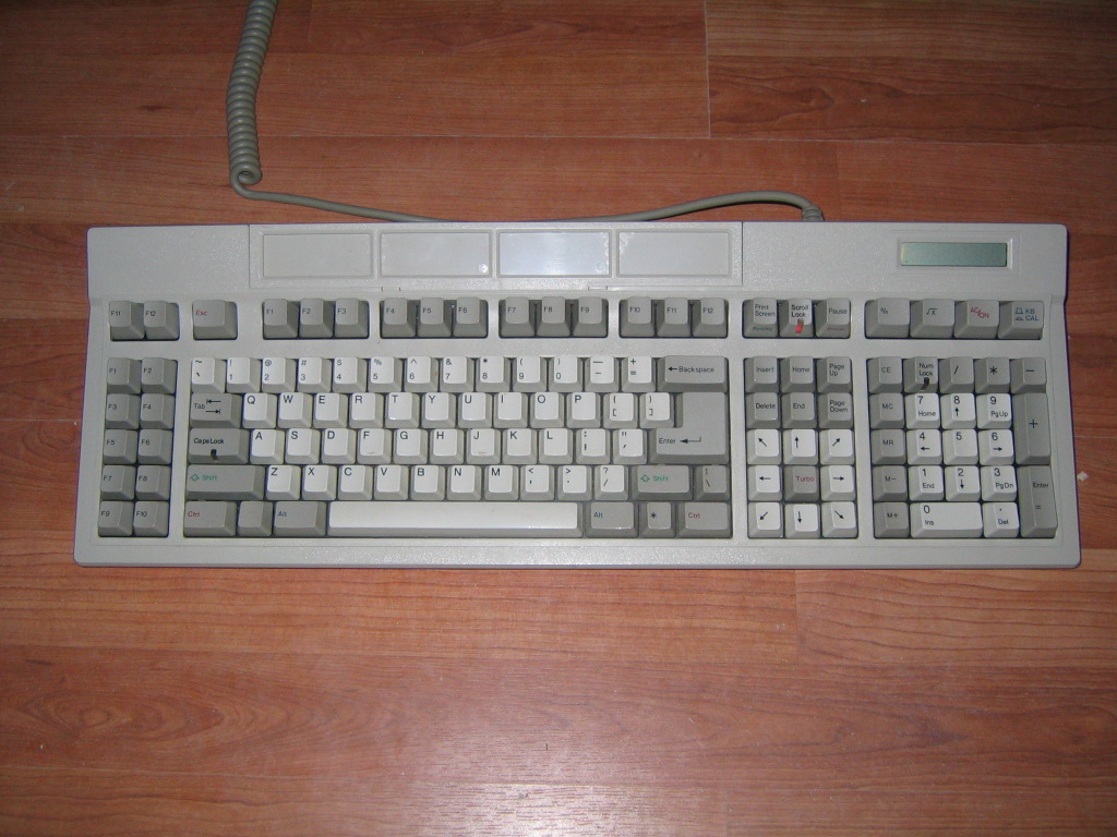

I also have two later model 5001's (both of which have failed) that do have the LED panel. Those keyboards match the images shown on the 5001 wiki page. Instead of the Futaba locking switch to turn on the calculator, they have separate KB Lock and CAL Lock (momentary switches) with a 4th LED (in the LED panel) that lights in calculator mode.

- early model 5001.jpg (234.53 KiB) Viewed 5540 times
- early model 5001 label.jpg (171.3 KiB) Viewed 5541 times
