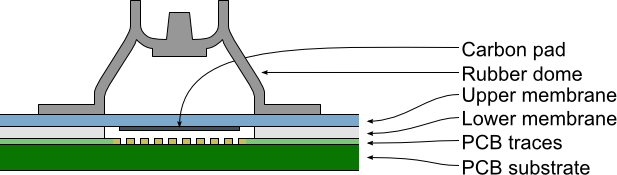

16 Jun 2013, 00:59
This is my guess:
Topre guess.png (24.14 KiB) Viewed 10292 times
(Scale is kind of out, though …)

I think that's pretty accurate. The membrane is comprised of two very well stuck together sheets. The only thing that's missing is the carbon pad on the dome.

If I understand this correctly, the keyboard should function correctly without the membrane sheets (since the domes already are conductive themselves), but they added conductive membrane sheets as well for some unknown reason? (I didn't draw a carbon coating on the dome in the diagram as I wasn't sure about what I was looking at, and it didn't, and still doesn't make sense as a design.)

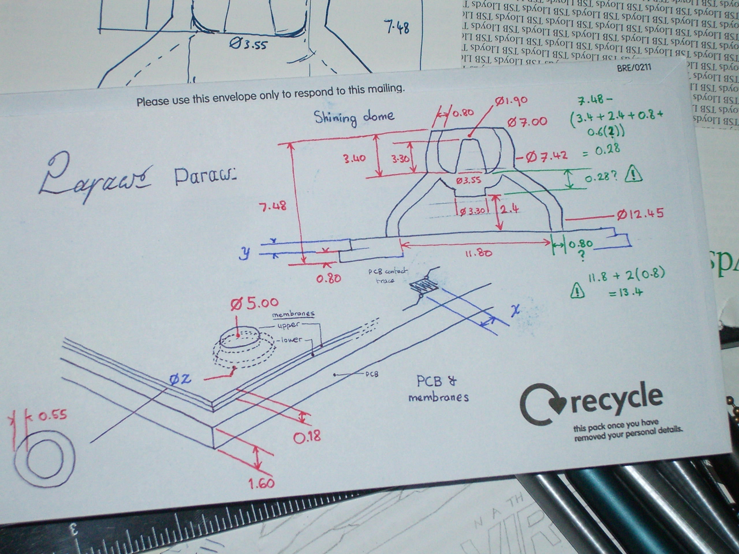

Quick back-of-an-envelope sketch, complete with annoying smudge. Dimensions x, y and z are missing. The dimensions of the dome don't add up.

Ok so:
y is roughly 0.5mm high. Note that these sections don't go completely up against the walls of the dome - this image illustrates what I mean:
x is 5.3mm wide and ~4.9mm high. The circular points in the top left and bottom right are ~1.5mm in diameter
z I am not really sure what I'm supposed to be measuring?
Some other things:
- Where you got 0.28mm in the top right with an exclamation point, shouldn't the equation be simply 7.48 - (3.4 + 2.4)?
- To explain the other exclamation point (13.4), the thickness of the dome itself is not 0.80mm. It's not really possible for me to measure it with any degree of accuracy but I can tell you now it's not that thick. If I were to give it a very rough guess...I'd say it's probably about 0.325mm
21 Jun 2013, 00:45
So you mean that the outer wall of the upper well is 0.8 mm, while the outer wall of the lower well is only 0.325 mm?
z is the diameter of the holes in the bottom membrane, but for some reason I got mixed up between bottom and top.
