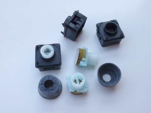

I think that I could have Key Tronic foam and foil sliders, where the foam still has not deteriorated.
However, the parts are packed away, it is quite a bit past midnight over here and I really have to go to bed and I will be busy in the morning. I will post pictures of what I have, but you will have to wait a day.
20 Jun 2013, 19:51
Does this seem like the same kind of switch? Mine have rubber sleeves, but I know that there are also Key Tronic foam-and-foil switches with coiled springs.
If yes, then let me know how many you need and I'll send you a quote for postage.

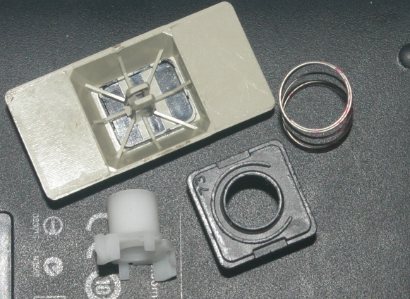

20 Jun 2013, 22:38
Nope, not quite the same. Give me a couple minutes and I can get some pictures, it's quite a stupid setup.

Hmm.. I just noticed something I had not seen before: the foam pads are not glued on, they have a sheet of plastic on the opposite of the mylar, that are snapped in place on the sliders. 11 mm in diameter, 4.5 mm thick.

That actually looks to be the same now that I take one of the switches apart, only mine's using a spring rather than a rubber dome.
21 Jun 2013, 01:39
BTW, I don't know how my sliders have acquired a blue tint. I think they must have done that while sitting in the zip-lock bag that I have stored them in.
I don't think that I have 101 sliders. I am sure that I must have lost a few.
Heh, those cost $73 + postage and here I am about to give mine away for free ...
Just be prepared that international postage from Sweden can be a bit costly, though.
