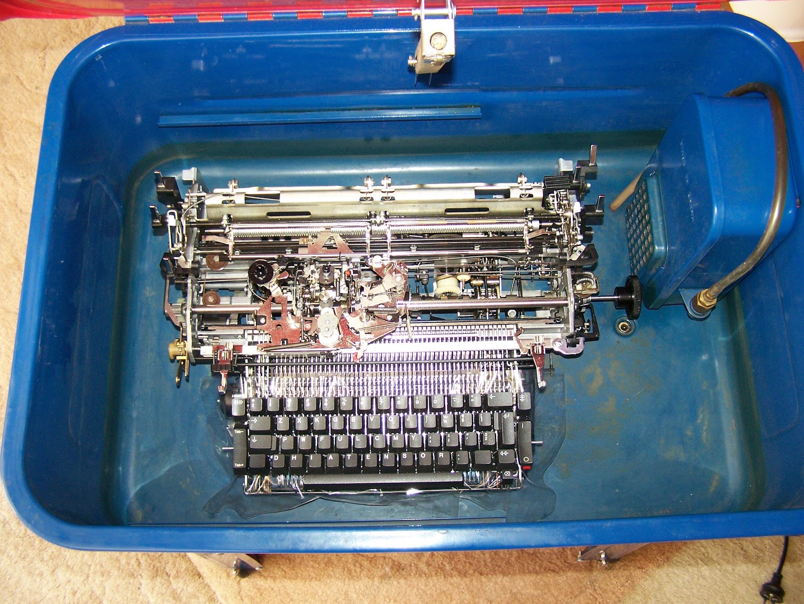

'Selectrics' rescued from the trash probably need one of these :
A gasoline-bath !
(I have a picture of a Selectric in gasoline somewhere, will post it when I find it !)

Gasoline??! Wouldn't that also remove all the oils and lubricants?

Half-Saint wrote:Gasoline??! Wouldn't that also remove all the oils and lubricants?
That's the idea.
You remove the old gummed up lubricants, and then relubricate it.

What about the horrible smell of gasoline? Does it wear off?

Mineral spirits or kerosene would also work (and would probably be kinder to the plastics, too?)
http://groups.yahoo.com/group/golfballt ... ssage/4245
