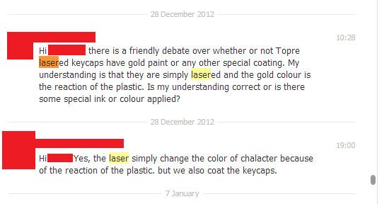

Where did you hear about this?
I asked a representative at Topre a while ago directly how they achieve the gold colour on their legends and was told that it's simply lasered with no infill. Besides, the legends on their lasered caps wear away so quickly that there's no way they're dye-subbed. I think there is just some wishful thinking out there that Topre would never stoop to some peasant level marking technique but, really, I don't think there's anything special about them.

Here we go:

002 wrote:Where did you hear about this?
Your own wiki page on the Realforce! ;-)

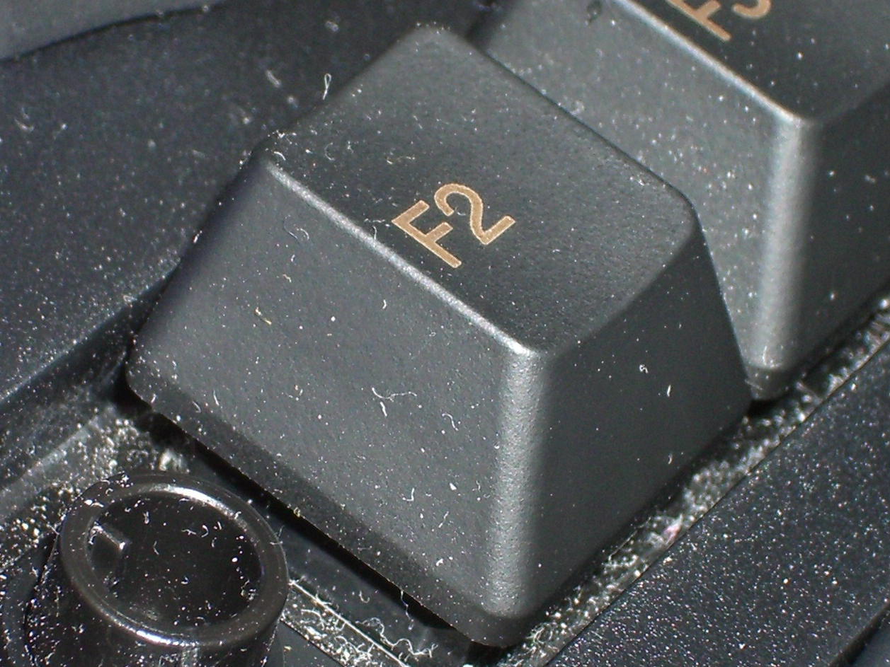

This is the closest I've got:
Topre gold legend detail.jpg (237.28 KiB) Viewed 1935 times
Not sure why the lettering has that white outline. I don't have the keyboard to hand.

Hmm... I'm no laser technician but could the outline simply be a temperature variance (cooler) at the edges?

Ah, it's my mistake. Most dark grey ("black") Realforce keyboards used black on dark grey dye sub, right? But European dark grey Realforce keyboards (i.e. 105UB) used lasered legends. It's a European model peculiarity, and I didn't spot this discrepancy in the Realforce Model Reference table.

The thin white margins around the lettering is not a trick of the camera, although it's only barely visible to the naked eye.
