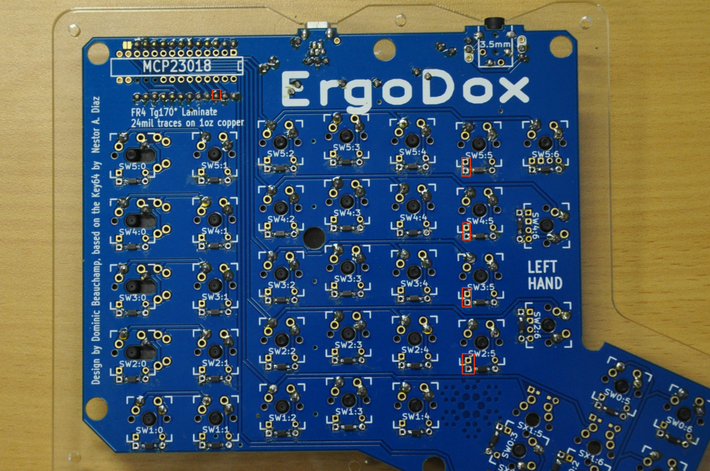

I finished assembling the right hand almost three weeks ago but only now got to asking for help... the problem is that an entire column of four keys is not working. How's that possible? I used somebody's premade layout for testing.
Things I checked:
- switches are fine
- diodes are oriented correctly
How do you check, if the diodes are fine? Anything else I should look at?

I'd suggest to check if your circuits are fully connecting all of your pins with something like this: Image

The column is one long line on the PCB that starts at the last switch on that column, passes every other switch in that column (without being interrupted by the switches), and then ends in one pin of the teensy. So if the whole line dioesn't work, you want to make sure there's 0 Ohm between the end of the column and the respective pin on the teensy ...
I'd say the most likely point of failure here is the connection between PCB and teensy for that special pin. Did you measure that?

Well.. I did a continuity test and I got the whole column to beep. It terminates in Teensy pin B1. I also tested what's labeled as SW0:5 and it checks out fine.
If this isn't the cause, what could it be?

When I think about it... this test doesn't make any sense because it'll work even, if nothing is soldered to the board. It's basically just testing the traces on the PCB for continuity. Doesn't help find out why the switches aren't working.
I tested the diodes and they check out fine. Orientation is correct. Seriously, WTF?

That's pretty much exactly what it is: just a test of your solder joints on those traces. I think there might be something wrong with the Teensy on that pin, or at least how it connects to the PCB. You could try desoldering it for another go. (Or pulling another Teensy out of a drawer, just to rule it out…)

If a whole column of switches isn't working, I'd say it's not really probable that it has to do with failures of the switches themselves. Like Muirium said, what I think you want to check is the solder point that connects PCB and teensy (or even the controller on the teensy) for that column, and also that the PCB trace of that column is insulated against other signals.

Halvar wrote:(or even the controller on the teensy) for that column, and also that the PCB trace of that column is insulated against other signals.
Holy crap, I found it! I tested for continuity between B1 and the controller and there was none! All I needed was a little bit more solder on the B1 pin om the top side.
Now it works! Thanks guys :)
