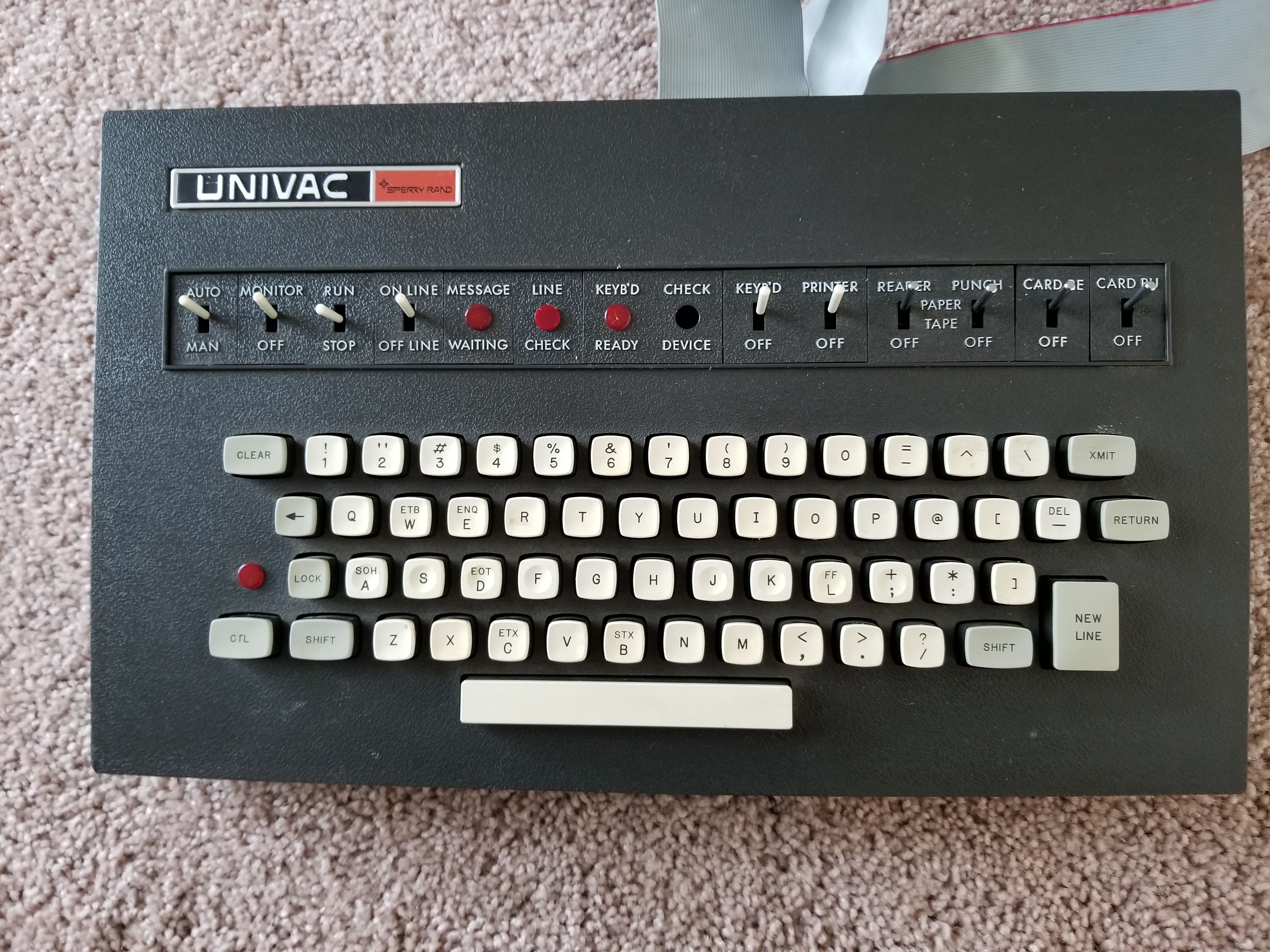

mistermarc
28 Apr 2017, 18:24
Hello all, I have a keyboard very similar to this one. It is model f1308-00. Does anyone have any information on these, there is very little to go by searching Google. Thanks
