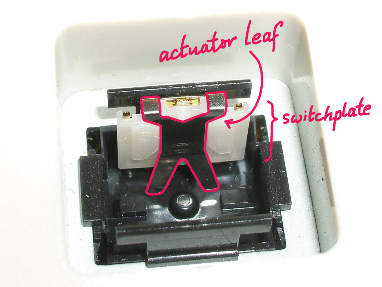

I don't think Xiang Min ever used a classic (wide, steel) click leaf, as their switches date from 1997 onwards. We know Himake used these click leaves, though I've not tried to see if they fit. Most Alps clone switches use narrow phosphor bronze click leaves.
How does one define "ghetto blue"? Blue switches have a very special feel — a sharp tactile feel over a gentle spring. This soft feel is specific to early generations of Alps switches. My theory is that the first branded generation (white/salmon) increased the strength of the actuator leaf, and that's what gives them their balky feel:
Alps switchplate and actuator leaf.jpg (118.44 KiB) Viewed 5500 times
White Alps switches have a weird erratic "will they won't they" feel where you're not sure whether they'll depress or bind. I get the same issue using blue Alps components over a black Alps switchplate and base, which is why I suspect that the switchplate is responsible for the poor feel. Blue Alps are butter smooth, but they still suffer from a bit of binding. It may be that Alps clones tend to be stiff for a similar reason; I've never tried swapping springs and click leaves between Type IV (early Himake?) and blue Alps. (Type IV isn't that bad — nowhere near as bad as later Himake and Xiang Min variants — it's a lot like white Alps in feel, but more reliable.)
I am not aware that anyone in the community has ever measured the individual force contributions of the click and tactile leaves, return springs and actuator leaves and determined their relationship to overall switch feel. As such, nobody knows what the recipe is for ghetto blues. Trial and error is needed, and a whole pile of spare keyboards :)
The only company who is likely to have attempted this in detail is Matias, whose tactile switch is significantly better than a genuine salmon or black Alps switch. Matias quiet switches do achieve that desired balance of a strong tactile event over a soft spring (they're basically what Cherry MX clear wanted to be, though I do enjoy clears for what they are). They're also fairly free from binding — they come quite close to the wide range of keystroke angles and impact forces you expect from Cherry MX and Topre, but not with 100% smoothness. I have my complaints about them, but for a first attempt they've shown up a lot of companies' work.
I don't know how their click switch compares as I've never typed on one. Still waiting for a PC Quiet Pro to be made and then I'll be buying one as soon as it comes out. Do want! I have some loose Matias switches (four of each kind), but squeezing and prodding those tells you very little.
Hope you are suitably confused and dazed now.

Well I used a wide style click leaf from a matias - not a narrow XM style clone.
The switch plate was from an orange switch, which from the pictures appears to be the same as a blue switch plate, with a longer back plate when compared with later whites/salmons/blacks etc; hence why I say its a ghetto blue as opposed to a ghetto white!
I did notice last night when looking at click leaf diagrams of blues/whites there is some extra metal on the back of the click leaf which is not present on the matias leaf.
Credit to Ripster for the photo. (which I have massacred with badly drawn beziers)
The bit of metal is the curved oblong node where the clicking part meets the back plate. I guess I could harvest some old whites to put in my orange housings for "true" ghetto blues.
