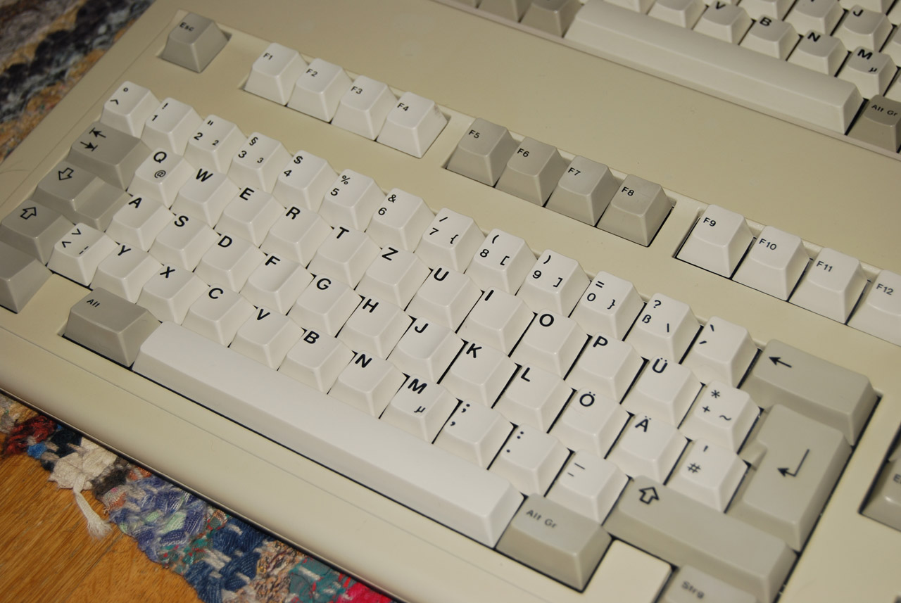

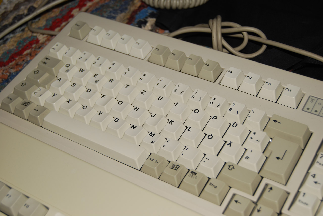

Been going a bit nuts with retrobright the past couple of weeks, here are the keycaps of a heavily yellowed G80-1000 after a couple days treatment! The case of the G80-1000 is still untreated. Look at the spacebar to see the difference. A non yellowed G80-1800 with the same type of keycap (doubleshots) was photographed with the same settings for reference. This stuff is truly amazing!
The pics look a bit weird (I think the white balance is off?), but I didn't want to do any Photoshop magic to them, just concentrate on comparing the keycaps of the upper and lower board. :)

ripster
07 May 2011, 20:28
Nice - did you do the keys in a jar trick outside or some other way?

intealls
08 May 2011, 02:40
ripster wrote:Nice - did you do the keys in a jar trick outside or some other way?
Sorta, I just put some aluminum foil in a cardboard box, threw everything in a glass bowl and lit the thing up with a low-wattage UV-lamp.
Not as quick as placing it in the sun, but it does the trick. I think I left the cherry keys in there for about 30-40 hours. It takes a while, but the results astound me every time. This is the third set I've done. The two previous ones were from SP (one was extremely yellowed, even worse than the FK board). Turned out like new!

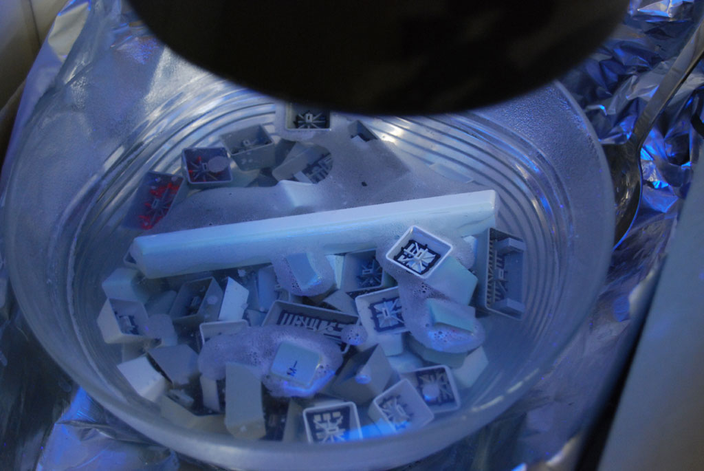

Prelim
13 Nov 2014, 23:12
some photos from my retrobright session (hydrogen peroxide ~10% recipe), just did about 4h UV light + 4h sun:
comparative w/ calibrated whites between the 2 original photos (watch for less yellowing on function keys for instance):
From this experience I think that the most important factor isn't the H2O2 percentage but the time itself... unfortunately I didn't make it a non-stop reaction, as I've stopped the UV overnight and continued the day after in sun; I've stopped again and in the 3rd day there were no more O2 to react, so overall I just did 8-9h maximum :(
problems encountered: I was freaking out with floating caps as I ideally want to kept them underwater. So I've put some adhesive tape in the box bottom and made some beautiful keycap rows... needless to say that 1h after, all the caps were floating again lol. I just stirred the caps again and again every 30min, to make sure the ones floating weren't drying in the process. Lesson learned: think on one solution for making stay the caps underwater, I think the best one is to put the caps settled on a MY pcb, if you can.
my advice to everyone who want to try Retrobright: do not stress too much about the perfect % recipe, just make sure you get a non-stop reaction and preferably 24-36h minimum to ensure maximum performance and supreme results!
