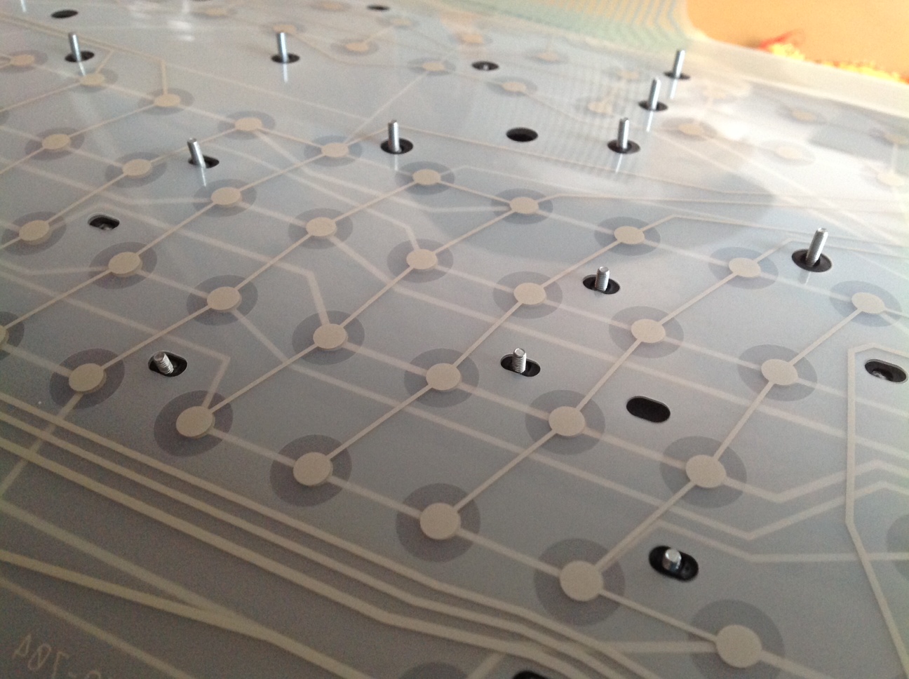

Anyone know some diodes that could fit in here?
photo 4.JPG (282.12 KiB) Viewed 15286 times

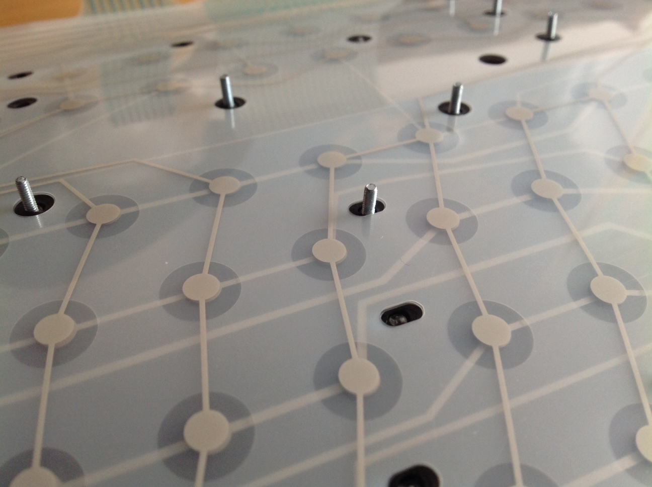

That's all three layers of the membrane in place, lined up on the freshly fitted bolts. All the layers are translucent, so what you're seeing is the column layer above the perforated layer, with the rows underneath.
photo 5.JPG (346.22 KiB) Viewed 15281 times
When the keys are pressed, the springs buckle and their hammers press these layers together, closing the circuit. The trouble is there are no diodes in this matrix, so it's far from NKRO. In fact, I run into rollover limits quite frequently just using routine shortcuts like Shift + Ctrl + Arrow Keys, which means this giant board is 2KRO!
My idea is to put diodes into the matrix. The obvious place (to an electronics neophyte like me) is right in the air gap in the middle of those layers. That needs some kind of thin film diode. Anyone seen any such thing? I know that diodes can be truly microscopic in size (there's a ton of them inside any logic chip) but are they available? It would need to be thin enough to still leave enough of a gap so that the key isn't permanently detected as pressed down, of course!
This is just at the wild idea stage. Other pitfalls include the IBM controller. The membranes could be hooked up to a Teensy instead, to end run any inherent rollover issues in this controller, or allergies to the voltage drop that diodes would bring. (Jabbing a regular diode's legs into the controller's sockets for rows and columns does work. I get characters showing up with it one way around, and nothing when reversed. So I don't expect this to be a problem, but who knows.) I'll also note that I'm not demanding full NKRO across the keyboard (especially if these imaginary diodes wind up being expensive), but putting diodes into choice weakspots on the matrix like the mods and arrow keys.

That would require very thin diodes indeed, and they would need to have a rather large surface area. They could be made possible by the same techniques as OLEDs. Organic diodes, maybe even printable. Still rather hypothetical for a hobby project like yours. And then there's the reliablility: I doubt that organic diodes would survive 10000 key presses.
It would probably be easier to fit in some SMD diodes in the conducting traces of the mylar sheets. The top sheet would probably work best because the rubber sheet gives you some slack there.
All in all a very daunting project.

You're probably right about putting diodes right in the jaws of a switch. Perhaps making a whole new membrane layer to replace the column sheet (closest to the rubber), with diodes included, is doable these days. I'd rather not take my clumsy chances modifying a working one. The board's really quite nice now besides its dodgy decisions in rollover.

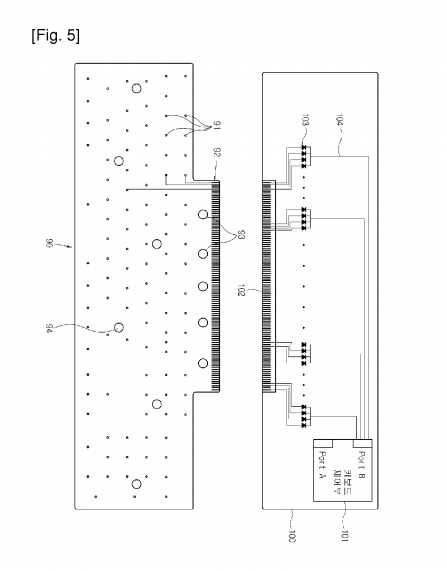

Meanwhile Skydigital nKey-1 solved the problem with brute force :D
http://en.skyok.co.kr/product.php?code=605
http://patentscope.wipo.int/search/en/WO2009119947
Arakula
14 Nov 2014, 10:22
I'd be very interested in how this 2009 patent application holds up. Adding a set of diodes to the keyboard matrix to prevent ghosting definitely falls under "prior art".
