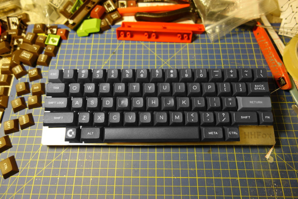

25 Nov 2013, 01:05
matt3o wrote:Image
Lid from an old record player?
What do you do with the acid afterwards? Can it be reused?

-[°_°]-
25 Nov 2013, 08:47
Findecanor wrote:Lid from an old record player?
ahah, yes :) I use for all kind of keyboard related experiment :) (eg: retr0bright)
Findecanor wrote:What do you do with the acid afterwards? Can it be reused?
unfortunately it can't be reused.

HHFox Black :lol:
GBq8Xub copy.jpg (393.66 KiB) Viewed 18862 times
