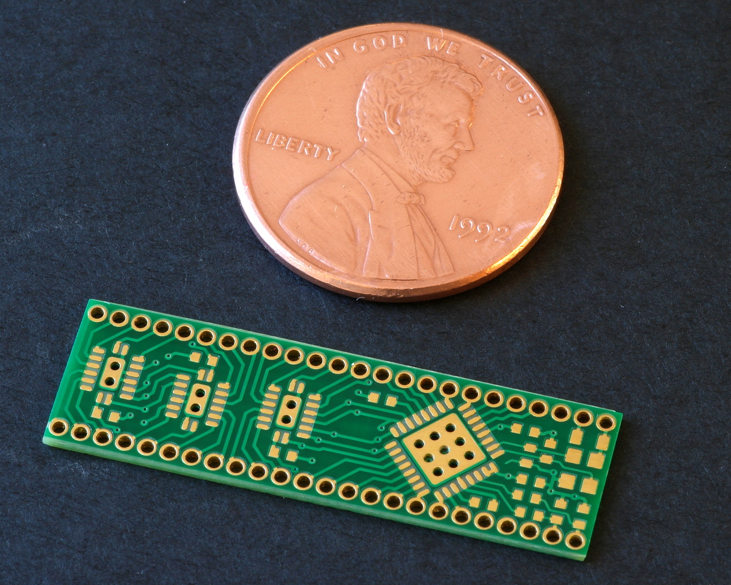

One day I felt the need, the need to go smaller..
I've posted some about it in one of my threads on that other forum. Now that it is finished and tested I think it deserves a thread of its own. It's a bit smaller than the Teensy. It needs an external USB port and reset button.

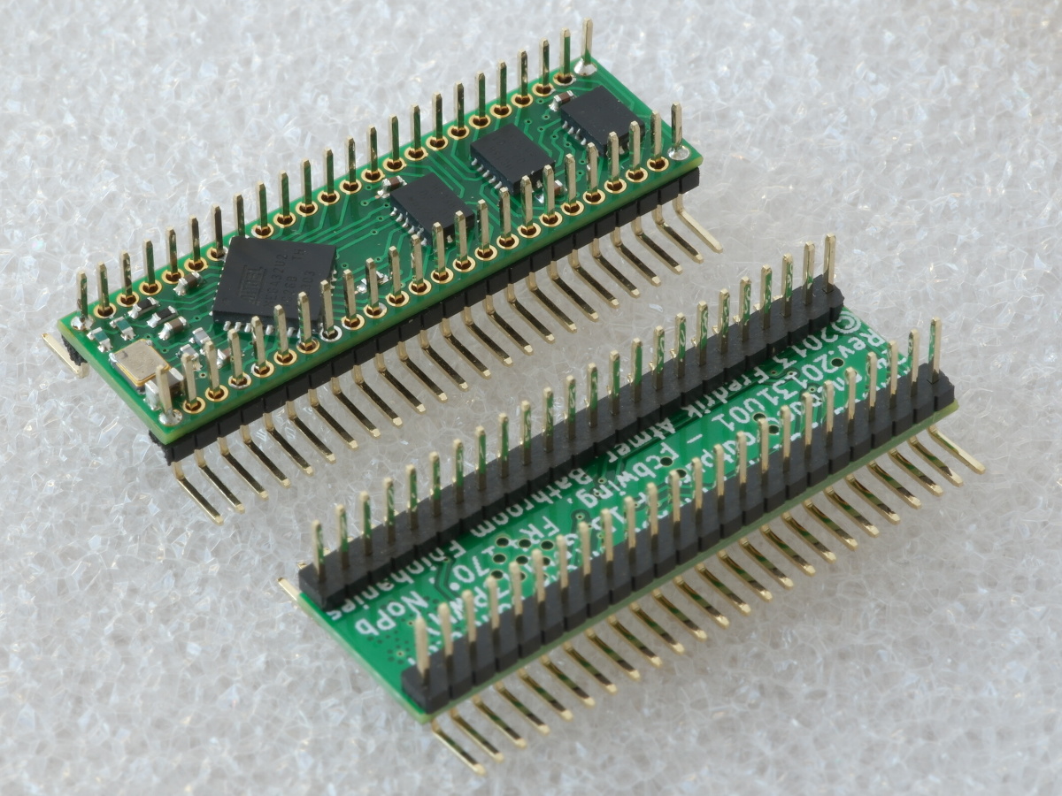

With right angle header pins it turns into an SMT device. The leads could be clipped a bit to make it narrower, and the legs turned inwards to make it look like a J-lead package.

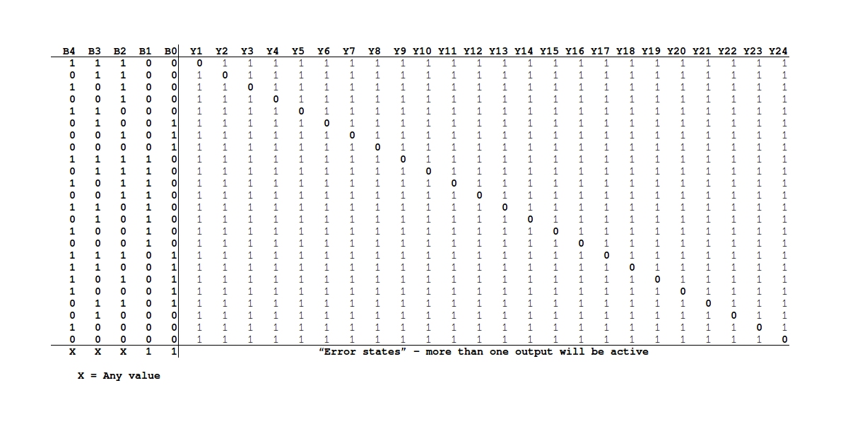

It has an ATmega32u2 microprocessor and three HC138 decoders giving a total of 24 mutually exclusively selectable outputs (active low [or high with HC238]) plus 15 general purpose IO pins (3 of them with PWM). The rows are spaced by 0.300", and the pitch is 0.050". The only required additional components are the USB connector and some type of reset switch.

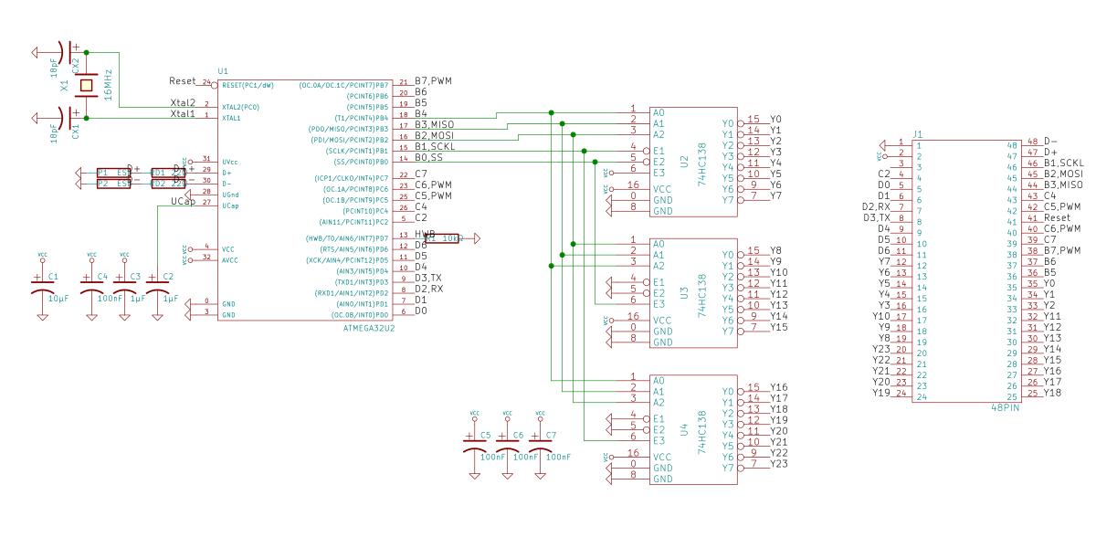

The schematic for those interested. KiCAD schematic symbol and PCB module are attached in the zip file.

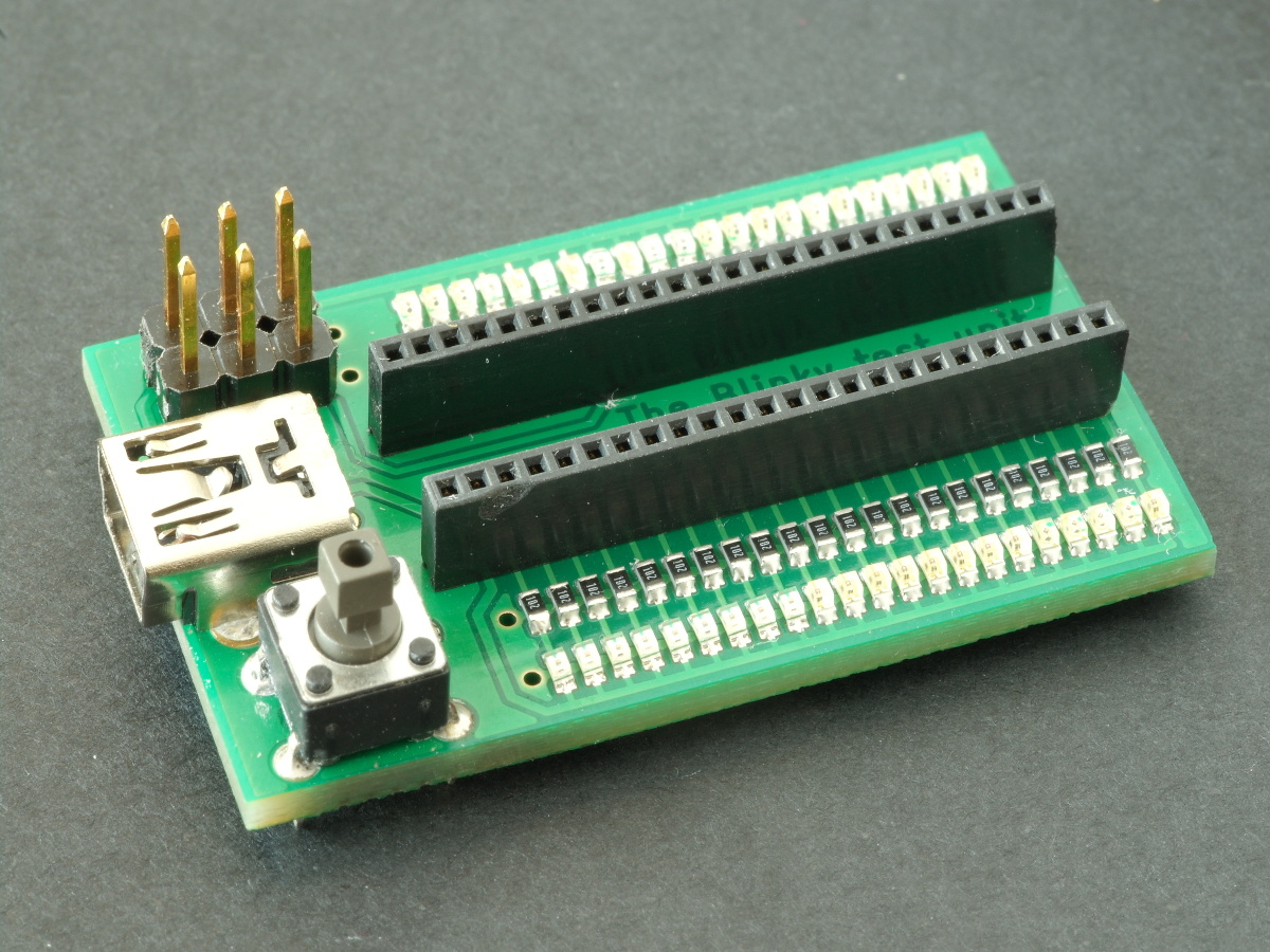

I also built a test/programming board for it (since there are no applications to test it in, yet). Sorry about the poor light in the blinky video.
Assembled I think it could be very useful in DIY keyboard projects. I was able to build a couple by hand soldering. That was far from smooth, and for people in general to do it would be too much to ask for. With a solder paste stencil, hot air or an oven I manage to get it almost right every time.. They usually need some touching up afterwards. The components are just so tiny and finely pitched. A good professional manufacturing line should of course have little trouble producing them.

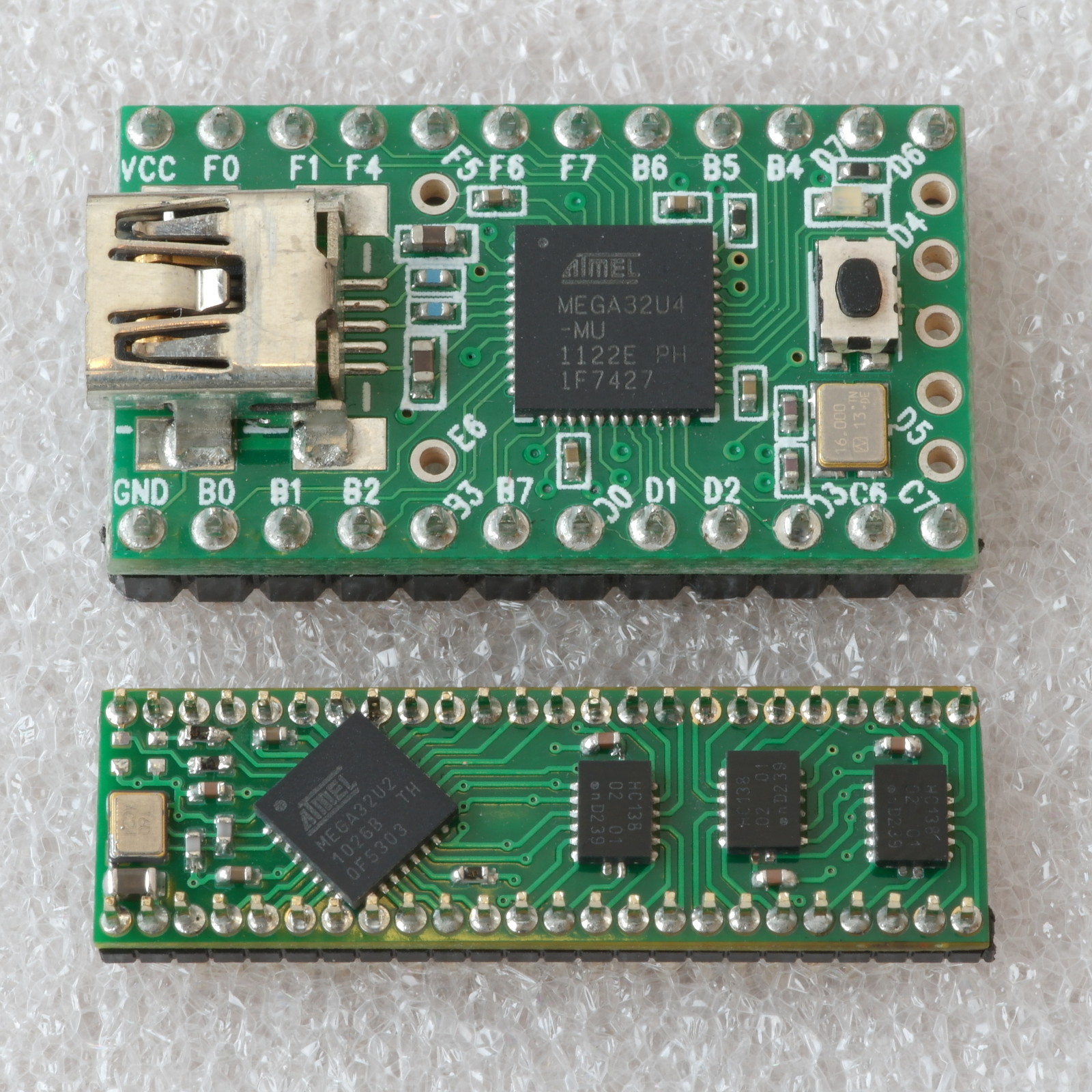

Looking good. I am impressed by your soldering skills, as this does not look like a walk in the park. Did you use your toaster oven you made?
I like you have done away with the onboard USB port, it really made the Teensy bulky (if you could say that), makes me think a board like this, but maybe a bit easier to solder, would be better for suited for keyboard projects.
06 Dec 2013, 16:16
Hmm.. Pretty hardcoded for use as a keyboard controller, Up to 24 strobing pins and 15 sending pins.
Hmm.. The ATmega32u2 has the same clock as the atmega32u4 in the Teensy 2.0, but it has less than half the SRAM (1K vs 2.5K) and no multiply-instructions. Also a somewhat less capable USB interface, but probably more than enough for a USB keyboard.

Thanks all of you =) It did take some messing around to solder them with an iron.. I successfully made two that way. They are meant to be oven baked though, and come pre-assembled. It's small enough to solder the 0.050" pitch headers...
I haven't baked any in the oven yet. I hadn't built it by then. The test board on the other hand was made in the oven. I was a bit worried about the LEDs, but they took it without trouble. Very convenient for the 176 solder points!
I didn't know about it missing a multiply instruction. Are you saying multiplication is implemented in software? avr-gcc seems to take care of it, so no need for writing your own multiplication routines at least..
I added KiCAD modules and more schematic stuff to the first post.
