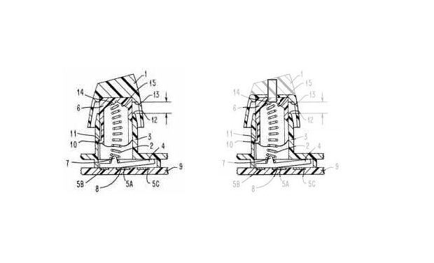

I know that the spring is inside the "skirt" of the keystem, but looking at one of my keystem I noticed that there was quite some vertical room before the spring.
Couldn't you make a keystem for a Model M looking like this, on which you'd then plug Cherry MX switches without having too big of a gap?
How "tall" does the part of the stem receiving the MX switch need to be?

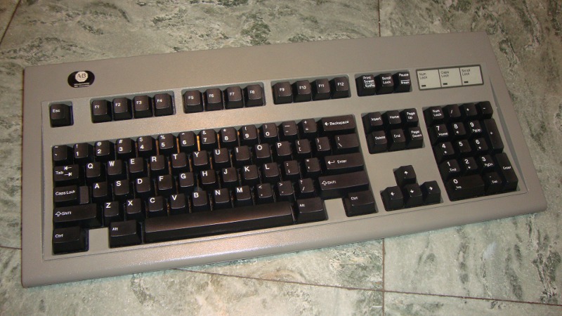

I ask because I'd love to replace the black M13 keys on my industrial M with real double-shots keys :lol:
(I'd probably buy 5 full sets of keystems on which I could plug MX caps and maybe more...)

But then I've read that due to the spring it's problematic. Now the idea would be to model a complete keystem (without the keycap) that would replace the original keystem. Its flat surface would be lower than on a real Model M keystem (because despite the spring I'm pretty sure there's some room in there, as seen on the drawing from the patent) and there would be a cylinder with the MX fixation.
The question is: would it work? And also: who can build something close enough to the original keystem so that it would work flawlessly? (I take it a 3D printer ain't gonna be precise enough and even shapeways I'm not sure but maybe it could be enough to at least see if the idea could work or not)

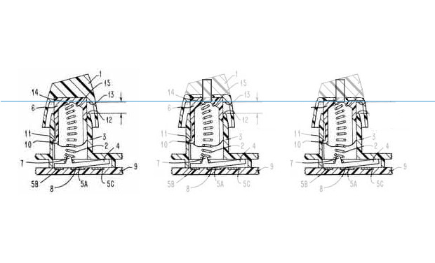

It could be lowered even more than what I showed in the first picture. And that would be without going higher than the original one piece keystem. Now I know that MX keycaps are "taller" then the keycap from the Model M (where it's just "flat surface on flat surface) but still: maybe that would already be more than enough.
Which is why I'm asking how much would be needed vertically to hold a MX keycap.

The inner stems on MX keycaps are usually much longer, and they need to be because they "dive" down into the switch case when the key is pressed (sorry for my bad English).
The vertical distance between the lower end of the keycap stem and the plane of the cap bottom is less than 0.5 mm on the MX keycaps I've seen.
09 Dec 2013, 09:46
They do indeed dive right into the MX switch body. Unmodified MX caps are always going to be extra tall on IBM because their stems occupy part of the same space where the buckling spring lives.

Halvar wrote:The inner stems on MX keycaps are usually much longer, and they need to be because they "dive" down into the switch case when the key is pressed…
Actually they do not need to. If you shorten both the "cross" part of the switch and the stem of the keycap, the result is to lower the position of the keycap without any negative impact on activation as long as the remaining length of the cross/stem part is about 2mm (=required activation travel of MX switch). This length could be even less on the proposed adapter since the buckling spring activation system remains unchanged.
So the "new" adapter could have a shorter cross stem than MX switches, but of course it would probably still be necessary to shorten the inner stems of all MX keycaps used on such a board.
However, this wouldn't have to be precision work as long as the inner stem of the cap is i) not longer than the stem of the adapter and ii) long enough to allow the cap to seat on the stem without popping off.
